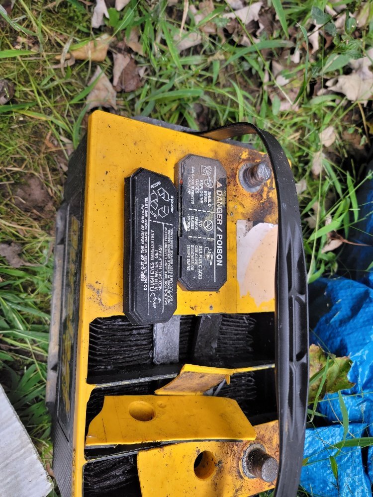

Went to winterize the mothorhome today.   Drain the water, blow out the lines, put it up on it's jacks and cover it.    Put 4 cans of Seafoam in it and figured I'd run the engine as well as the generator for a bit to let the Seafoam get through the system(s),   Turned the key and it just clicked.   First time I've had an issue with the battery.   Oh well....battery was put in in 2012 so I can't complain.
Figured I'd put it on the charger to get enough power to start and run the leveling jacks.    Went to put the charger on and wtf?.....Top of the battery had blown out.
For some reason  I thought it was an AGM battery and never checked the water/acid level like I do for the house batteries.   Engine battery is kind of hard to get to:   Hence the "out of sight out of mind" title.
Got a new battery and went ahead with everything but putting the cover on...getting late...
  Thought y'all might enjoy the pic.

Wow! Who would have thought that could happen? Glad you still have a motor home and not a pile of ashes!
Seen that happen on many occasions. Once even to me when I was a new apprentice hooking up to a set of 4 batteries on a transport truck. Main cause is either the charger cable are put on back wards or the battery is boiling for one reason or another such as getting over heated while trying to start a vehicle or over charging it both of which can cause boiling and the formation of hydrogen gas. The formed  hydrogen gas explodes if for some reason there is a spark, either from a lose arcing connection or during the connecting of live booster cables or live charger cables.
I once got showered in sulfuric acid when a battery blew on a lift truck. Me and another mechanic walked by a lift truck that was over charging so without thinking he just grabbed and yanked off the cable. The resulting spark caused an explosion and we both got showered.  The battery may have gassed when you tried cranking the truck and then the spark from hooking up the charger caused the explosion.
This is why you always connect you + cable to the battery 1st  and then your - cable to a good ground point on the vehicle someplace away from the battery.
I have seen garages burn down because a battery on a work bench hooked up to a charger boiled over filling the garage with hydrogen gas which was set off by a spark.

19 hours ago, uncledj said:
Didn't see any evidence of any nastiness.   I don't think there was enough juice left in the battery to get blown out.
Its not a matter of how much juice, its how much vapor that juice no matter how little juice remains, creates. That vapor is explosive and can be set off by the smallest spark or arc. The lower the fluid level in the battery the more likely it is to boil and give of gas.
    Yup,  I get that.   I think what Mcarl was referring to was the potential for battery acid to be blasted around the engine compartment when the gas ignited.   That's what I meant when I said there wasn't enough acid left to get blasted out.
                                     Nuclear Bomb Explosion GIF
Doesn't take a lot to cause lots of corrosion. Takes very little soda to correct and make sure.
Usually a heaping table spoon to a cup of water is the proportion. using this as a guide line mix up a couple quarts or a gallon and soak down everything. Let it sit a while to neutralize the acid but rinse before it fully dries.
