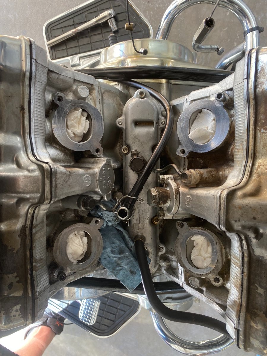

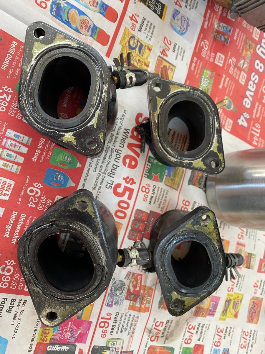

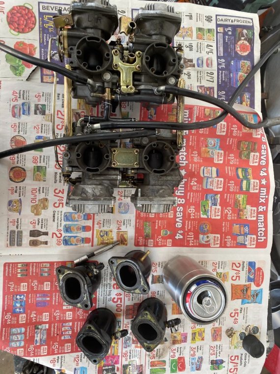

Thanks all for the advice and to @saddlebum and @RDawson for pushing me to remove the carbs.  Honestly only took about 20min to get the carb bank out including the learning curve, not difficult at all like I’ve read about.
one boot had a half gasket and I’m pretty sure none of the gaskets are correct.  Got the OEM on order from my dealer coming in next week.
got all but one e-clip installed in place of the alligator clips.
new slides and diaphragm should be here midweek too.
might get lucky to have it back together for next weekend ride.
