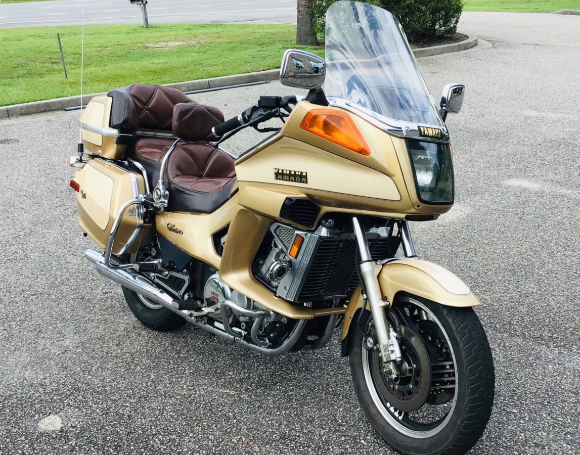

Greetings I'm Matt live on the east coast work the entire lower 48 found a bike i couldnt pass on due to condition an mileage hopefully i can pick some of your brains for knowledge on thes giant Yamamonsters
just picked up a 84 venture royale only 9,000 miles the bike is a 8.5 out of 10 garage queen just a blemish here or there ....so i ride it home today and stop look down an there is fluid on the bottom of the left front fork its not  the fork  seals it looks like the anti dive system ?
being an 84 i am sure there is lots of things waiting to give me a fit ...I will apologize ahead of time for my tons of questions as i am sure there will be many . I also i am notorious for run on sentences sorry .  .....
things I am curious about
1 swapping the forks out for an updated version and also replacing the rear shock possibly dropping the air ride system
2 what kinds of exhaust will fit the Venture
3 solutions for the heat on your legs ( holy moly i got cooked )
4 adding lights fog , marker , swapping radio , losing the air ride
5 curios about the single carb swap maybe try a webber 40mm
and I am sure tons more ...pic is of my bike today when i bought it

I’ll start with #3&5. If your cooling system is working correctly check the vents in the lower fairings, they control airflow into the cockpit area. I never had leg heat issues on my 1st gen.
I haven’t seen much luck with a single carb swap in the posts I’ve read, get the carbs right and keep em clean and that thing is a rocket.
I’m sure some of the 1st gen gurus will be around soon to give better info, I’ve moved to a 2nd gen as I like feet forward bikes.
Welcome to the site, you won’t find better info anywhere to keep her going, best $12 investment you’ll spend on the bike.
I suggest you ask over in the Watering Hole or 1st gen sections to get better response.

  1. Unless the forks are damaged there is no need to replace them. Replace the stock springs with progressive springs and @skydoc_17here on the site sells a kit which eliminates the anti-dive valves. Once properly installed using the spacers cut to the proper length to accommodate your ride and handling preference you can eliminate the air suspension from the front forks or cut the spacers a little shorter and keep the air ride  to fine tune your ride preference.
  2. Check the tech sections for first gens here on the website you will find many tried and true suggestions for the exhaust system.
  3. Generally the only reason you would feel heat on your legs is the vents in the side fairings are open or have been removed. I have removed mine so it is quite normal for me to feel heat heat on my legs but not to the point of being unbearable and almost never on the highway. I mostly notice it riding around town and in shorts it does get hot but this is all normal. Keep in mind air passing through the rad eliminates heat from the coolant by absorbing that heat. That now heated air passes by your legs. Opening the long narrow vents in front of your shins will help some as the cooler air from the vents will blend with the warmer air from the rad reducing the heat factor slightly and I do mean slightly as not a lot of air comes through most of these vents. If its a cool morning open the vents in in the side fairings if they are still there to keep your legs a bit warmer.
  4. First step would be to eliminate the factory fuse box and its glass fusses you can by aftermarket replacements that use the ATO or similar push in fuses. get one with extra fuse locations to wire additional acc. to, this way you can reduce the amount of wiring eliminating having a birds nest everywhere. Here is an example https://www.amazon.com/6-Way-Mini-Blade-Block-Negative/dp/B0837NHY2W
  5. My advice forget it! As stated earlier I have not heard of any one having any success with the single carbs. The OEM carb is for the most part a very reliable and optimum functioning carb. True they are a PITA to work on if they do need a major overhaul which is rare for the most part. If properly maintained the most you generally need to do is a carb sync which in most cases a nearby member in possession of a sync tool is usually more than happy to help out (that is the way of this group) Maybe occasionally a diaphragm may need to be replaced which is a 10 minute job. Last time I replaced mine and rebuilt my carb 70,000 miles ago and it is still going strong.
