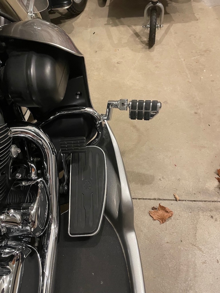

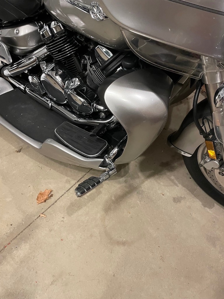

steamer Posted September 2, 2022 Share #3 Posted September 2, 2022 I know Im a year late, but if you look under the drivers floor board you will find an ajusting bolt. You can adjust the Hannigan boards down just enough to allow room on the crash bars to mount a set of kuryakin off sets. 1 Link to comment Share on other sites More sharing options...
Freebird Posted October 23, 2022 Share #4 Posted October 23, 2022 I have the KuryAkyn offsets on mine and they work fine. I have long legs and love the extended room that they offer. They were on it when I bought it and I haven't adjusted them to my preference yet but they work pretty good the way that they are. I will rotate them forward a bit more. Link to comment Share on other sites More sharing options...
