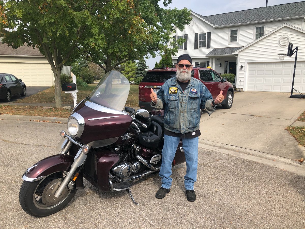

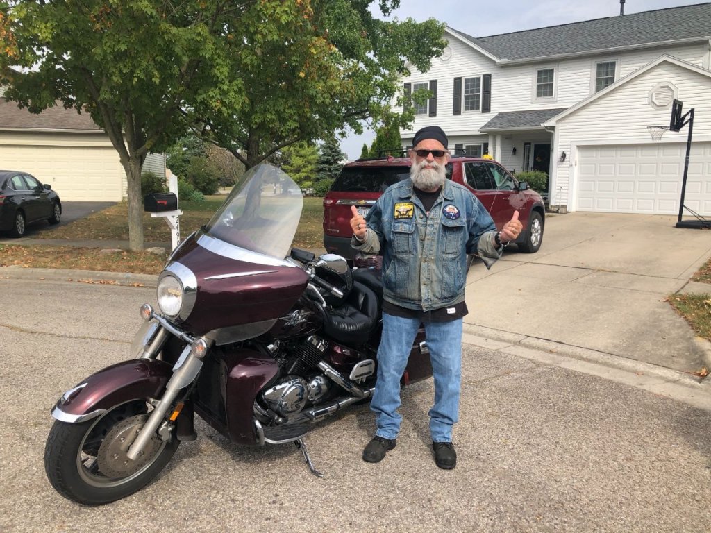

druuu Posted September 23, 2021 Author Share #5 Posted September 23, 2021 thanks for all the suggestions and help from the forum, the bike is just about ready for me to pick up next week with new tires, brakes, battery, carbs cleaned and synced, fluids replaced and tested out by the awesome shop I found- Ryan at the shop is going to have his first baby just before I get there to pick up my new baby- then it's off to Bloomington IN for first night with some friends, on to Sioux City IA, Sturgis SD, Missoula MT, Spokane WA and Seattle- going to try and get off the interstate where I can, maybe in the Cheyenne or Bighorn, maybe Lolo if the weather is good and I have enough time- will post some pics from the road, here's Frank and his bike last time I rode with him a few years back 2 Link to comment Share on other sites More sharing options...
