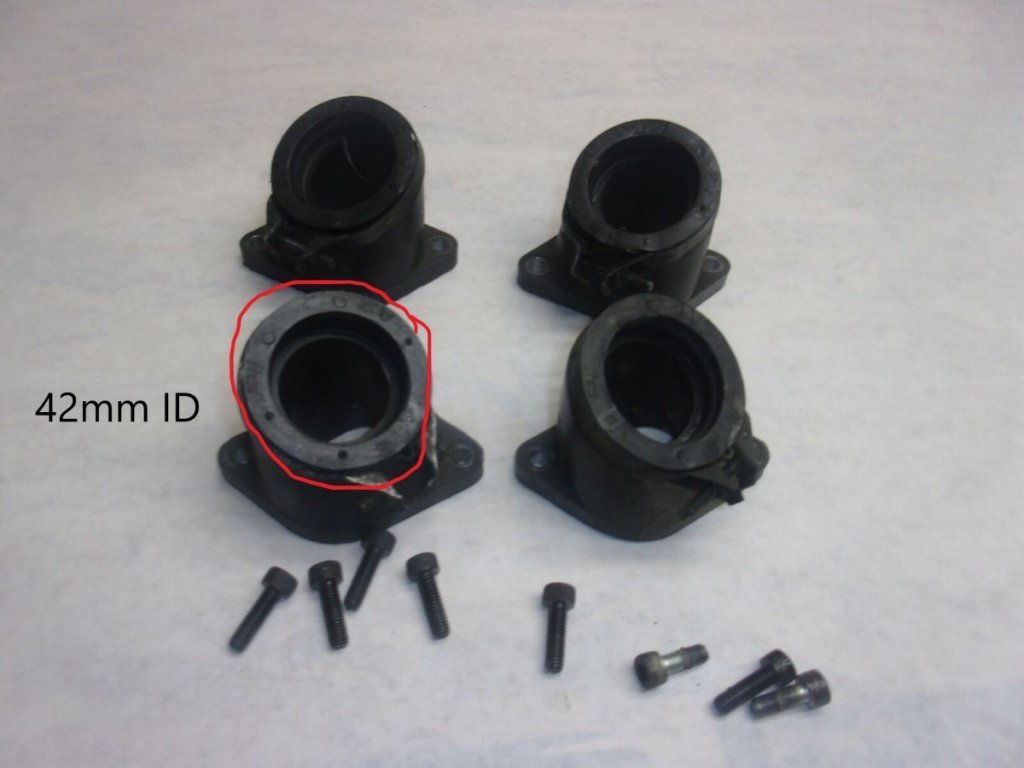

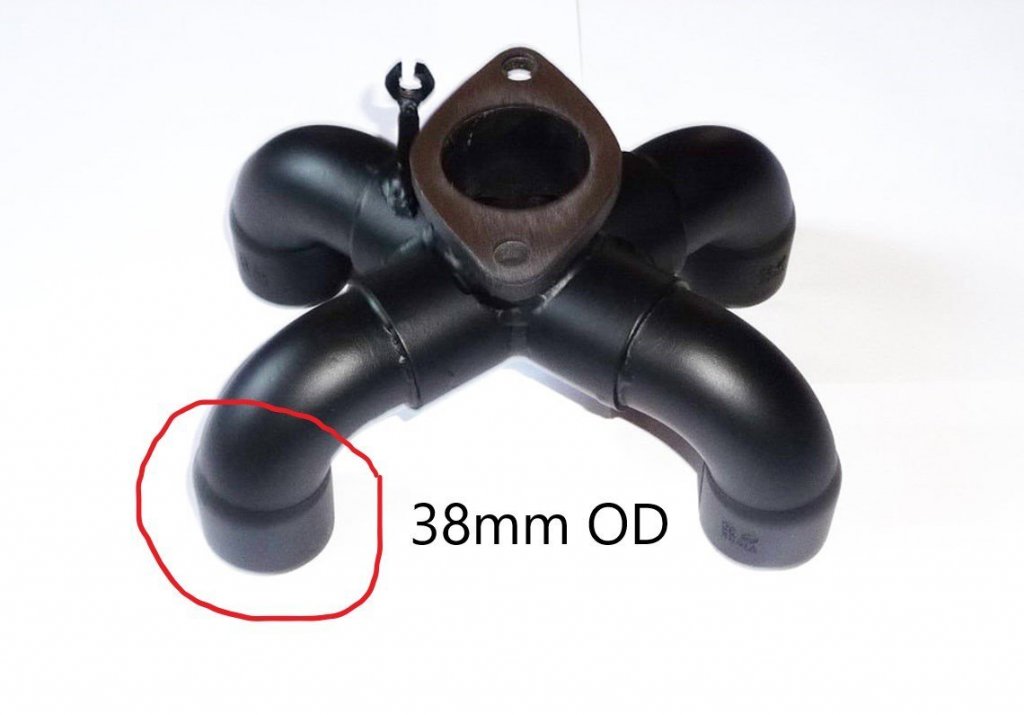

Ddiggerr Posted August 5, 2021 Share #1 Posted August 5, 2021 Just curious what everyone who has done the conversion, has done to eliminate the difference in size as pictures show? Cannot come up with anything to fill the gap and just looking for some ideas. Thanks Link to comment Share on other sites More sharing options...
luvmy40 Posted August 6, 2021 Share #2 Posted August 6, 2021 I haven't done one of theses but, a couple 2mm x 38mm o-rings would work. If there is an o-ring that would take the heat. These might work: https://www.theoringstore.com/store/index.php?main_page=product_info&products_id=1908 https://www.theoringstore.com/pdfs/ss-b70-metric.pdf These would be better: https://www.amazon.com/uxcell-Silicone-Ring-Sealing-Gasket/dp/B008MKY8TY Link to comment Share on other sites More sharing options...

Pasta Burner Posted May 7, 2022 Share #4 Posted May 7, 2022 @Ddiggerr It wouldn’t be useful for an on again off again situation but I’d set it in place and use some RTV to seal the gap. Link to comment Share on other sites More sharing options...
