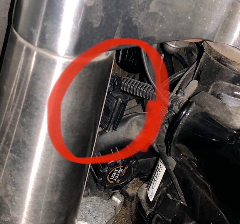

Opened up the fairing this weekend to install an LED headlight bulb and fix my passing lamps. The fuse for my passing lamps looked good, but the fuse holder wasn’t closing tight enough to make good contact, so I wired in a new blade type fuse holder that I had in the tool box and while I was at it I added a few extra inches of wire so I could run the fuse to the rear opening of the fairing by the triple trees. Now if the fuse blows I don’t have to split the fairing to replace it.CB02F456-72B6-45D0-83E4-9973CB2CC758.thumb.jpeg.e9e50b3038d1d7ef9a9a3418e87f66e2.jpeg
