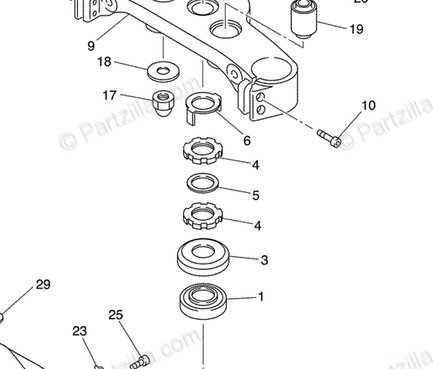

Thanks guys!  @saddlebum Looking at the attached exploded view, the adjusting nut and lock nut are locked together with #6.  I think the only way to adjust them separately is take the top part of the triple tree off & remove that part.  Once in that far, it probably makes sense to go all the way.  In reading my Clymer manual this morning, it says the fairing has to come off to replace the bearings.  Seems to make sense if its attached to the triple tree.  Will save that project for a rainy day.
I previously did the bounce test to adjust.  Definitely not perfect and I just made a minor adjustment to tighten it up a bit, maybe rotated the nuts 1/16.   didn't take much.

It seems kind of odd the way that steering shaft is set up, but this is how I did it.
Loosen nut #7. Now with a long punch, screwdriver or something similar tap lower nut #4 to set the torque. Check your progress, it don't need to turn much, a 1/16 " is a good start. When you think its good, tap the upper #4 nut so  that it sets back on the lower one. There is a rubber o-ring in between the 2 nuts, and I haven't figured out the real meaning of having it there, but it's there so some engineer has made his daily wage. Now torque nut #7 back to speck and test again. You might have to go through this circus a few times to get things perfect. Always torque #7 before final decision for the pressure from #7 will move the #4 nuts just enough to cause a noticeable difference. When you are happy, carefully move the handle bars from side to side, just with your finger tips and see if you can feel any jumping, vibration, or such. Slowly and lightly!! If it feels anything else than perfectly smooth, it's time for a change.
