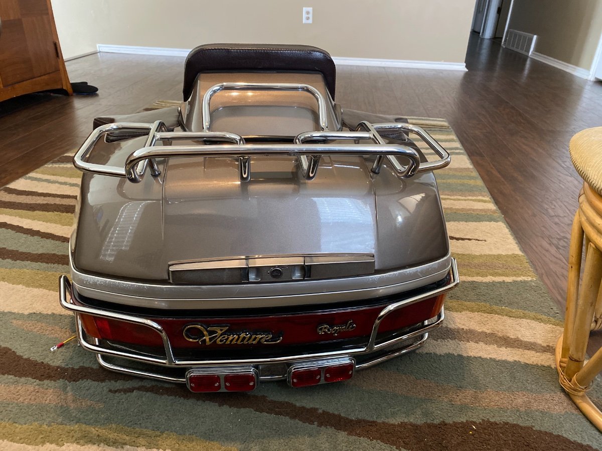

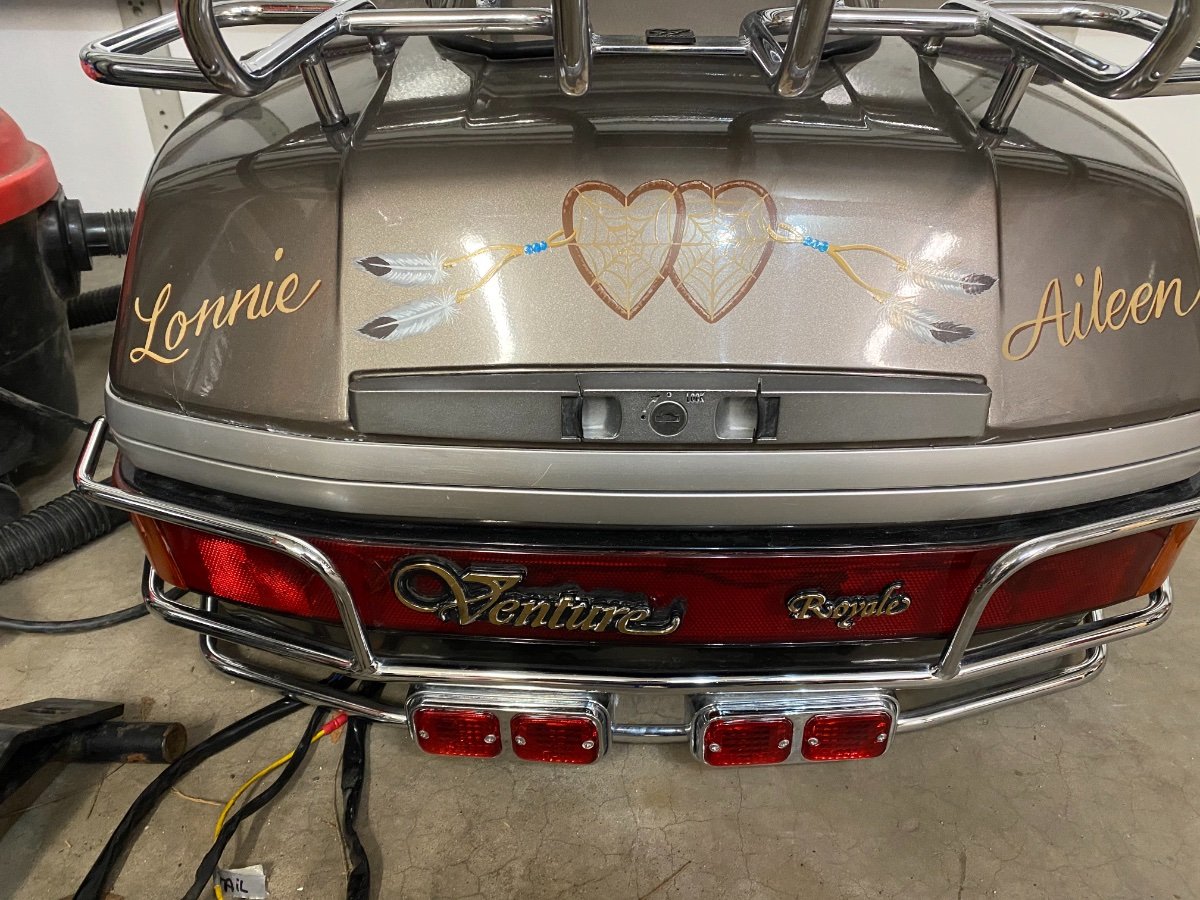

steamer Posted July 29, 2021 Share #1 Posted July 29, 2021 to those members who had pinstripping done while attending rallys and probably had a few beers before making the decision to enhance your paint job. how do you remove it without damaging the paint? Link to comment Share on other sites More sharing options...

saddlebum Posted July 29, 2021 Share #5 Posted July 29, 2021 (edited) This is true, we use easy off oven cleaner to remove pin stripping and painted lettering from all the used trucks we take in as trade in's. You do run into the odd stubborn one but most pin stripping is done with lettering paint. The paint used by he who I cannot remember his name, is such a paint and should come off easily. Once you remove the lettering, wash with soap and rinse well. When dry you can buff the paint with a very mild abrasive liquid polishing compound and than polish with a good wax. if your lucky and there is absolutely no shadow left, you may be able to go straight to the wax. Edited July 29, 2021 by saddlebum Link to comment Share on other sites More sharing options...

XV1100SE Posted July 29, 2021 Share #8 Posted July 29, 2021 I used oven cleaner to "erase" my ex-wife's name off the back of my trunk. Spray it on, wait a minute or two....then wipe it off. The pinstripe paint comes off clean with no damage to the plastic or the paint/finish. I've also used oven cleaner to remove permanent marker off a painted wall. Link to comment Share on other sites More sharing options...
