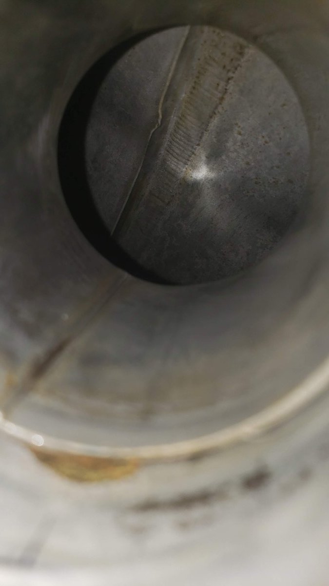

TTrax Posted October 28, 2021 Author Share #51 Posted October 28, 2021 On 10/25/2021 at 9:54 PM, cimmer said: When you say the smaller of the two holes, are you aware there are 3 holes between the engine and the throttle blade. The smallest of the holes is the idle Pilot outlet hole for the idle circuit. This hole is passing a fuel/air mixture and if the black stuff is coming out of there, it could be a bad o-ring that is used in the pilot screw set. The other 2 holes appear to be air holes for vacuum the coasting enrichment valve assemble and piston valve/diaphragms. You might have to remove the pilot screw and see what shape the o-rings are in. Be aware there is a spring, washer and o-ring in there and they can be hard to remove. You might need to stick a small stiff wire in there to work them all out and there are replacements available for a number of sources. Hope this helps. Rick F. You are right, I missed the third hole until I shot some carb cleaner in the mating hole that the pilot jet lines up with from the jet block. I went ahead and sent the carbs out to Mike Eykamp in hopes that he will find out what I have been missing. Since I haven't been performing a true carb tear down and rebuild then the issue is probably with my halfassed attemps at focusing on the fuel part of the carb only. I did take out the fuel sender and looked into the tank, doesn't look too bad for a +30 year old bike in my opinion. Nothing I can see that would explain the carb getting gummed up after several hundred miles. I plan on replacing the fuel lines and pump again just to be sure. Link to comment Share on other sites More sharing options...

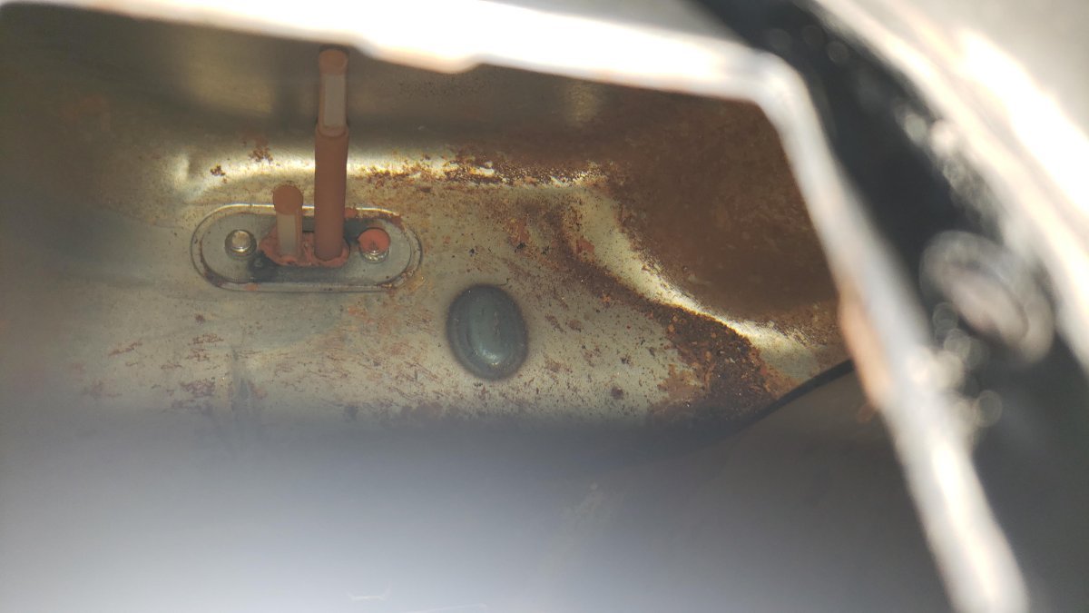

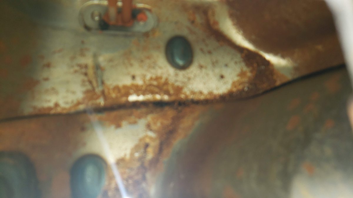

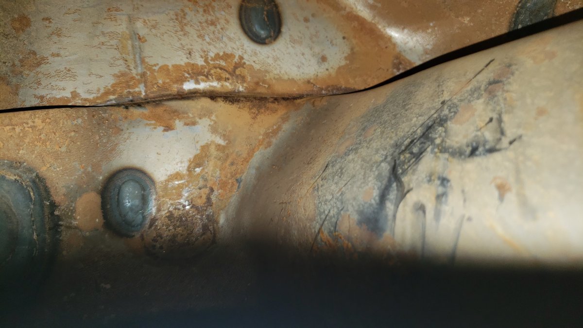

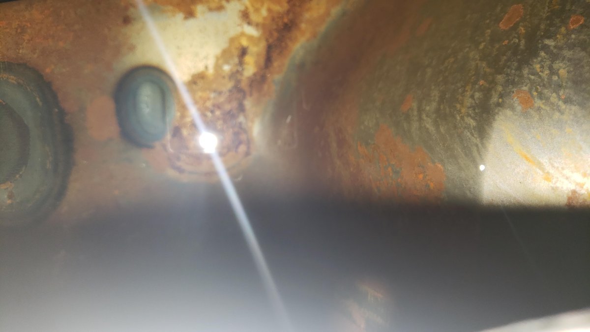

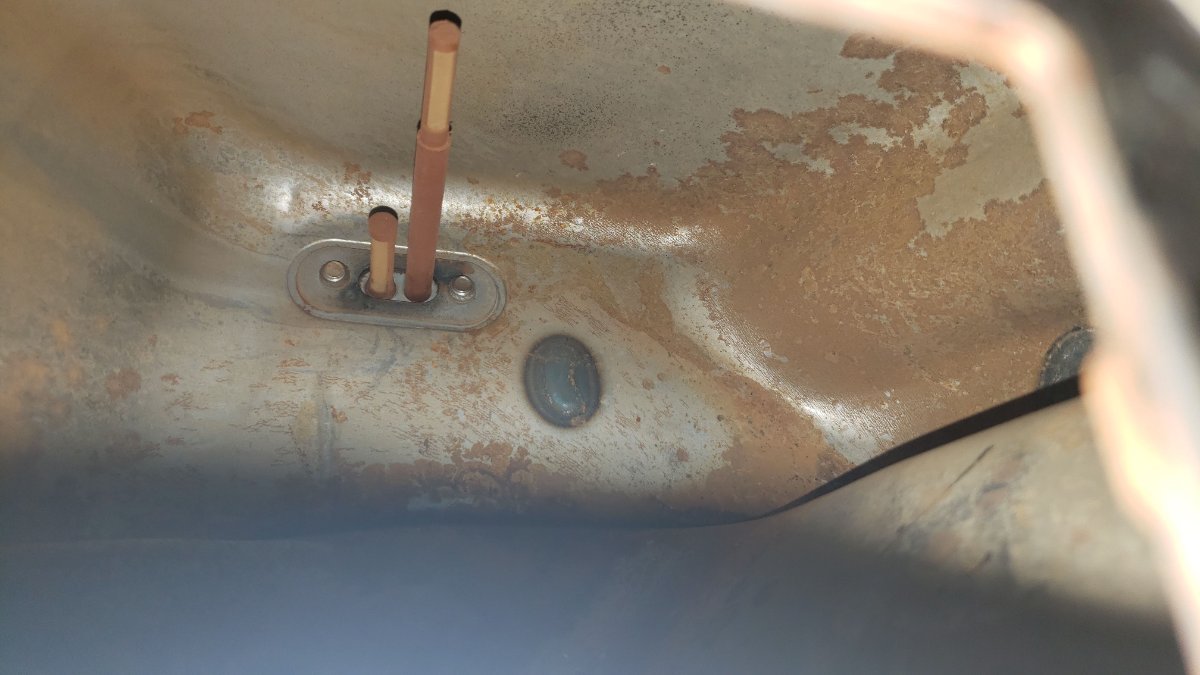

Marcarl Posted October 29, 2021 Share #52 Posted October 29, 2021 If that is the inside of the tank, I would be suggesting something maybe. 1 Link to comment Share on other sites More sharing options...
videoarizona Posted November 21, 2021 Share #53 Posted November 21, 2021 Agreed. Tank needs to be cleaned and sealed. That rust will flake off... Hopeful be caught be filter. What doesn't get caught will cause carb issues. You have put a lot of effort into the scoot... pleas keep going. Once done, the bike will be a joy for years to come!! 1 Link to comment Share on other sites More sharing options...
TTrax Posted November 23, 2021 Author Share #54 Posted November 23, 2021 On 11/21/2021 at 11:04 AM, videoarizona said: Agreed. Tank needs to be cleaned and sealed. That rust will flake off... Hopeful be caught be filter. What doesn't get caught will cause carb issues. You have put a lot of effort into the scoot... pleas keep going. Once done, the bike will be a joy for years to come!! I have to admit, I have thought about selling this thing know than once over the past couple of months. Hopefully I will be able to get this figured out and fixed this time around. I got my carbs back from Mike and want to make sure everything is okay. I've got a new fuel pump and lines as well as filters. If I'm going to do the tank, does anyone know what's involved to remove it? I had heard you basically have to split the rear frame off but correct me if this is wrong. I hadn't thought about removing the tank and relining it as my 82 Honda is way worse and I haven't been having any similar issues as what I'm having here. Also, my screens in the tank and fuel filters are perfectly clean with no hint of rust discoloration. Did these tanks have any sort of liner applied at the factory? This tank has some rust but I don't see any evidence of a liner ever being there in the first place, unless it has dissolved over the years. I would think there would be flakes of debris other than rust in the tank if that were the case but can't see anything so far. Link to comment Share on other sites More sharing options...
BlueSky Posted November 23, 2021 Share #55 Posted November 23, 2021 The tank on my 85ZN700 is rusty. When I bought it in 2009 with 1k miles on it, I sloshed the gas around and dumped it to get the rust particles out and put a filter in the line and I've never had a problem as far as I know with rust clogging up the carbs. They will clog up easily if it sits for a while but with a 700cc engine with 4 carbs the passages are really tiny and it doesn't take much sludge to plug something. I keep Gumout with PEA in the gas which helps this issue. My 2 cents. 1 Link to comment Share on other sites More sharing options...

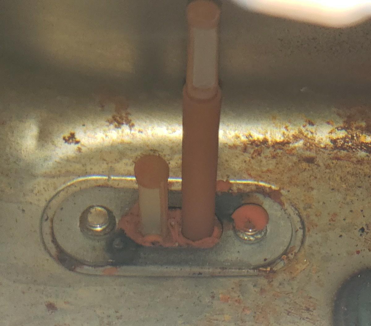

TTrax Posted December 23, 2021 Author Share #61 Posted December 23, 2021 OK just a quick update, still working on this issue. Slowly but surely. I did notice something strange but maybe of no consequence but figured it would be worth noting. The first photo I had shared awhile back. It didn't mention anything about it as it looked to me as if someone had applied a lot of sealant quite sloppily between the petcock and the tank. I didn't think more about it until I had dried out the tank with a heater and blew it our with compressed air. The next picture was after blowing out the tank, and the last was after blowing it out specifically in the area of the petcock. What I thought was orange sealant seems to have been rust but of a bright orange color which I haven't commonly come across. Possibly rust in the presence of water? I'm not sure, also not sure if this was causing my problem or not. Seems like rust would have stained the fuel filters and the fuel bowls of the carbs but I can't say I know for sure. The filters and bowl are clean for the most part. For now there are no loose rust particles in the tank. I have considered removing the tank but not sure how much it would take to get it out. Looks like it would be a lot of work but might be worth it in the long run. I might see if there is anyone local that would perform a rust removal and nickel coat a tank if possible. I have heard horror stories of people using a tank liner and having it flake off and plug up fuel filters, so I am hesitant to do it unless it is absolutely necessary. Link to comment Share on other sites More sharing options...

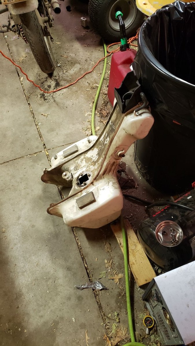

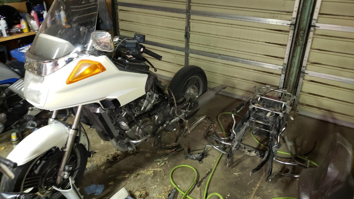

TTrax Posted January 4 Author Share #62 Posted January 4 Just a quick update... decided to go ahead and drag myself out to the garage today and decide how I wanted to proceed. After much looking at the bike and trying to see how much work it was going to take to get the tank out, I started taking it apart in earnest. It wasn't as bad as I thought it was going to be. I took the luggage cases off the bike, took out the air system, and unplugged any wiring harness connectors I needed to so I could get the frame off the back of the bike. I did find the top left frame bolt was missing so that was concerning for sure. Now just to see if I have someone relatively local that cleans out tanks and treats them, or decide if I want to try to do this on my own. Pardon the mess in the garage, I didn't get it properly cleaned out and took these photos before putting up my tools that were strewn about the work area, along with leaves that had blown in yesterday when loading up some stuff. Link to comment Share on other sites More sharing options...
Marcarl Posted January 4 Share #63 Posted January 4 Yep! You got some work ahead of ya. Don't think that you'll be bored in the next while. Hope it works out well and you enjoy doing it. 1 Link to comment Share on other sites More sharing options...
saddlebum Posted January 4 Share #64 Posted January 4 What mess? Looks normal to me 1 1 Link to comment Share on other sites More sharing options...

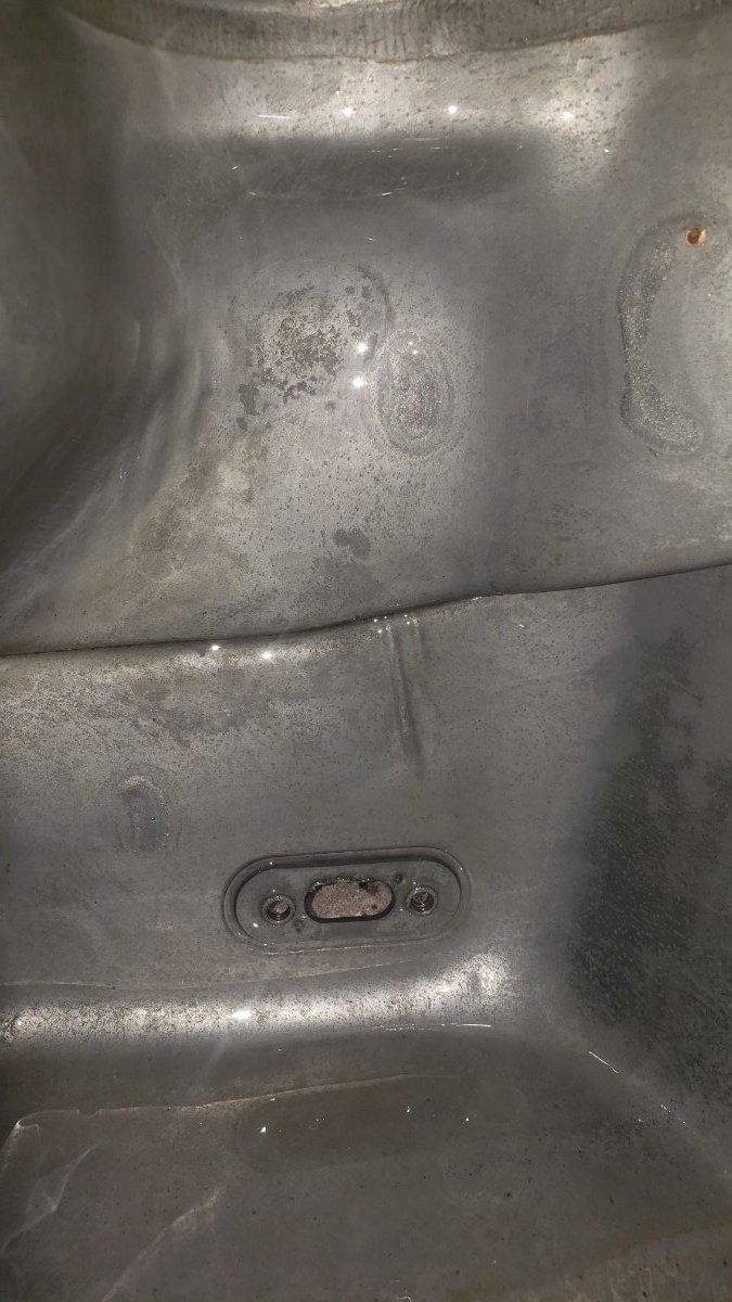

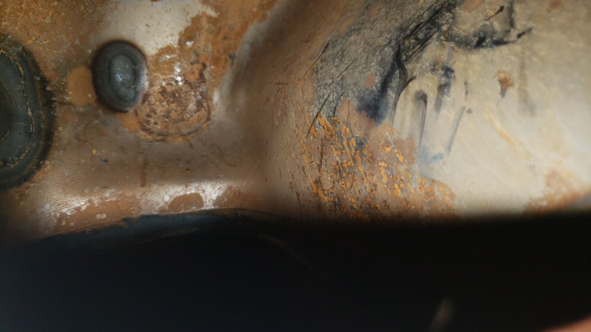

TTrax Posted May 8 Author Share #65 Posted May 8 OK, it's been awhile since I had updated my progress... mostly because there hasn't been much progress. I did finally do some research into cleaning the rust out of the fuel tank. I had bought a tank liner kit (Kreem), but after reading a lot of negative reviews, I decided I would forgo doing it for now. I finally decided to go with muriatic acid. After using a gallon undiluted, I made sure to agitate the tank around off and on for about 2 hours. Afterwards I neutralized and rinsed with water and baking soda. After I got most of the water out of the tank, I poured some alcohol in the tank and drained it too so I could get most all of the water out as possible. That was followed up with a leaf blower in the opening for the fuel sender for about 10 minutes. Finally, I followed up with a good coating of WD-40 and drained the excess out. Hopefully this will last for awhile, now to start getting it put back together again. The weather here is already nice and been driving me nuts listening to everyone driving around on their bikes. At least I still have the trusty old CB750 to ride around on but its just not the same. Hopefully this does the trick, my wife has already said if it doesn't its probably time to get rid of the Venture. I attached some before and after pictures, so far it looks like it did a decent job. Link to comment Share on other sites More sharing options...
Marcarl Posted May 8 Share #66 Posted May 8 Looks clean enough, just make sure you don't get any water in there and fill up each time you fuel. As well as leaving a full tank when it sits. 1 Link to comment Share on other sites More sharing options...
BlueSky Posted May 9 Share #67 Posted May 9 Yeah, the tank looks good after cleaning! Good Job! 1 Link to comment Share on other sites More sharing options...
