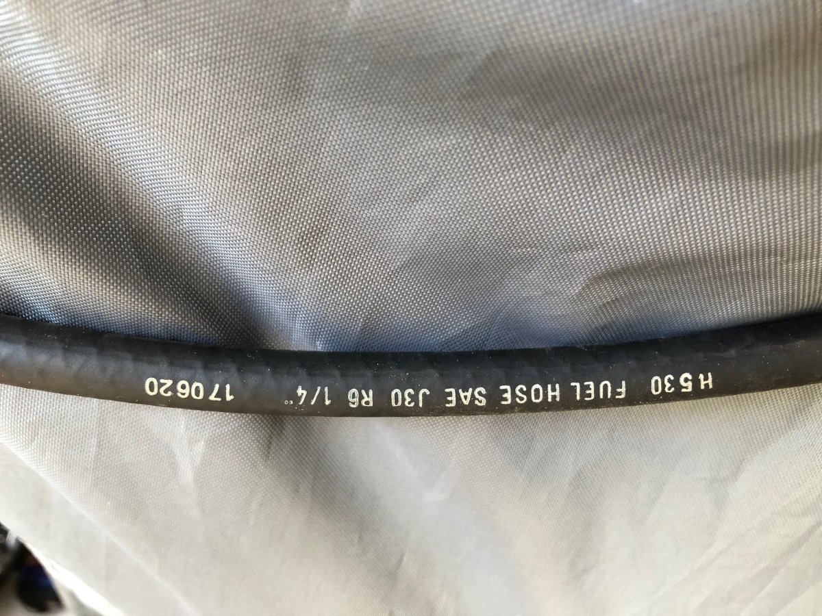

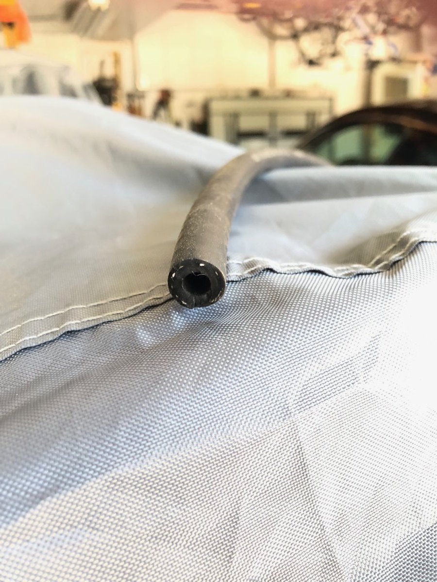

For the bowl drains, I used 1/4" hose.  No way to get your hands up in there.  The hose I used is stiff enough that with a little patience and practice can guide it to the drain port then slip it on with a little gentle pressure & twisting motion.  IIRC, a 5mm allen key opens the drain port.
