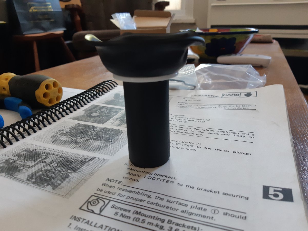

I just got a new set of sliders and when I went to install I can't get the diaphragm to stay in the slotted groove. I can get them in but having only 2 hands I have to take them off to put the cover on and the diaphragm pops off. Any suggestions?

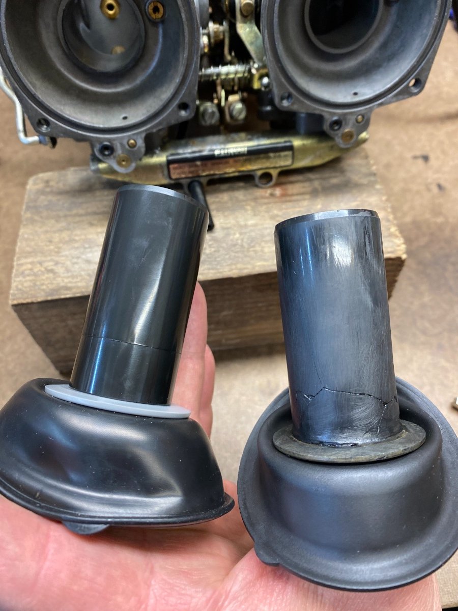

@UthredI suggest you post a picture of the diaphram and the barrel as the OEM one does not have a slotted grove as per say. It uses two white nylon looking rings and a stainless lipped sleeve to hold them in place. The OEM diaphragm sits between the two white rings.
There is an aftermarket diaphragm which eliminates the two white rings by cutting them out and sits in the resulting groove between  the lip of the stainless sleeve and the body of the plastic barrel. These aftermarket diaphragms have a thick bead around the center hole and go on similar to mounting a tubeless tire on a rim.
If you try to use the OEM type diaphram without the white rings it will not stay in place.

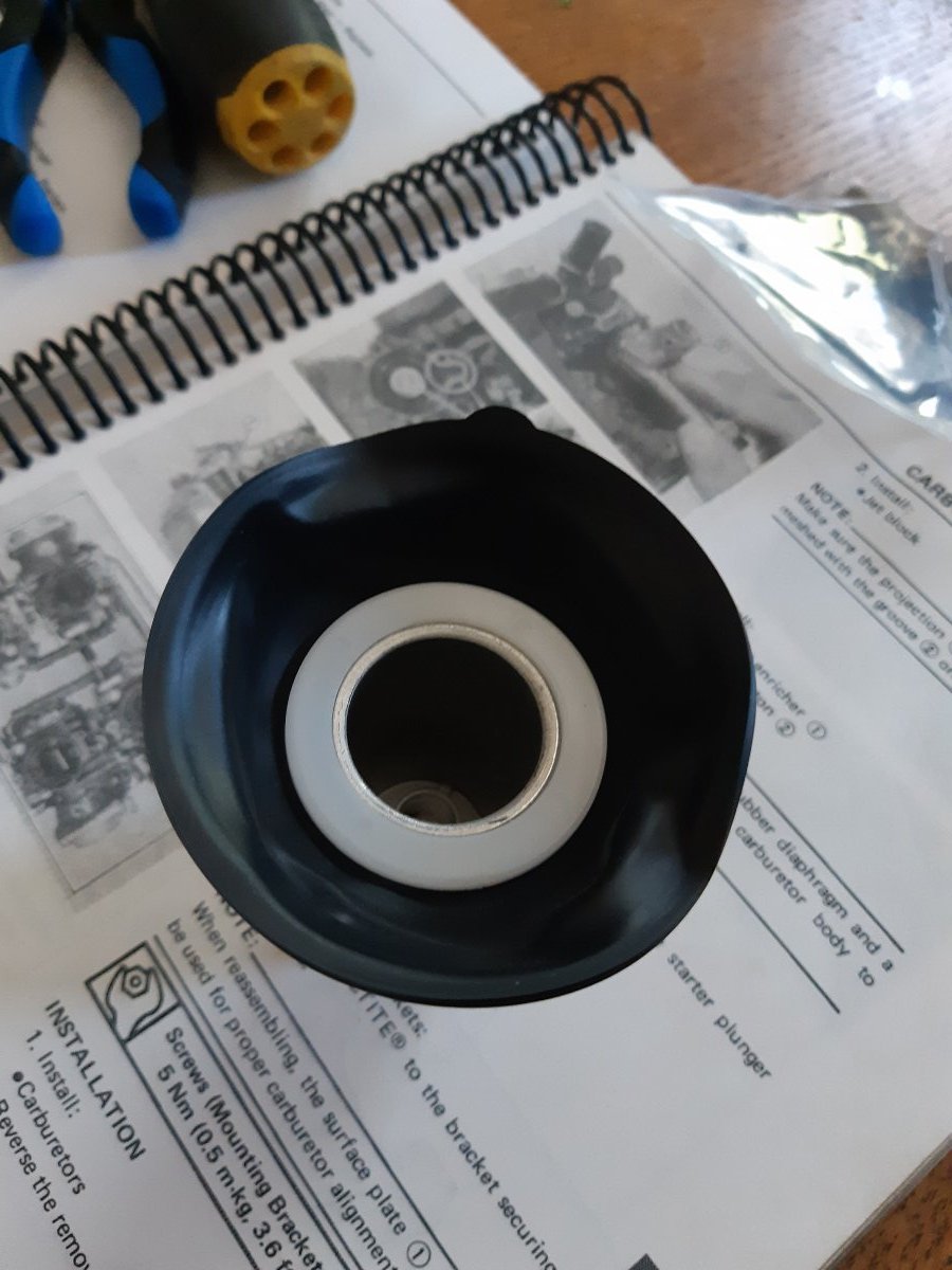

@UthredThat looks OEM. When you install the barrel the tab on the diaphragm should line up with the locating spot on the carb housing and the drain hole in the barrel should be at the six o'clock position. If required rotate the diaphragm on the barrel until alll lines up properly. The spring goes into the barrel  and then the cover goes on. it should not be difficult. If need be get a small can of of PERMATEX HIGH TACK gasket spray (most auto parts sources carry it and is non-hardening and easily removable if needed ) and carefully spray a thin coat in the groove on the housing. Let it get tacky then set the diaphragm in place insert the spring into the barrel and then the cover.
