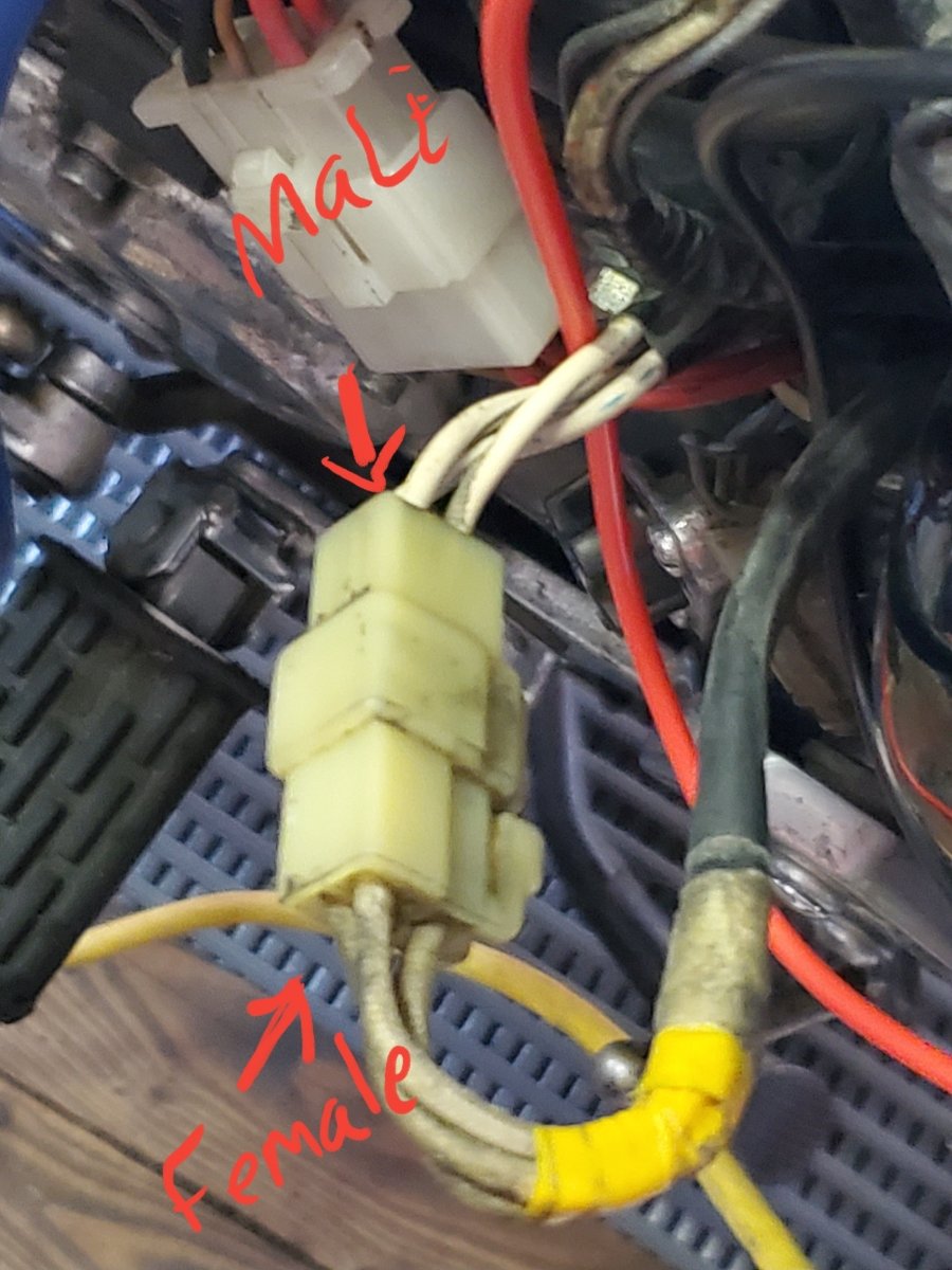

Terry NB Posted June 22, 2021 Author Share #30 Posted June 22, 2021 (edited) 25 minutes ago, Terry NB said: I just measured the 3 white wires from the stator as you mention....on one side (with female end) reads just under 5 ohms when testing all three wires. The other end, I assume is connected the rectifier show resistance to each other as well as all 3 show ground. I did as Puc Puc on youtube I checked all 4 ignition coils and the primary read 4.8 Ohms and the Secondary were 22K ohms. Quote Edited June 22, 2021 by Terry NB Link to comment Share on other sites More sharing options...
Terry NB Posted June 22, 2021 Author Share #31 Posted June 22, 2021 (edited) On 6/19/2021 at 8:31 PM, Patch said: Assuming the coils check out then and because there is one bank or side not firing, check the "pickup coils" for resistance page 7-39 or 7-36 describing the connector and the sets you measure. Pickup coils are to specs all @ 114 ohms Edited June 22, 2021 by Terry NB Link to comment Share on other sites More sharing options...
