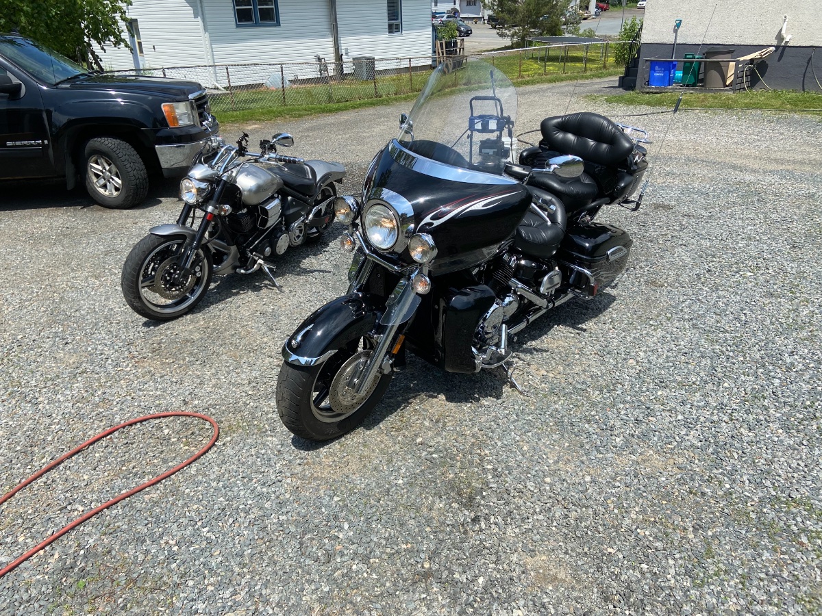

I replaced it with the tallest, widest one I could find, with a vent in the middle.  When I want air in my face, I open the vent.  When I don't, I close the vent.  I have been very pleased with it, it eliminated the buffeting, even for the passenger.

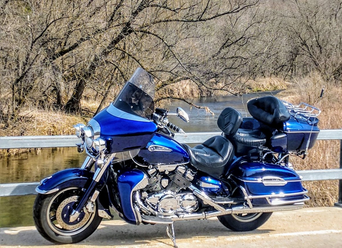

I like the Bagger Shield, You have two to chose from with one wind shield and only takes a couple of minutes to go from short to tall. And they seem to hold up well.1104179382_IMG_20190406_152159061_HDR5.thumb.jpg.439f2831907cc4ff5120c5686d2c25b9.jpg

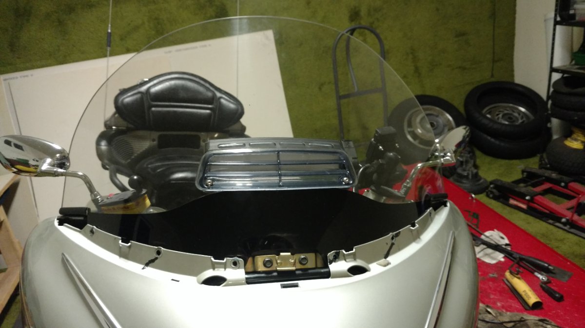

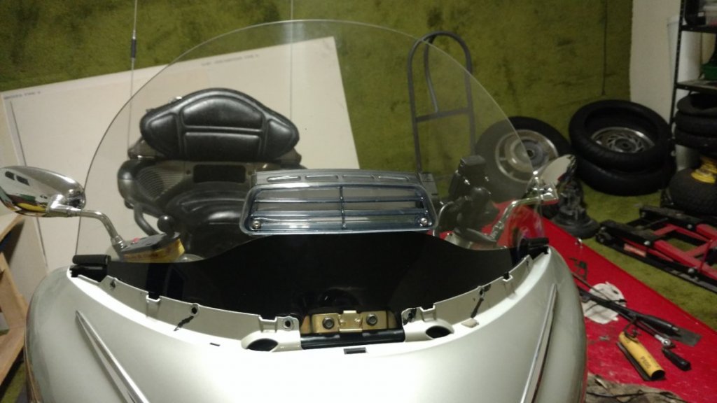

When I purchased my '99 it had the same "super sized" windshield on it and I hated looking through it.  I purchased an inexpensive e-Bay 10" shield that was just below my nose (I'm 6'2) and HATED that thing.... Yes I could see over it but the wind management was horrible and I couldn't ride more than an hour without getting a headache.  If I had to wear a full-face helmet it would shake me so bad I couldn't go above 45mph.  I ended up getting a 19" clearview (they measure the height different) and it's just above my nose but I can easily see over it.  The shield has a recurve to it so the top rolls up steeper than the rest of the shield and pushes the wind up and over your head, I also have the vent which eliminates the low pressure behind the fairing and smooths out the airflow.
I don't have any good photos, but here's one during installation.
