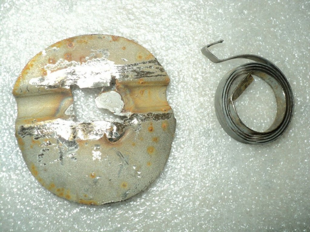

Look what I found and who remembers Mopar’s stupidly late 60’s early 70’s ? How many blocks & heads did this trap burn hmm hmm
Anyone change a catalytic converter and not asked why it went prematurely? #1 cause after theft that is is fuel injectors leaking 2nd is burning oil. If we run a melted cat we fry that side of the engine, yet, most won’t check the fuel system for leaks because it is too expensive, weird or what?
