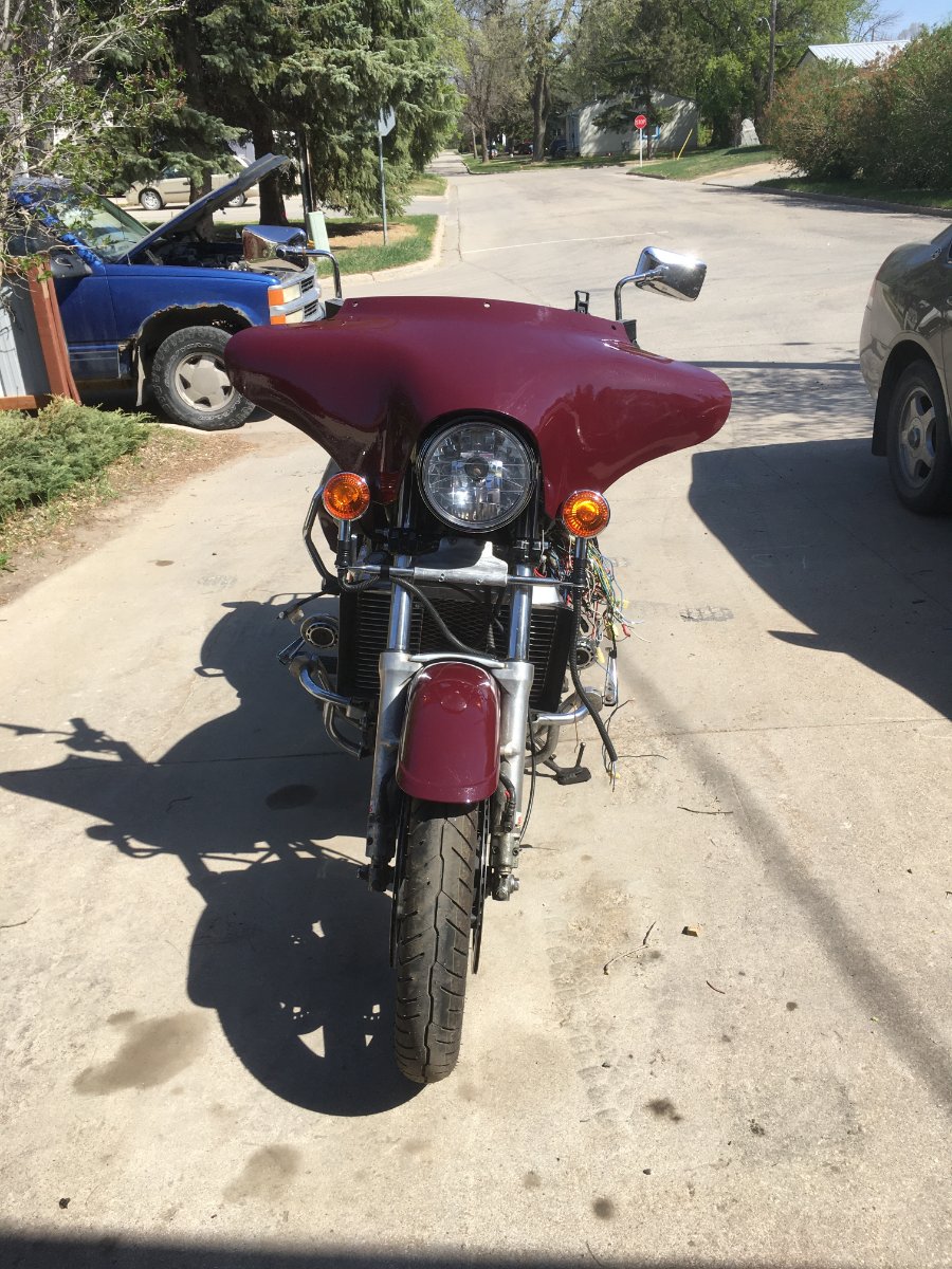

I have removed 65 lbs from the 83 , and the balance / lean weight is much better ...When standing beside the bike .I can grab the handle bars with one hand and pull the bike 14 inches past center and push it back with one hand on the handle bars easily . ..I will be replace the one battery with 2 smaller ones at the rear of the bike in aluminum battery boxes down in front of the saddle bags .Most of the remaining weight is below the level of the seat .. I have lowered the bike 1 1/2 inches

3 minutes ago, saddlebum said:
Looks good from the front but whats with all the wires hanging off the side. You plan on going trolling
I was waiting for a small speedometer thinking I might move the monitor unit in at the handle bars near the key , I have moved the relays near that location . I have rad over flow on the other side , am trying mount it so that I could make a right and left cover to have the appearance of  fuel tank and make a removable lid to access the over flow ...I find these kind of conversions are never as easy as the planning is

Next on the list is to hookup and mount computer monitor , there some features that will be handy .. I also need to make a small dash panel for the signal lights, neutral , high beam  and temp gauge .. I plan on painting the remainder of the bike  ... My ground clearance under center shock is 5 inches at 15 lbs and 6 1/12 inches at 22 lbs air pressure  I have had the bike apart bolt by bolt from front to back ..It has been a 10 month project
