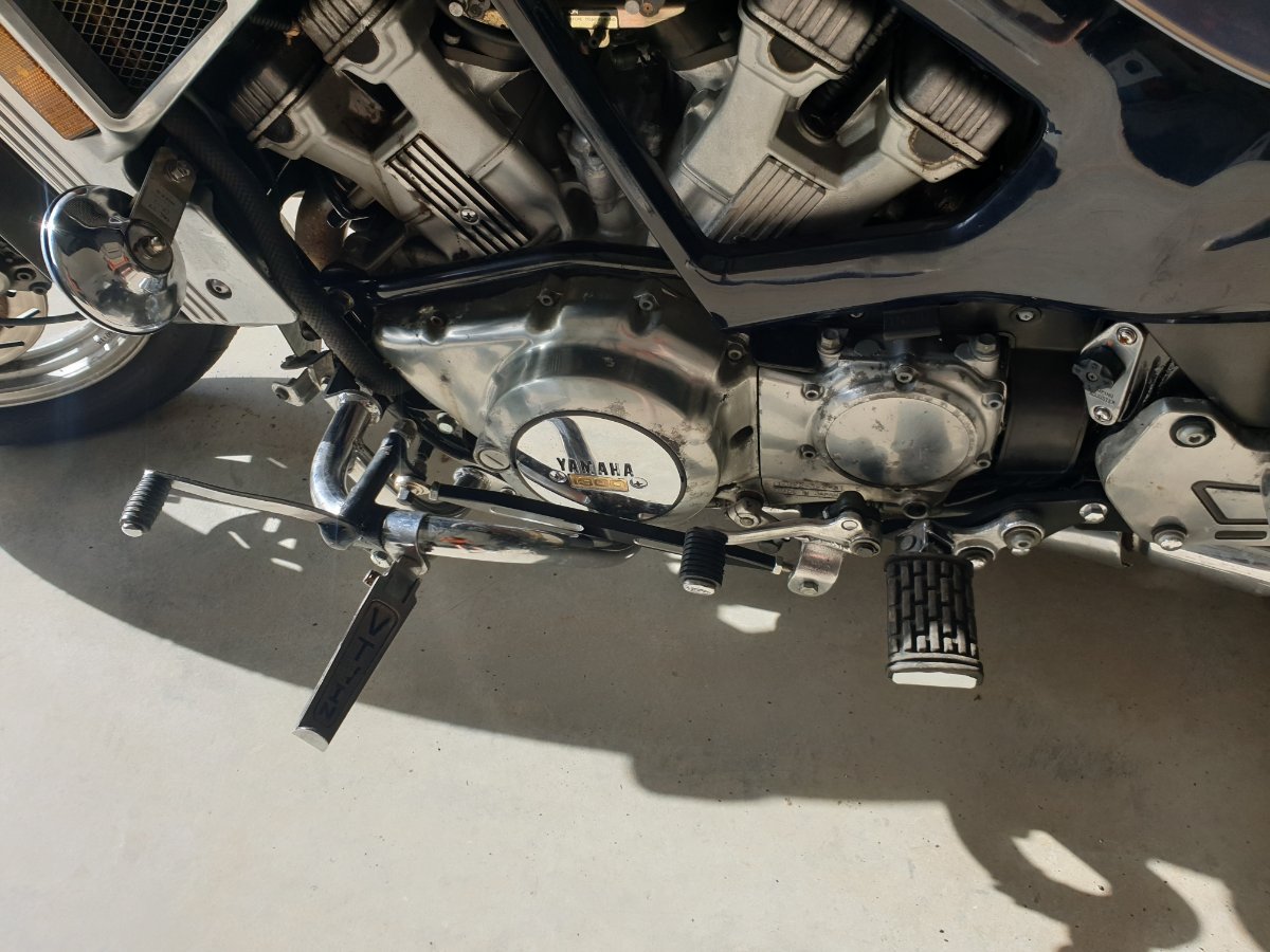

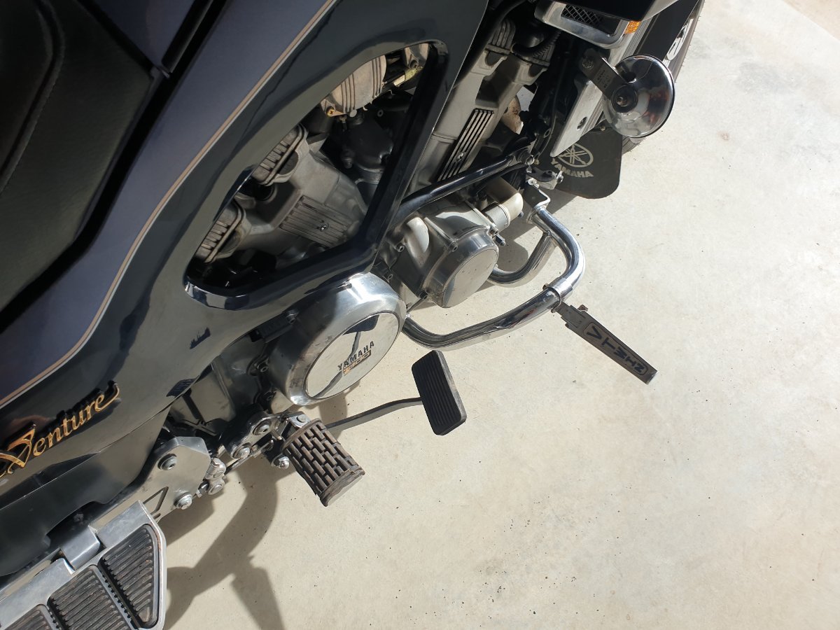

This is my 2 cents worth, works awsome, built my own forward gearset and replaced the brake pedal with a longer one so i can access from both pegs, be mindful, this is a trike, i use my heel for brake pedal when using front pegs, works great20220614_122741.thumb.jpg.8386fe5b1e0b04032c7aa040894e7954.jpg20220614_122755.thumb.jpg.08693ff4ede14d787c2bb1f732857dca.jpg
