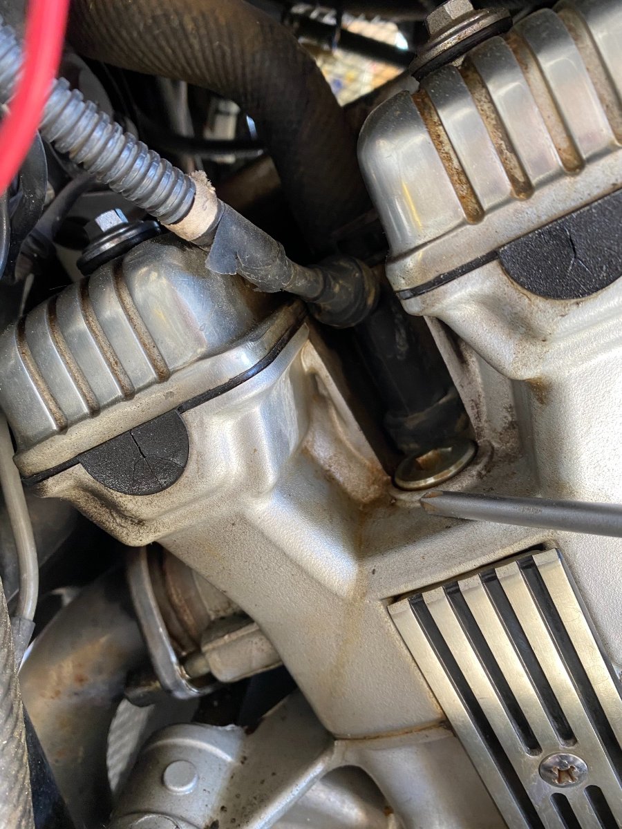

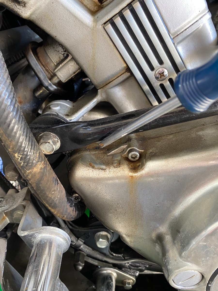

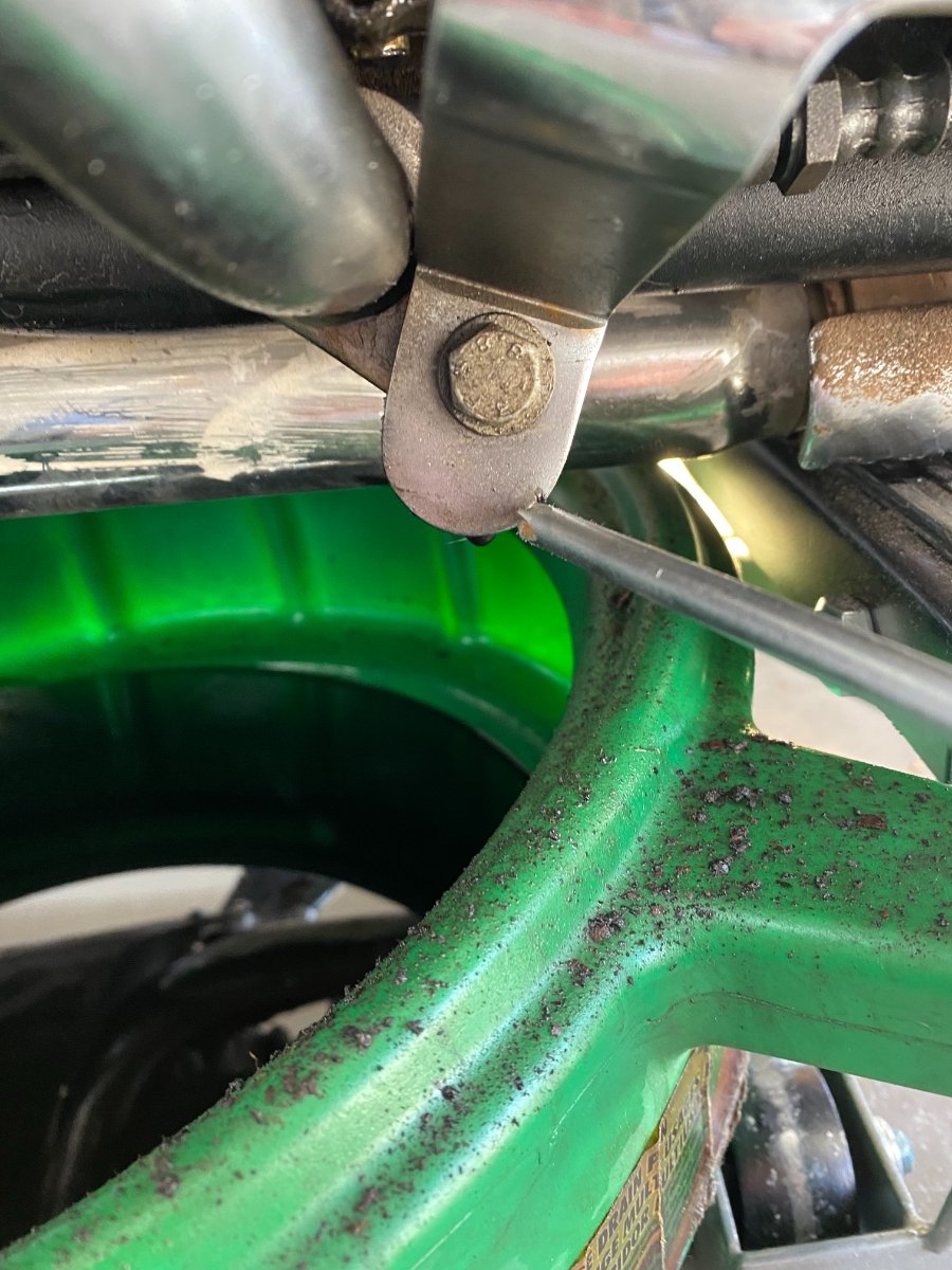

So I’ve got a drip that has been getting worse.  I just don’t know where it’s coming from.  The highest wet spot is by the spark plug but seems more wet down below.  Main point of drip is the front of the floorboard mount.  I don’t think it’s originating from the valve cover gaskets.  Got those in order...again.

Looking at the pics of the valve cover gasket, it looks pretty worn and cracked. Did you start using synthetic oil in it? I started having leaks on an 86 I had once I started using synthetic in it after I bought it. The synthetic oil will clean sludge deposits and sometimes with older gaskets and then the sludge getting cleaned out of age cracks, they can start to seep.

Cleanup is a great idea so that you can see where the fresh stuff is coming from.
From the photo it looks like you have seepage in 3 places:  Somewhere up on top near the valve cover bolt and a couple places seeping down from the valve cover gasket.

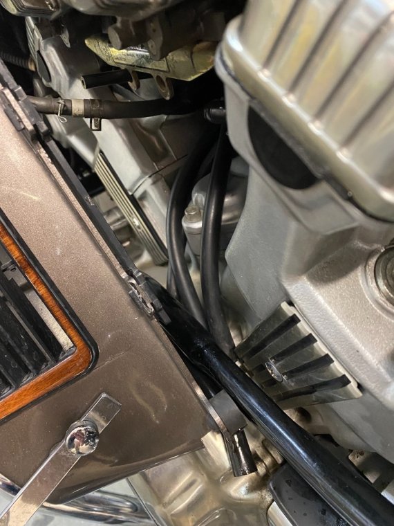

Two things I’ve discovered with this leak is one I put new oil in on Sunday let her warm up a bit and then positioned her in the garage on the center stand in prep for the new fork springs (that I just keep not getting to!!! Arrggg).  Monday morning there was only one little drip, by this afternoon only a tinsy bit more. So being upright vs the side stand my be a variable.
Two as you mention the spot on top on the cover, I noticed Sunday evening the Front left carb boot is wet and that carb is not seated correctly in the lower boot, this could also explain the suction sound I’ve been hearing but chalked it up as normal as I’ve never heard another of these bikes to compare to.  I’m thinking fuel leaking from that carb running down the engine collecting grease and grime along the way making it appear as an oil leak.  Also when I went to clean my garage floor from where it had been dripping all winter it was gummy.
