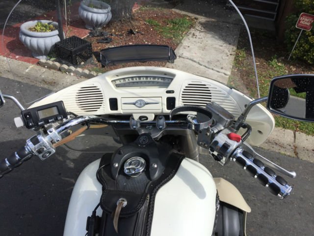

Stasher1 Posted March 17, 2021 Share #3 Posted March 17, 2021 (edited) That's not a picture of a 2000 Royal Star Venture dash. This is what it should look like. You should be able to attach a RAM clamp-on mount to the handlebars and attach you GPS there. Edited March 17, 2021 by Stasher1 Link to comment Share on other sites More sharing options...

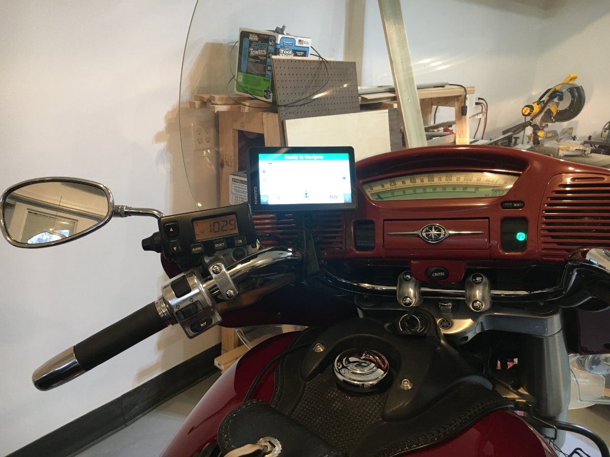

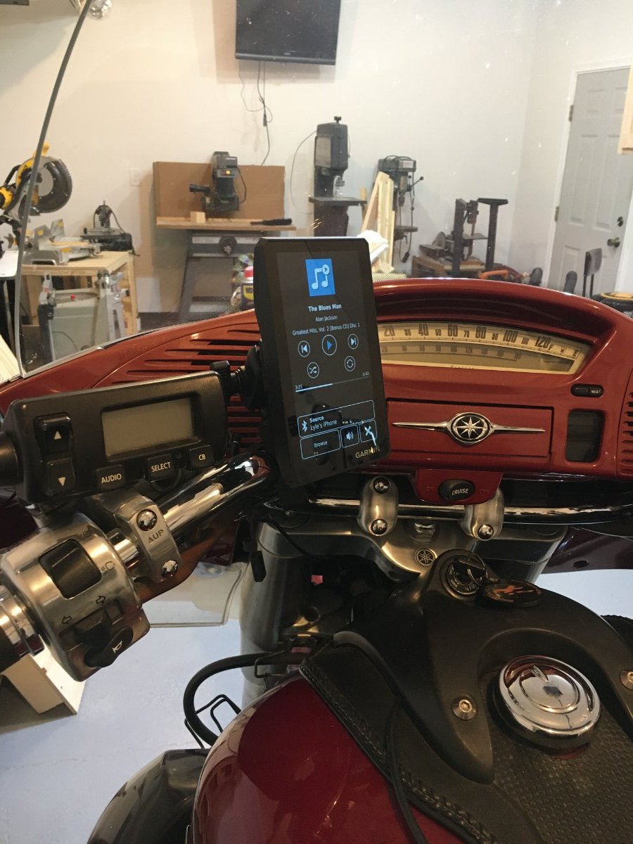

lyleh Posted April 9, 2021 Share #6 Posted April 9, 2021 I mounted my Zumo XT near the radio control. I tested orientation in both horizontal and vertical and prefer the vertical because in the horizontal position I could not see my left blinker light. For power I removed the gas tank and seat and routed the wires in the cabling channels directly to the battery. The garmin has its own fuse. The unit mounted with the hardware that was in the Garmin box. Link to comment Share on other sites More sharing options...
