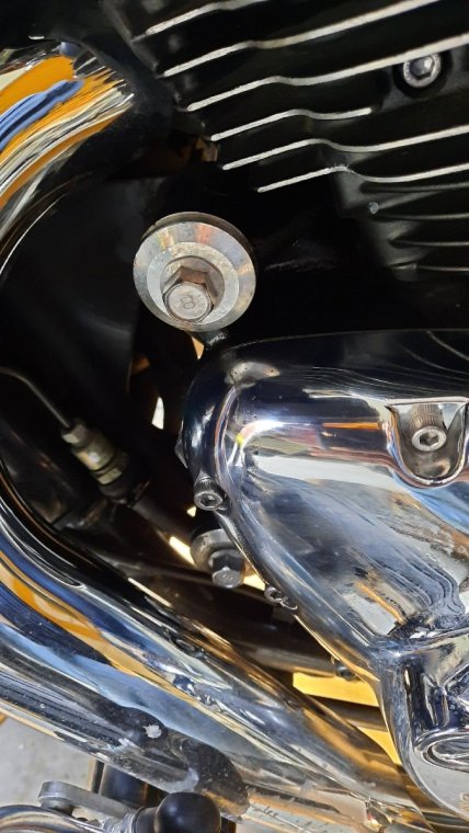

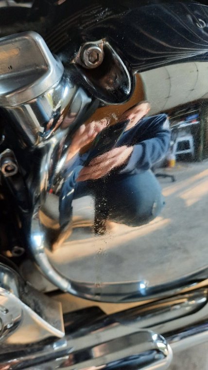

BlueChips84 Posted October 30, 2020 Share #1 Posted October 30, 2020 Well, I was going to sell my bike but two things stopped me: 1) My wife just shook her head and say keep it because I like it so much and, 2) I started to notice an oil leak under the bike about a month after I bought it. Can't sell it like that! So, she is here to stay and I'll ride the heck out of her but I want to fix this leak before it gets worse or is hinting at another issue. Bike has 54000 miles on it. I removed the side covers(fake fins) on both sides of the engine and tried to track down the source of the leaks. From first glance, it seems to be leaking around the head gasket on the front left and rear right cylinders, very slightly. Does not seem to be running down from the valve cover that I can tell but I have not dug in to the bike any further to look. I have heard about a TSB regarding improperly torqued head bolts on the royal stars of this vintage but not sure if that included the RSTD model. I'm hopeful that I can get away with just re-torqueing the bolts after getting the cover off and I suspect having to lift out the cam shafts. Is this feasible or am I looking at a full head rebuild as well? I have not noticed burning coolant at all but the reservoir was low. I never checked it when I bought it as it slipped my mind so I have no base line yet. I did not see any oil in it either but have not checked in the radiator. No coolant present in the oil either at this point. Suggestions? Guessing I'll have a project for the winter😋 Link to comment Share on other sites More sharing options...

BlueChips84 Posted November 11, 2020 Author Share #4 Posted November 11, 2020 Okay, so I pulled the covers, cleaned everything up and then went for a test ride, about 8km. Pulled the covers and found oil weeping from the head gaskets at the front left cylinder corner and rear right cylinder, also at the corner. I can't really tell if it is leaking further inside the block on the other corners but it does not seem to be so far. So, I'm thinking(praying) that it is just improperly torqued head bolts as there is no evidence of coolant leaking so far. Going to pull the covers, then cams and torque the bolts once the bike is parked for the season. Might as well check the valve clearances while I am at it as well. Now, if it does turn out to that the head gaskets are shot, is it possible to pull both heads off with the engine still in the frame or do I have to pull the whole engine out? I know it would be tight but a quick glance looks like it may be possible. Aric Link to comment Share on other sites More sharing options...
