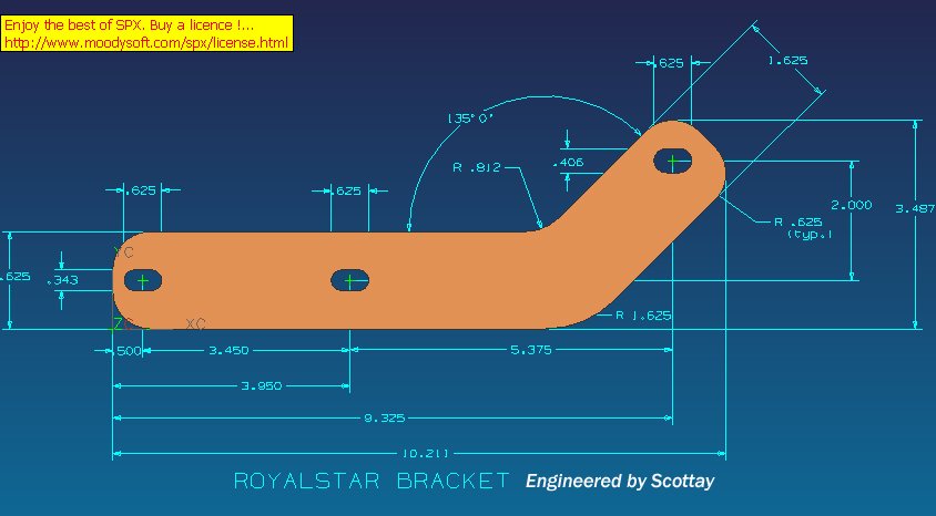

1. Any muffler that fit an Evo or Twin Cam Harley Davidson TOURING chassis FL series bike will fit our bikes. This includes Road King, Road Glide/Tour Glide, Classic, Ultra Classic & Classic Limited. Stock mufflers will give you a little bit of rumble, I currently run take-offs from an '06 Screaming Eagle Ultra and they have a bit more bark but not crazy loud on the highway. Aftermarket mufflers from Vance, Rush, etc will work just as well. There is a time (maybe '07-'09?) where the catalysts were in the muffler, but I'm not 100% sure on years.
2. There should be design plans on the website for 2 different shaped mounting brackets (one "angled" and one "hockey stick") that can be fabricated from mild steel with a drill and a cut-off tool. Others have used a P-clamp to mount the muffler to the bottom rail of the saddlebag support. I'll PM you a link to some of the information in just a minute.
