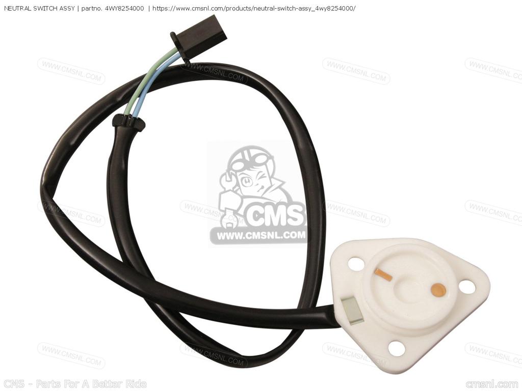

I always assumed the gear indicator switch used in the first gen is actually installed in the second gen. Something has to operate the neutral indicator and the overdrive (5th gear) indicator. I do not know if connections are in the switch for second and third, but they probably are and just not used.
If that is the case, I think it would be a simple matter of jumpering third to fourth to fool the computer.
The hard part is I think the switch is behind the clutch basket, and the basket must be removed to get to it.
I suppose someone could dig through the parts diagram and see if the switch is identical between the first and second gen.
Mine also only works in 4th & 5th. Studied the wiring diag for a few minutes. Can't figure out how it knows it is in 4 & 5th.

I've never been on a 1st gen, do they have a gear indicator for all gears or just a neutral light? Seems like a lot of contacts for just a neutral switch.
Link to comment
Share on other sites
The Gen1, MK1 only has a neutral light, no gear position indicator. It may be that it was only the Standard model that has only the neutral light. Not for sure on that. I do know my '83 Standard just has the neutral light and my '86 Royale has the gear position indicator.
Link to comment
So adding a gear indicator to a 2nd Gen might not be all that hard...interesting.
