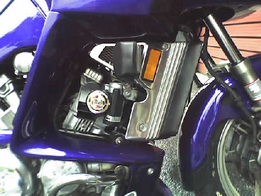

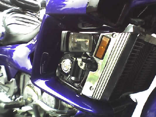

I made a bracket that mounted to the frame right where the horn does. Made it long enough to hang the horn outside the lower fairing leg. When I added combo fog/driving lights I made new brackets that carried those too.

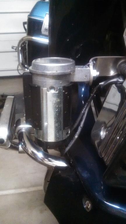

I mounted my driving lights to the original horn brackets, I mounted a Bad Boy on each side to the saddlebag crash guards. I used purchased chrome handle bar mounts to make the attachment. Worked great. 2 is better than one. I started with one and then a year later I upgraded to a second one. I ran them both off the same relay so it was really easy to add the second one.
