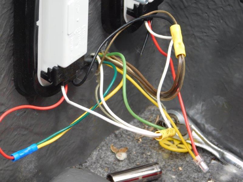

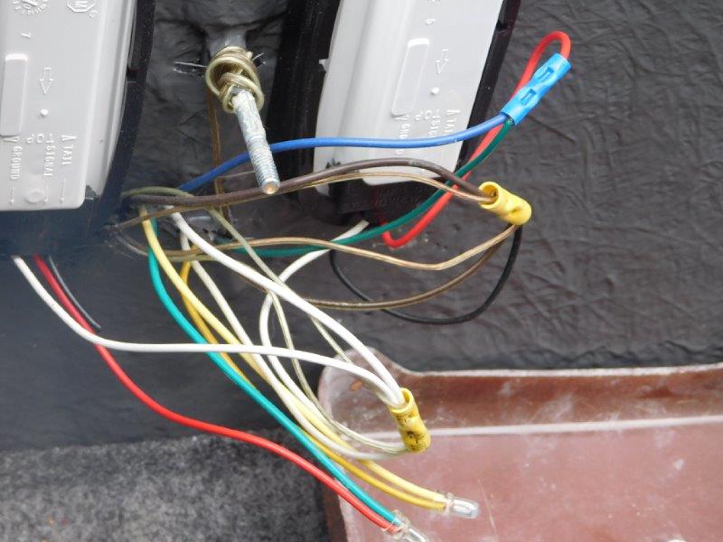

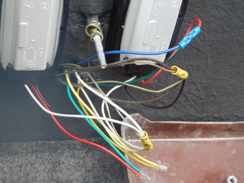

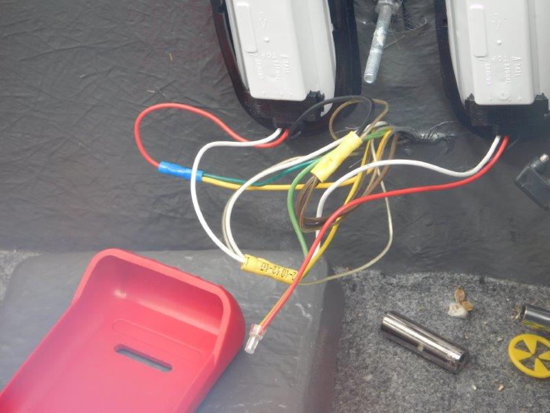

My bet is the PO just matched the bike out put to the trailer's needs and all he needs to do is swap the turns left and right. I would make the change on the trailer side so if he pulls another trailer the bike matches the accepted standard for trail wiring. The wires on the lights are are color coded black, red and white for both the red and amber lights, I only have photos of the inside of the trailer so I am not sure if the outboard light is red or amber, I am assuming the out board light module is the amber one, because the outboard light module on each side is not using the black wire, only the red and white. But there are green wires splice to white wires and blue wires spliced to green wires, green wires spliced to yellow wires, from the pictures it is just not possible to tell what is what. I suspect that one of the green wires is a jumper from the left or right brake to the other side, but just a feeling right now.

Maybe I should have posted these photos when I first got them., I do not like how they wired it, but again, no matter the state of the wiring, if the only thing wrong is left and right turns are swapped , easy peazy to swap the two at the trailer input connector. I am not with the guy so maybe there is more to the story that I know.

That is like the trailer that I worked, the factory wiring was a disaster so I stripped it all off and started over. All those crimp connections are issues just waiting to happen when they get wet and start to corrode.
It will be faster and cheaper to rewire from scratch than to fix everything that is there.

I was thinking all that was missing from that mess was some scotch loc connectors. But sgetti sauce was a good one. Man that is a mess. I guess in the mass produce get them out the door process crimps work.
