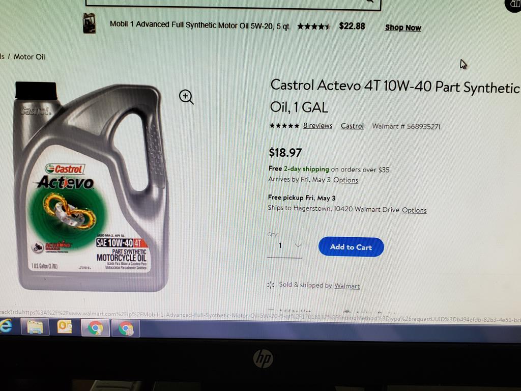

Don't know if this helps anyone, but WalMart has gallon jugs of Castrol Actevo 4T 10W-40 Part Synthetic Oil for $18.97... They also have free shipping to your home for orders over $35, so I bought 2 of these.
