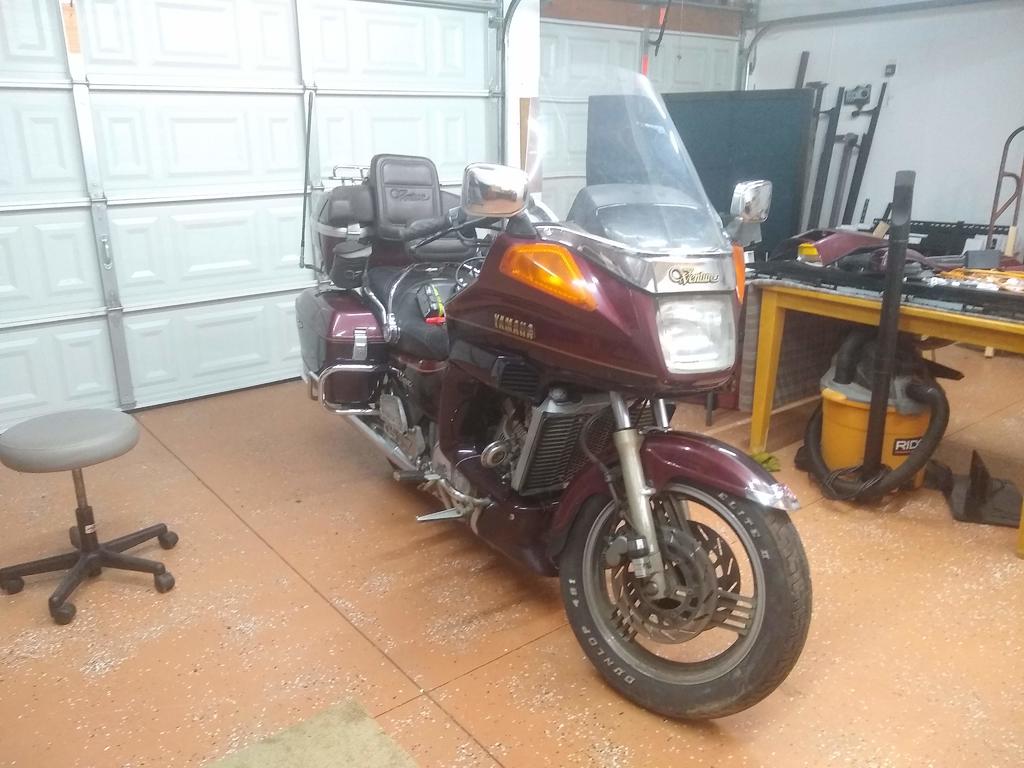

Hi, Sorry to ask a dumb question if its already been answered but I have not found anything in my search. Am I correct that the Ignition switch on the 88 VR is attached with a pair of 10mm bolts? Or are they using some kind of one time safety lock kind of bolt? I just ordered a new lock set for my bike and need to pull the original one as I don't have a key for it. I have heard that it can be reached from under the fairing with a ratchet and a few extensions but I cant see the bolt and I don't have a mirror ( I really need to get one). Thanks in advance.

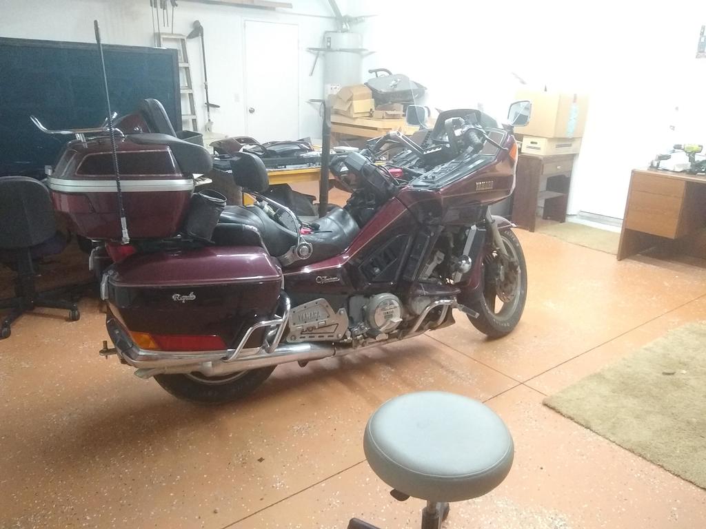

Nah, bought it that way. I got the bike from a man who bought it from an estate sale. and there were no keys. Paperwork was clean, so I bought it. everything was locked up and on first look it had no tank cover fuel door etc. I paid $200 for it and got it home and drilled the locks for the bags and trunk and I am starting the teardown on the carbs. When I opened the trunk and bags the rest of the bike was packed in there. so I have a complete bike. but it's been sitting for at least 5 years. carbs were frozen shut. Nastiest things I've worked on so far. So new kits and slides for them (I killed a slide getting it to break loose). I found the slides from a gentleman in SoCal for a really good price so I couldnt pass that up. I just spent about $400 on everything I needed to get her running today and need to get a few things ready for when those parts come in.
