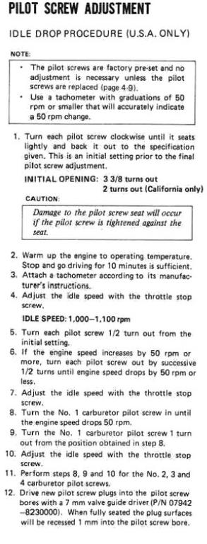

I don't know anything about 1st gen Ventures. But, on a lean drop idle, if you can't get it, you have to replace, yes replace, the pilot screws cause something is wrong with them. And, maybe... the pilot jets are not as clean as you may think either. Here is a lean drop from another bike as an example. ignore the 3 3/8 turns out to start if that won't work for you.
The above is for a pilot screw that adjusts for AIR. You will need to screw IN to adjust for GAS like in the Venture
https://www.venturerider.org/forum/attachment.php?attachmentid=115860
OH YAH BRO!
