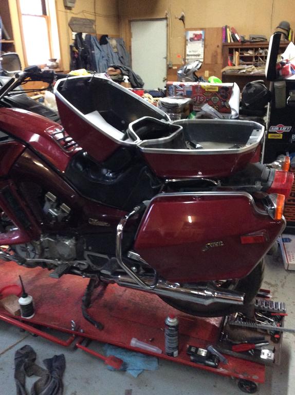

83 venture modified for solo riding

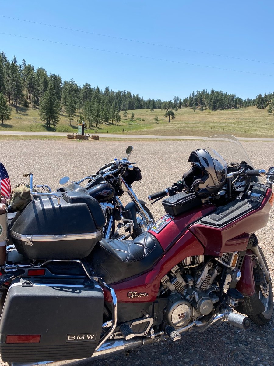

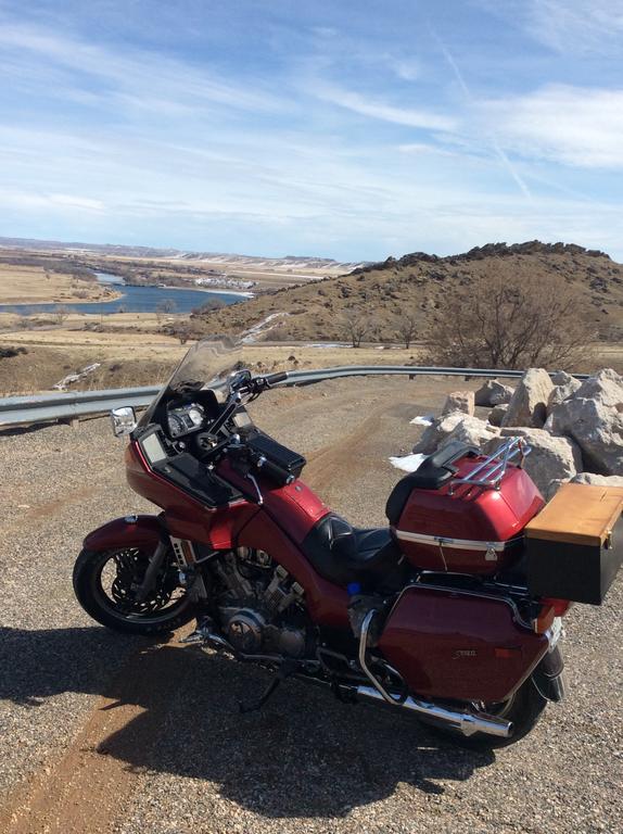

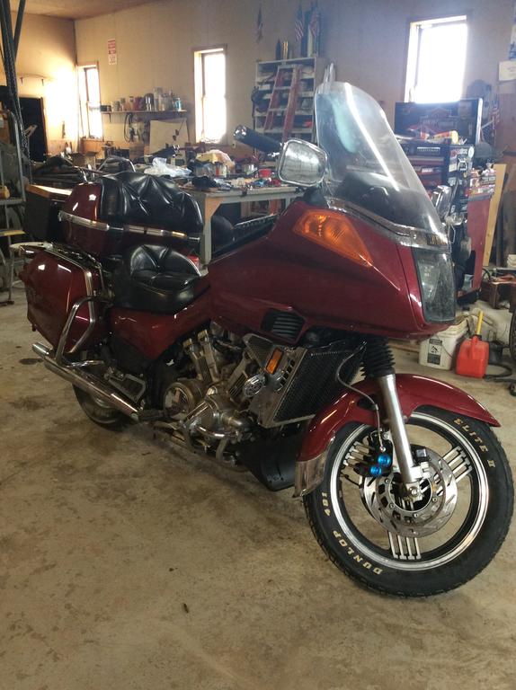

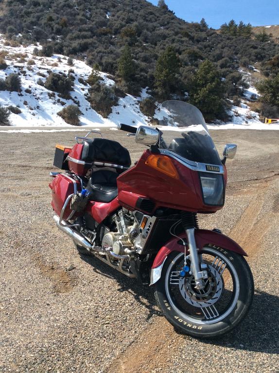

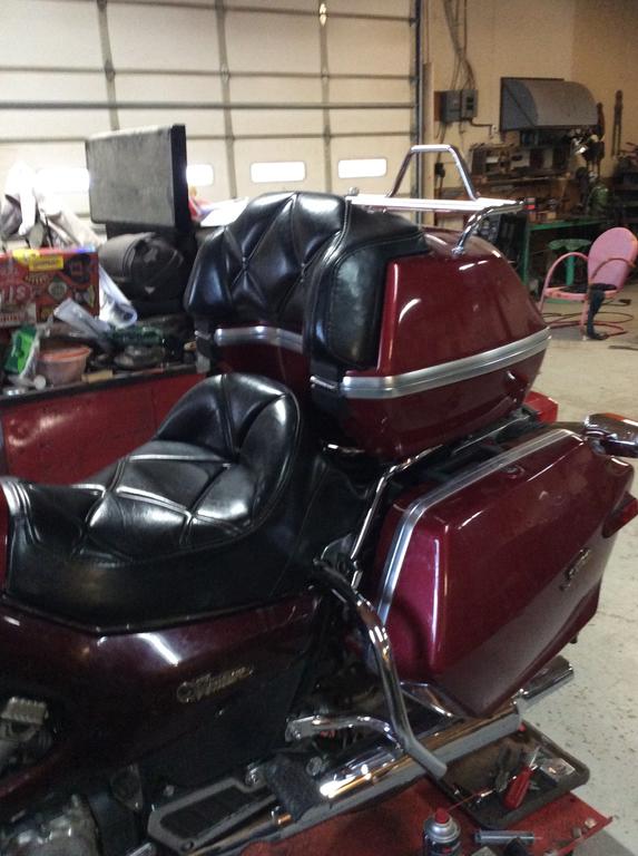

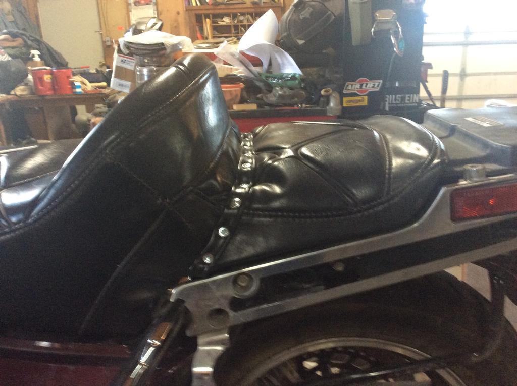

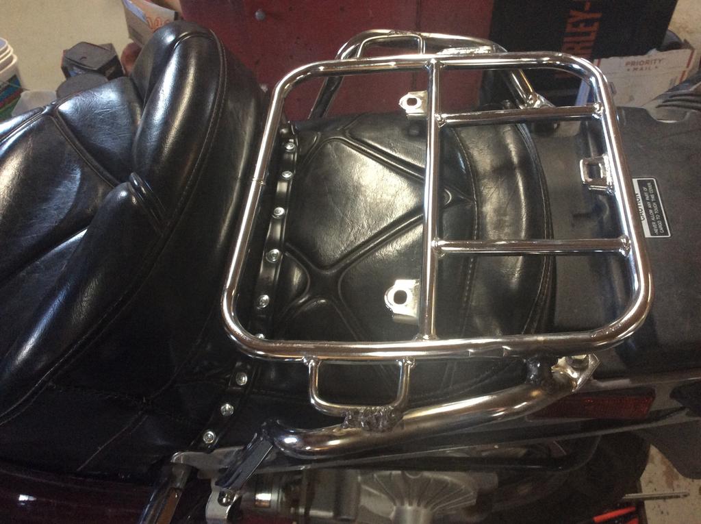

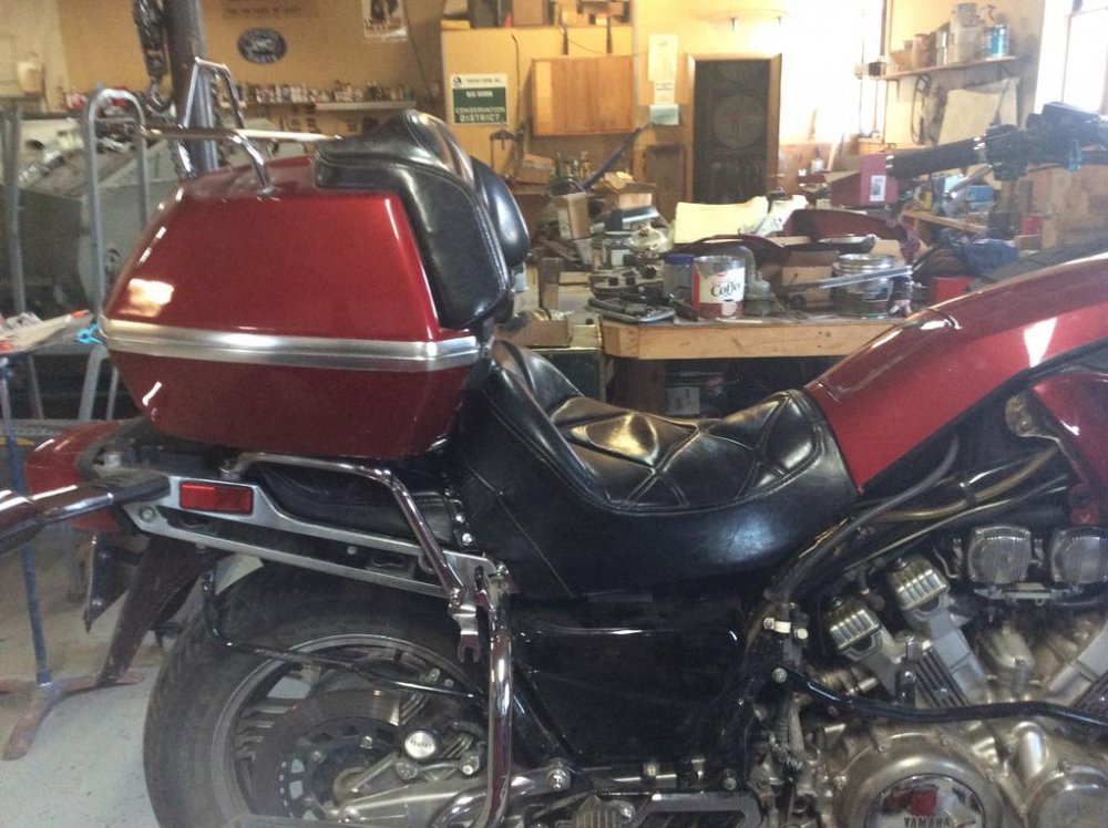

Not sure if anyone else has done this. I moved the top case rack/ package tray forward and welded to passenger grab rails. The seat was modified by cutting the passenger foam out and re-upholstering. It makes a nice backrest and a little room for stowage behind the seat and under the box. I also plan to bolt a used rack in the original spot for additional room.

Interesting concept. I rarely ride two up, but personally on long trips of over a week I've found that the passenger seat is a great place to bungee down that duffel bag loaded with clothes, and it also makes a great back rest... :-)
THAT is absolutely GORGEOUS @sturgis0722 213.jpgTweeks and Cowbuc relaxing ride.jpgMoonshine:thumbsup::clap2::dancefool:!!!! NICE WORK!!
Gotta admit though,, I tend to lean (pun intended) more in Jacks direction on this one.. Probably wayyy to old school for our own good that @Condor and I :hurts:

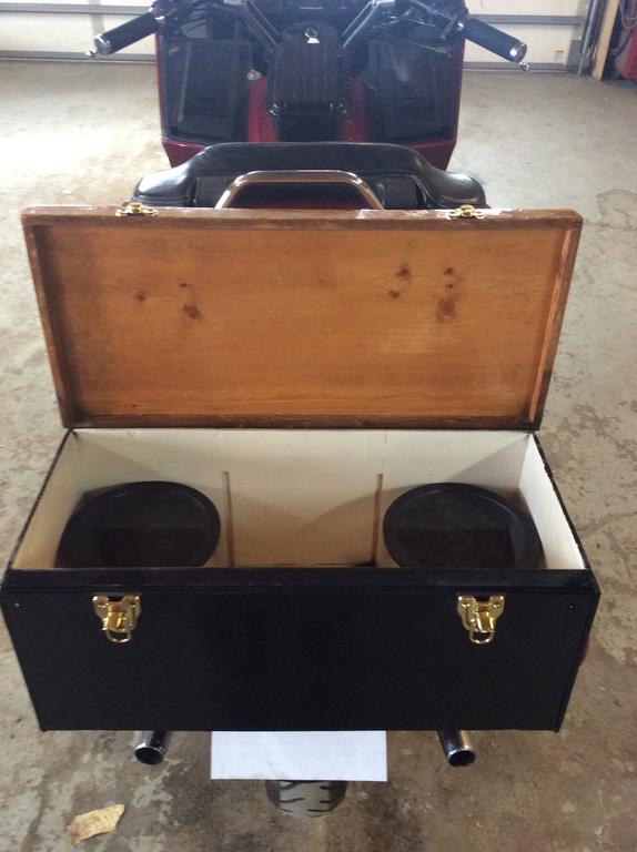

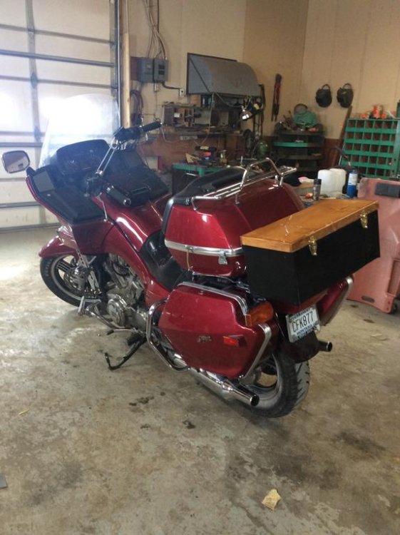

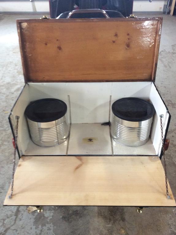

Rear box installed on additional stock rack on original mounting. Box made with 1/4 inch plywood coated in epoxy resin, paint, stain, and spar varnish. My goal is watertight storage with easy access to any bag, box, or case without unloading anything.

Looks like you'd have very little room to get your key in your Yamaha trunk to open it. Do you have a solution or is it not a problem?
I like what you'd done. I'm sure it's functional and works for you. You're making it yours, man and that's cool.

Had to abandon the trunk lock. Replaced with twist locking latches on each side. Works good and one will accept a padlock if needed.

I like the way you relocated the touring box for a backrest but the Bootlegger plywood box needs to go. That's just my opinion or butt hole everyone got one .:confused24:
Nope, the box stays. Got my coffee making gear in there. I will adopt your verbiage and combine with SkyDoc’s description. The box will now and forever be known as the “Bootlegger Locker”!

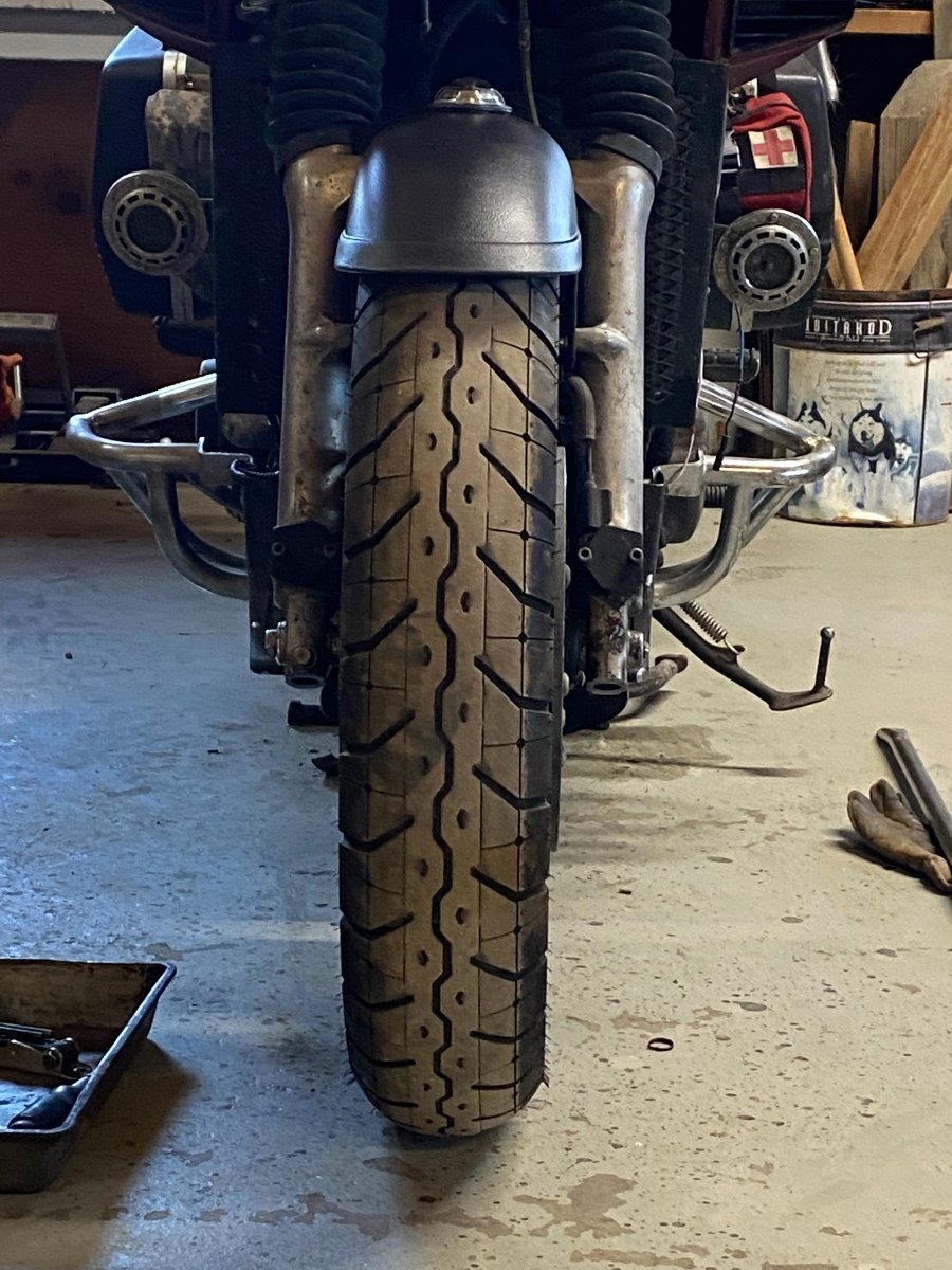

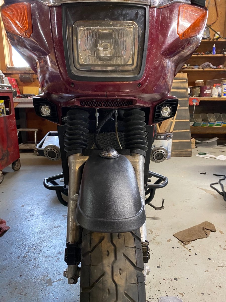

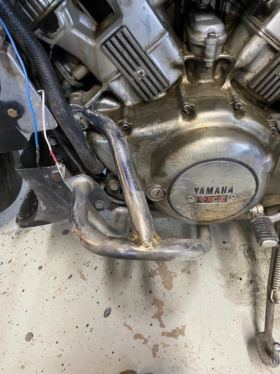

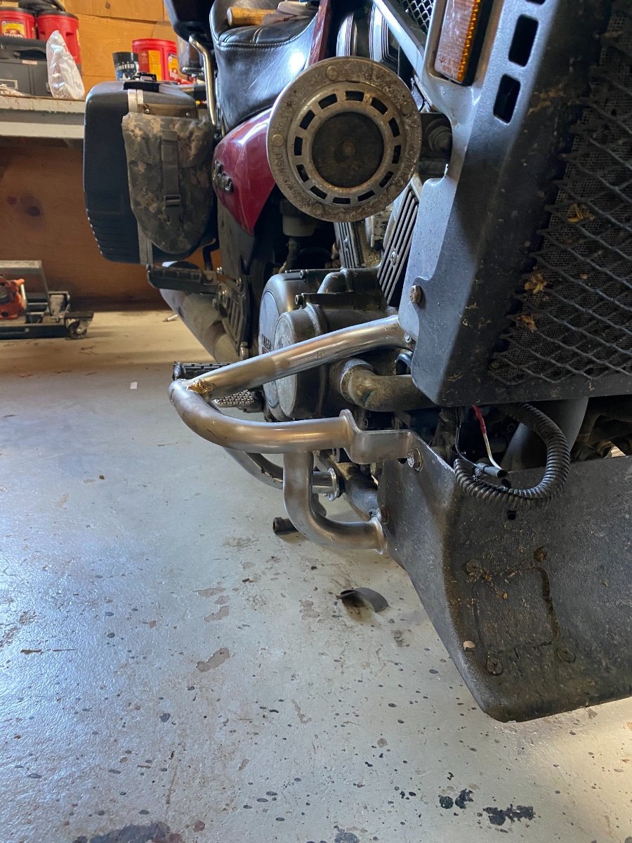

Added a brace on each side of the front crash bars.  Braces cut from the rear crash bars I took off awhile ago.  I have dropped the bike a few times, and the stock bars fold right up.  They are very strong now, as I can stand on them with no movement.  Hope this helps!
