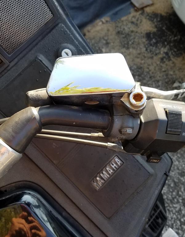

luvmy40 854 Posted September 20, 2018 Share #1 Posted September 20, 2018 This may sound random RE: the thread title, but here goes. My '83 Standard seems to have every piece of added "Bling" available. The plastic is all busted in some one way or another, though it has all been repaired enough to be serviceable if not pretty. All the extra chrome is what makes this 36 year old bike look great fro 10 feet away. Random, Right? So here's the question; I am considering delininking the brakes simply for ease of maint. when I replace all of the 36 year old hydraulic hoses. The front MC will need to be upgraded in the process, unless I am mistaken. Is there a suitable upgrade MC that will fit with the chrome MC covers that are on the OEM MCs? Here is a picture of the bauble in question: I have always hated the way the bar mounted MCs look and Yamaha's are especially hideous in their natural state. One of the things I loved about the '81 XJ750RH, SECA was the front master cylinder being a remote(hidden), cable operated set up. Thanks for any input in advance. Link to post Share on other sites
Prairiehammer 944 Posted September 20, 2018 Share #2 Posted September 20, 2018 If you retain the stock '83 calipers, there is a 50/50 chance you may not have to change the front brake master cylinder. Some have retained it with no issues. Others have found they didn't like the feel and/or there was too much travel in the lever. Like I say, it is a crap shoot. If you decide to change the master cylinder assembly, go with the MKII master cylinder. It is 14mm bore versus the MKI ½" bore. Your master cylinder reservoir cover will fit identically on the MKII master cylinder reservoir. Link to post Share on other sites

Patch 810 Posted September 20, 2018 Share #6 Posted September 20, 2018 If you retain the stock '83 calipers, there is a 50/50 chance you may not have to change the front brake master cylinder. Some have retained it with no issues. Others have found they didn't like the feel and/or there was too much travel in the lever. Like I say, it is a crap shoot. If you decide to change the master cylinder assembly, go with the MKII master cylinder. It is 14mm bore versus the MKI ½" bore. Your master cylinder reservoir cover will fit identically on the MKII master cylinder reservoir. I hope you had to look that up? Sometimes between you and Bongo I doubt I've ever worked on a Venture. Maybe my diet, I must need more bata something? Luv, I would build a long term feasibility plan for the bike. Not too long ago you thought maybe time to look at a replacement bike? Hard to do I know but if this girl isn't bringing it to you any more then maybe that itch is what needs attention? Have you already deleted the antidive system? Link to post Share on other sites

luvmy40 854 Posted September 21, 2018 Author Share #9 Posted September 21, 2018 (edited) I gotta say, I'm not sue why the Gen1 MK1 brakes have such a bad reputation. I have plenty of braking ability and the linked brakes don't seem to have any detrimental side effects. I have ridden many thousands of miles with far worse brake systems. I don't want to delink because I don't like the linked system. It's simply a matter of ease of maintenance and the fact that Skydoc_17 has line kits available only for the delinked setup. He offered to make up a set for me to keep the original configuration, but I just think it will be easier in the long run to upgrade my front MC and use the kit he has already developed. ETA: I'm not sure the hydraulic anti dive system has ever been all that great. The '81 SECA had a similar system and I could not feel any difference in dive with it active or disabled. Progressive springs are also high on my list of "need". Edited September 21, 2018 by luvmy40 Link to post Share on other sites

Flyinfool 4,078 Posted September 21, 2018 Share #11 Posted September 21, 2018 On my 88 when I delinked the brakes I did not like the mushy feel of the front brake. while rebuilding the master I noticed a lot of pitting of the bore. 3Times I bought a used MC and all 3 were pitted beyond honing and rebuilding. So I gave up and bought a new after market 16mm bore master. I never did get around to installing it before I sold the bike. I still have it if you are interested. Link to post Share on other sites
luvmy40 854 Posted September 21, 2018 Author Share #12 Posted September 21, 2018 On my 88 when I delinked the brakes I did not like the mushy feel of the front brake. while rebuilding the master I noticed a lot of pitting of the bore. 3Times I bought a used MC and all 3 were pitted beyond honing and rebuilding. So I gave up and bought a new after market 16mm bore master. I never did get around to installing it before I sold the bike. I still have it if you are interested. Will my shiny MC cover fit? Link to post Share on other sites
Flyinfool 4,078 Posted September 21, 2018 Share #13 Posted September 21, 2018 I will have to pull it out to check, but I really doubt it. That does not mean that you can not take the cover off of this one and sand and polish it then clear coat it to stay shiny. Heck you could make the whole thing shiny if you were that ambitious. Link to post Share on other sites
