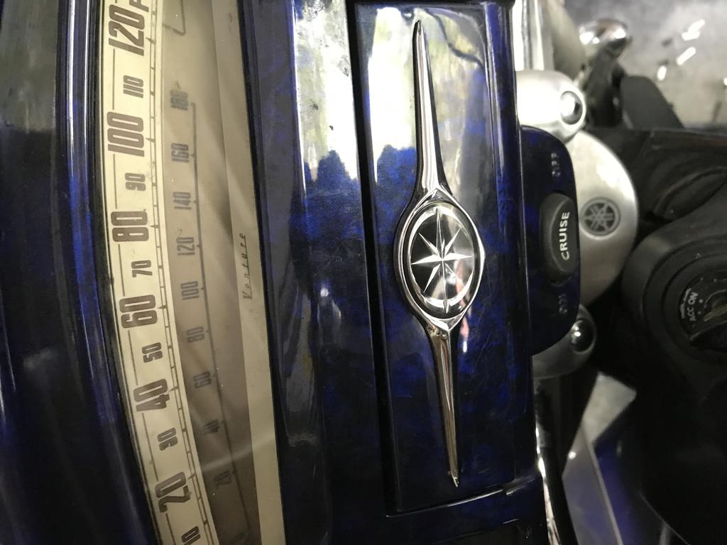

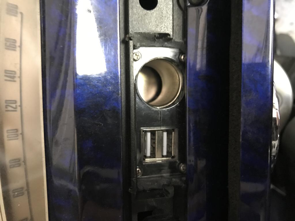

I too finally got around to removing the tape deck. I gutted it and mounted a charger port behind the door. It has a lighter plug and two USB ports and hardwires in. I don't know how much it will be used but I guarantee it will be more than the tape deck. I did find an old Merle Haggard tape laying around and tested the tape deck once, it worked but the wife was screaming before the first song was over.

IMG_1086.jpgIMG_1087.jpgAfter gutting the deck I installed the charge port and re-installed it, the door still works. The mistake I made was in not realizing it has an internal LED that stays on. I had installed an extra fuse box behind the battery and ran a hot wire into the fairing so I could charge the phone without the bike running. Rather than pulling it back out I added a relay that fires from the factory lighter port so it only works with the key on. I routed on charge cable out the back of the box through the fairing and up the bars to plug the phone in while in the cradle. If I had it to do again I'd use a port with an on/off switch or get one without the LED.
While I had it torn down I installed a WOLO horn and finally put on the leather tank bib I won at Don's MD. Weather man says 60's here next week so it's almost time to ride again.

https://www.venturerider.org/forum/attachment.php?attachmentid=114725https://www.venturerider.org/forum/attachment.php?attachmentid=114726After gutting the deck I installed the charge port and re-installed it, the door still works. The mistake I made was in not realizing it has an internal LED that stays on. I had installed an extra fuse box behind the battery and ran a hot wire into the fairing so I could charge the phone without the bike running. Rather than pulling it back out I added a relay that fires from the factory lighter port so it only works with the key on. I routed on charge cable out the back of the box through the fairing and up the bars to plug the phone in while in the cradle. If I had it to do again I'd use a port with an on/off switch or get one without the LED.
I like that. Want to do something similar to mine. Does the tape deck come out through the front or did you have to split the fairing?. Was it a pain to get out?
You have to split the fairing, move the radio out of the way, and pull the cassette deck from the front of the bike. There are instructions in the read only tech library. It takes a little wiggling and prying to get the door past the inner fairing. Just be easy with it, it's not too bad. I wish I'd done all this at once instead of one piece at a time. I've installed the Edsets splitter(Buddy Rich cable), a 12 volt Bluetooth receiver, Amplirider, and now this charger. Now I can answer phone calls, stream music, and use the gps through the bike's sound system while the phone charges in the cradle. It makes it easier for me to get away knowing my kids can reach me if needed and being able to answer customer calls.
