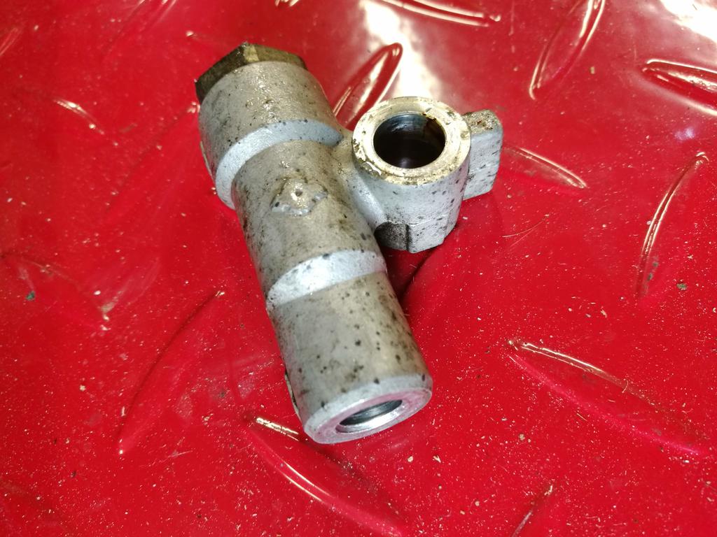

This is the proportioning valve correct? I removed it and put the brake line into its socket. Capped where the front line goes. As it rides now, I dont think I could lock up the rear wheel. I've pulled the caliper and did a good cleaning but did not get new seals. I guess I still have some air in the lines.

What brake pads do you have. The HH do have a lot more grip. I have to hit the rear really hard to get lock up, but you really do not want to lock brakes on a bike. I played with the peddle height to get the rear braking to be just shy of lock up. I have to make an effort to get lock, so that I am unlikely to lock the rear in a panic stop.

Really not sure of the manufacturer of the pads as they were the one that were on the bike when I got them. They have lots of life left on them. I will try to bleed the brake again (I feel like I've already done an extensive bleed on these damn things). Maybe I'll take off the caliper and hang it higher than the mount so air runs to the bleeder or I'll try reverse bleeding. Then I will adjust the pedal to where the brakes come on sooner in the pedal travel. Im a big user of rear brakes especially in slow speed maneuvers.
