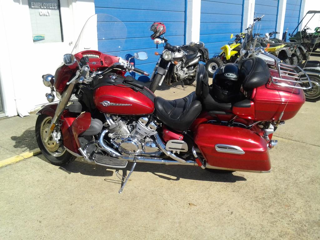

malenurse13 Posted January 30, 2018 Share #1 Posted January 30, 2018 I thank everyone on this forum for all the good advice before buying this Venture. I'm very happy with the purchase. It was a 50 mile ride home, mostly highway. So I got a good feel for it today. HOWEVER... This Venture is quite different from the V-Twin sports bike I've been riding the last 2 years. So I have some questions... 1. What speed do y'all normally cruise on the highway? Any faster than 75 or 80 seemed a bit too much for my Venture today. 2. Is some backfiring on deceleration normal? If not, what could be causing it? 3. Unfortunately, the previous owner left this bike out in the sun A LOT. The thick black hoses (air intake??) under the tank are dry rotted. There is a lot of superficial rust. What do I need to look for that I might NOT see so easily that could also be damaged from keeping the bike outside all the time?? 4. The horn works half the time. I got cruise control to work only the first time I tried it. I could not get it to work again. What could be causing all the buttons and switches to be so sketchy? Could it be all the time in the sun? Could it be just old wiring? Both? Here's a pic of the hoses that are dry rotted... Where can I find some new ones?? Link to comment Share on other sites More sharing options...

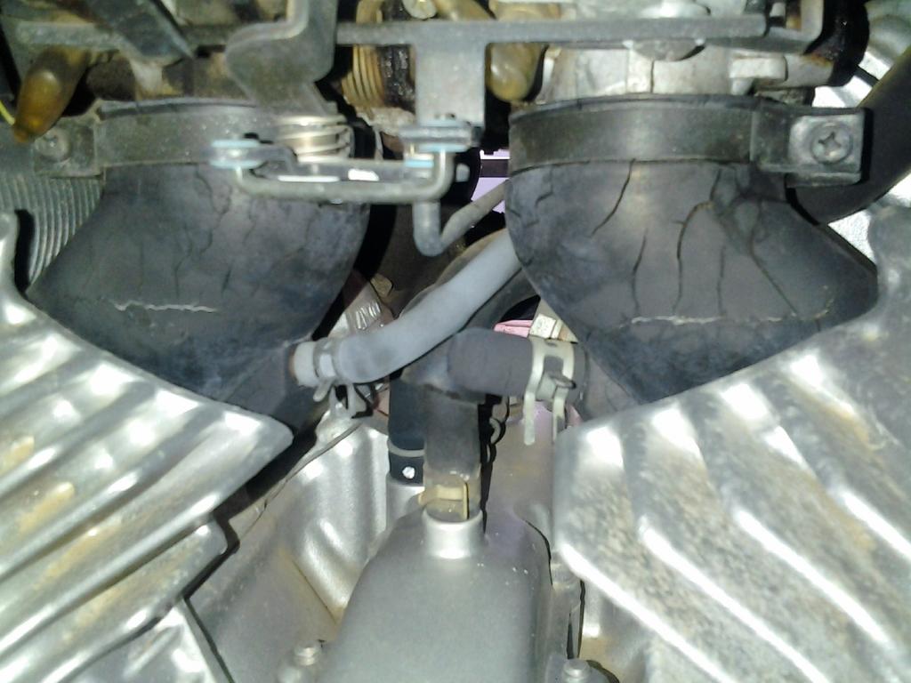

malenurse13 Posted January 30, 2018 Author Share #2 Posted January 30, 2018 The hoses on the other side are much worse. I plan on replacing them as soon as I can.... Link to comment Share on other sites More sharing options...

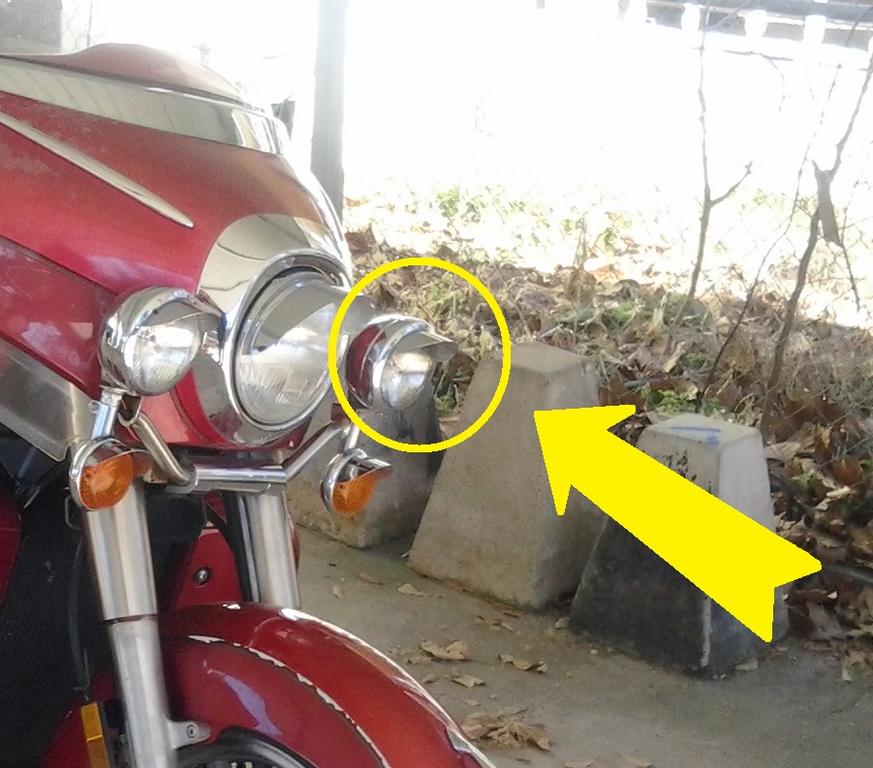

malenurse13 Posted January 30, 2018 Author Share #3 Posted January 30, 2018 The smaller headlight on the left side is not working either. Does anyone know what bulb I need to buy to replace it? Are there any better bulbs y'all would recommend? I do a lot of night time riding and I want to see all the DEER on the side of the road! Link to comment Share on other sites More sharing options...

snyper316 Posted January 30, 2018 Share #10 Posted January 30, 2018 I second the exhaust leak on decel popping, i found my leak to be off the rear header with bad copper oring. mine is first gen tho, now the big black hoses are you carb manifolds at least what i call them, this could be causing a lean condition, possible replace i would replace just because the shape there in, then I would finish that off with a good carb sync and see where you stand there. my bike would also fire right up with just 2 cylinders firing... and yes only 3 cylinders if you dont know these bikes and motors you would never know you was running 3 cylinders but once you get all 4 firing O MY LAND YEEHAW!!!!! Link to comment Share on other sites More sharing options...
Davin Posted January 30, 2018 Share #11 Posted January 30, 2018 The smaller headlight on the left side is not working either. Does anyone know what bulb I need to buy to replace it? Are there any better bulbs y'all would recommend? I do a lot of night time riding and I want to see all the DEER on the side of the road! http://www.venturerider.org/forum/attachment.php?attachmentid=111430Head light bulb is H4 your driving/passing light bulbs are H3 Some people upgrade to LED or daymakers. Sent from my SM-G930F using Tapatalk Link to comment Share on other sites More sharing options...
Davin Posted January 30, 2018 Share #12 Posted January 30, 2018 http://www.venturers.org/Tech_Library/index.php?action=article&cat_id=002010&id=324 More reading on the intake rubbers Sent from my SM-G930F using Tapatalk Link to comment Share on other sites More sharing options...

djh3 Posted January 30, 2018 Share #14 Posted January 30, 2018 The pop on decell could be from the AIS "smog" system. Sometimes when blocked off they get a leak and pop, because it basically is part of the exhaust and pumps some of that wir into the intake. There are ways to disconnect it if it is not already. The driving/passing lights can take a PAR 36 bulb if incandescent (sealed beam) If its a bulb that goes into a housing its probably a H3. There are some LED bulbs that work, the same bulb goes in the Harley lights. While your poking around the passing lights find out if they wired thru a relay. That thing should rool @ 80 mph without even breathing hard. Link to comment Share on other sites More sharing options...

mabeline Posted January 30, 2018 Share #20 Posted January 30, 2018 Like said earlier, your backfiring might be the AIS system. There's a write up in the 2 gen tech library on how to plug it. I plugged mine years ago. Problem solved. The clutch lever on mine gave me some issues, not allowing me to set or res my cruise. The lever would come all the way out except for the last 1/16" or so. Just a tap with my finger and it was all good. I cleaned and lubed the pivot point and that fixed it. Link to comment Share on other sites More sharing options...

XV1100SE Posted January 30, 2018 Share #22 Posted January 30, 2018 The smaller headlight on the left side is not working either. Does anyone know what bulb I need to buy to replace it? Are there any better bulbs y'all would recommend? I do a lot of night time riding and I want to see all the DEER on the side of the road! Brightest passing lights I've had on my bike are the GE H7616. Far brighter and longer reach than the Silverstar Ultra sealed beam. The H7616 is a Halogen "very narrow spot". This allows you to point each passing light. Set height the way you would your head light. Left passing light I have slightly right to not blind oncoming cars. The right is more towards the shoulder. They are a PAR36 4 1/2" sealed beam with screw terminals. Link to comment Share on other sites More sharing options...
