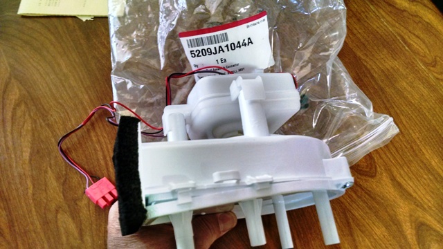

Karaboo Posted January 20, 2018 Share #19 Posted January 20, 2018 Our 12 year old LG (Kenmoore) has the bottom freezer. It was getting louder and louder. I found a youtube video of the fan replacement process and it didn't look too bad. The fan was behind a panel in the freezer. I ordered a fan online and it took about 20 minutes to change. The hardest part was pulling the unit out to unplug the power. It is quiet as a mouse now. The house has to be perfectly quiet to hear it running. Link to comment Share on other sites More sharing options...

Venturous Randy Posted January 21, 2018 Share #24 Posted January 21, 2018 Our 12 year old LG (Kenmoore) has the bottom freezer. It was getting louder and louder. I found a youtube video of the fan replacement process and it didn't look too bad. The fan was behind a panel in the freezer. I ordered a fan online and it took about 20 minutes to change. The hardest part was pulling the unit out to unplug the power. It is quiet as a mouse now. The house has to be perfectly quiet to hear it running. This is interesting as I spent over 15 years with a company that made fan motors for the appliance industry. I was their Corporate Quality Manager and they were producing 65,000 motors a week. They were Morrill Motors and were bought out by Regal Beloit. When I was with them they had four plants in three states. Now, they have about 1/2 of one plant left and most went to China. When I was with them, the cast iron frame motor was known as a 20 year motor and the aluminum frame motor was about a 15 year motor. I have heard now that they are a five year motor at best. If you haven't thrown the motor away, I would be interested to know if it was a Morrill Motor. Randy Link to comment Share on other sites More sharing options...
Karaboo Posted January 21, 2018 Share #25 Posted January 21, 2018 There are two fans in the freezer area. One blows up into the fridge, the other for the ice maker. Did not see any manufacturer ID. Same motor on both. Housings had minor differences. Fan housing was not snapped together very well when I got it. Link to comment Share on other sites More sharing options...
