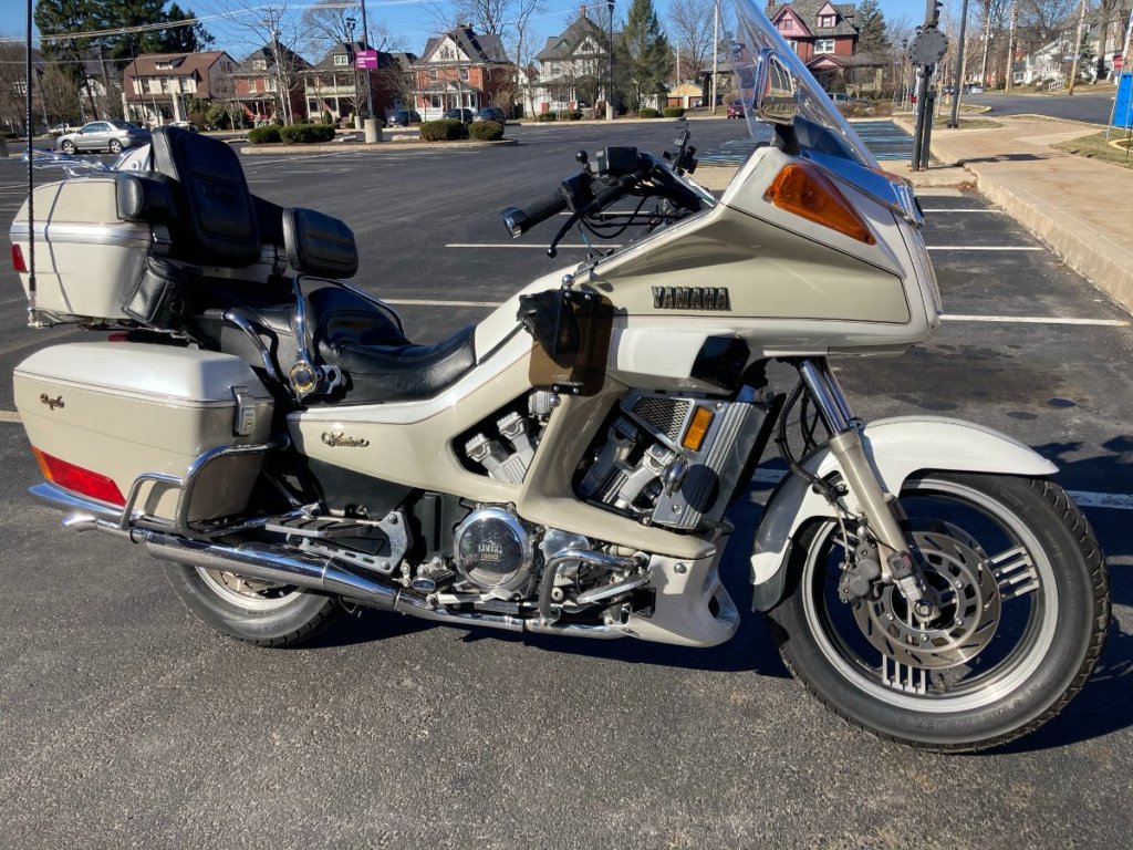

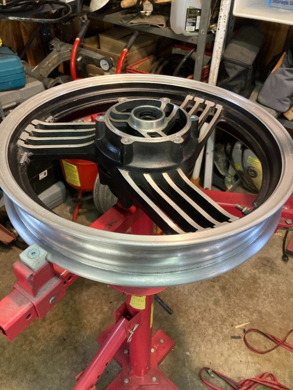

Another pic from this afternoons work. Rebuilt the brake calipers and installed them with new pads.
Finally was able to clean up the generator cover and get it painted. The two center plates for the generator cover and the clutch cover were shipped out to the platers last week. Looking forward to se
Made some good progress this week. One part at a time, but it was a good week. Spending lot's of time looking at the manual, looking at parts diagrams and digging for parts. I have some duplicates and

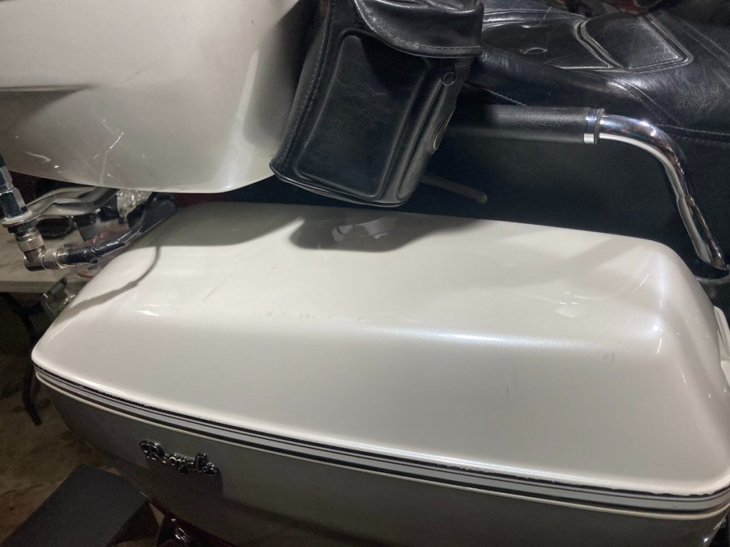

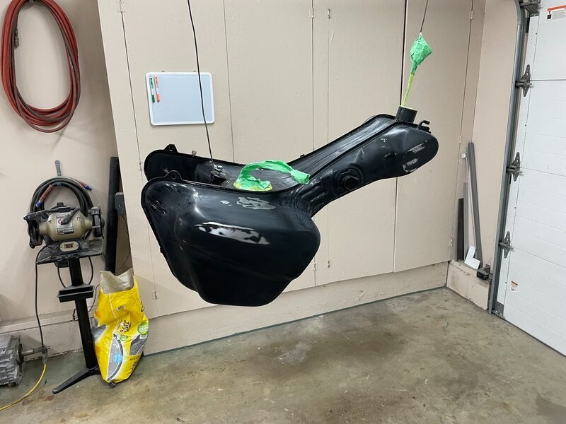

Bad news from the painter.  The one faring panel and one saddle bag lid needed touched up.  Well there is no such thing as touching up.  The two parts were going to cost 7-8 hundred dollars to repaint.  I said yes but then changed my mind.  They were not that bad so I am passing on that expense.  Money will get spent on another bike project.  My Vision needs some cams

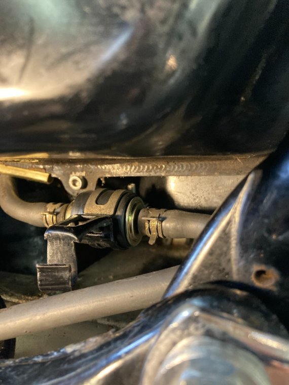

Who ever said the fuel filter was best ordered from Yamaha might be right.  I have now tried two different ones that were cross referenced to the correct ones and both were the wrong size.  I made the second one work with some rubber hose and electrical tape.  The first one was too big to fit into the clamp.  I suspect the clamp is not really needed but at least this one is in the clamp.  I assume it will flow enough.

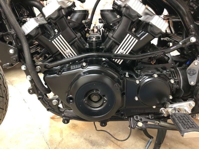

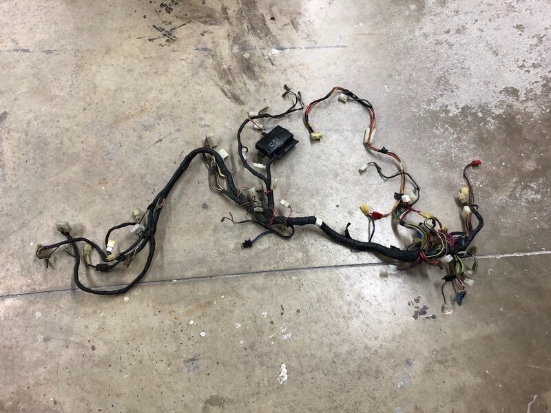

Finally was able to clean up the generator cover and get it painted. The two center plates for the generator cover and the clutch cover were shipped out to the platers last week. Looking forward to see how they look with some shiny chrome. I also worked on the side covers for the cylinders. Both turned out real nice. I ended up buying another wiring harness. The original one was to chopped up with a lot of wiring additions and modifications. I found a nice one that doesn't have any mods done to it. It looks like it just needs a little cleaning up and I can start putting it on. More to come later.

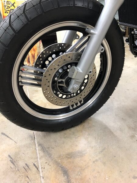

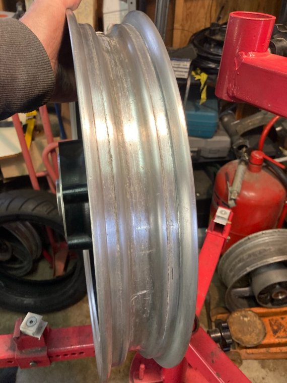

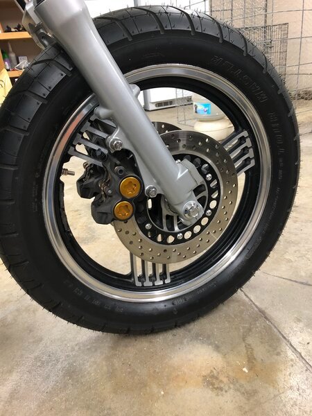

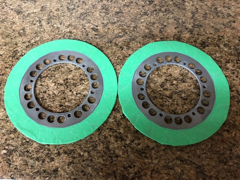

I know I must have read this at one time concerning the R6/R1 front brake caliper upgrade, but for some reason I guess it just didn't stick. If you go back in the thread a little bit you will see a pic of the front wheel with a set of R6 brake rotors on it. Well they look really good, but they are too big for the upgrade. The R6 rotors are 300mm and you need to have ones that are 282mm which are the same as the ones from a MKII Venture. I guess I missed that part. The R6 rotor seems to fit just fine on back and so I wanted to keep with the same hole pattern for the front rotors. The MKII rotors have the slots and so not a great match. I did some research and found out that rotors from a 96-99 Yamaha Virago XV1100 are 282mm and have the same hole pattern as the R6. Here is a couple of pics of the rotors prior to painting and installed.

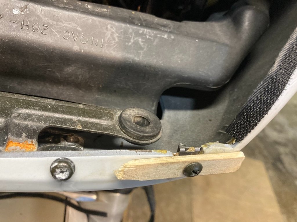

Don't ask me why after 10 mg of zolpiden/ambian and a couple of oz of run I would want to share what I managed to get to get done today.

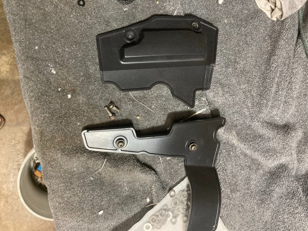

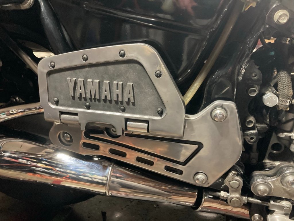

Please excuse the pile of photos, they all dumped in at once as zip file from Icloud photos.  I will try and explain what each photo documents

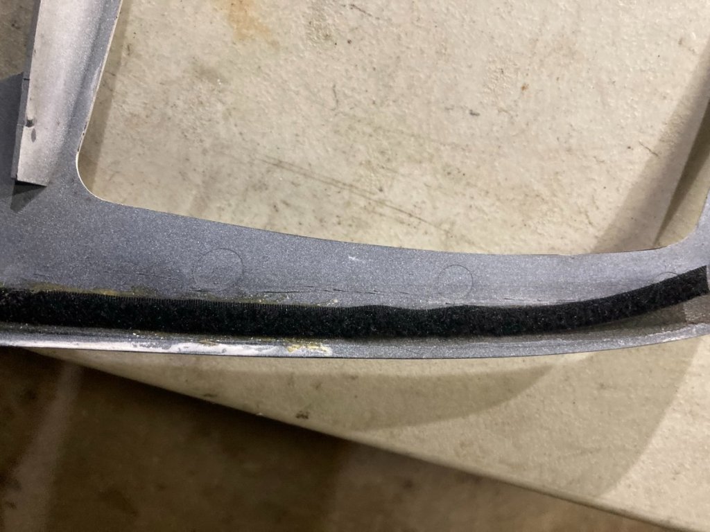

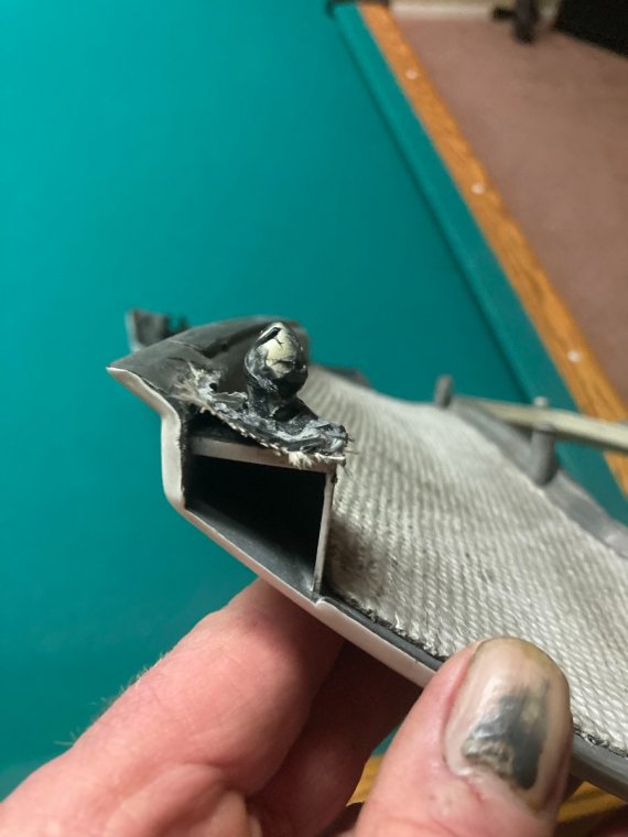

The first shows how I glued one of the pins back on.  I have done this before but it did not last.  This time I wrapped some fiberglass around the epoxy and later sanded things down to a better shape.  I think of it as bandaid.  The next is just a shot of the oil filter cover after sand blasting and painting, then a coat of black paint on the black plastic covers.  I put some velcro behind the headlight cover since something is missing that keeps it snug.  A body man and painter made some other repairs about 6 years ago that are holding up well.  He did the same thing with epoxy and fiberglass.  So far I have had good results with the fiberglass backing on the epoxy.  Pretty much everywhere I have just used the epoxy the repair eventually failed.

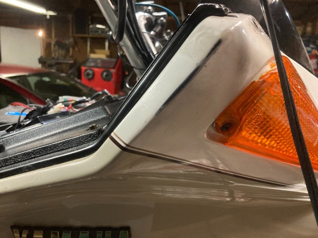

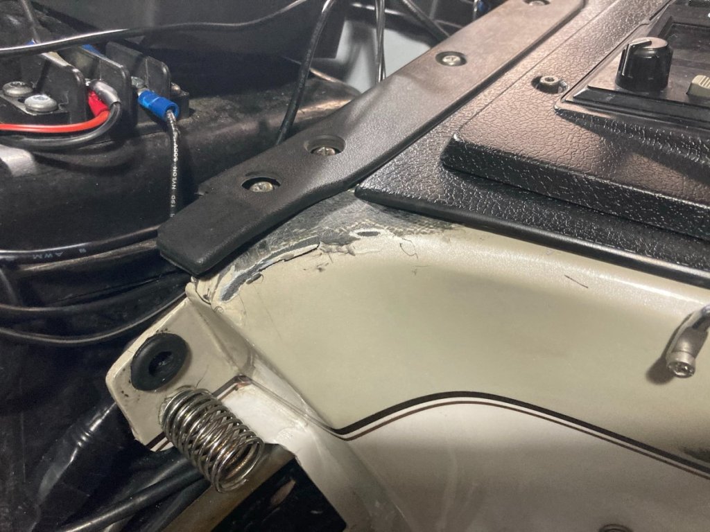

I dropped the bike a couple of years ago and got the upper fairing damage that is so prevalent on most bikes.  I repaired all of the contact points and sanded this scratch down for the painter.  As I mentioned the painting was so expensive that I decided to leave it.  I am now looking for the chrome corner covers you see on most of these bikes.
The saddle bag cover finally flew off a year ago but fortunately it only got superficial scratches.  As with the fairing it was just too expensive to repaint.  I may sand the scratchs down with some 1000 or 1500 paper but only rubbed them out for now.  I guess I am scared to take sand paper to the painted surface even if its very fine grit.
The one larger repair on the fairing that might show is going to get some fingernail polish.  The painter suggested that pearl white is difficult to paint and expensive so he often recommends shopping for touch up paint in the drugstore.

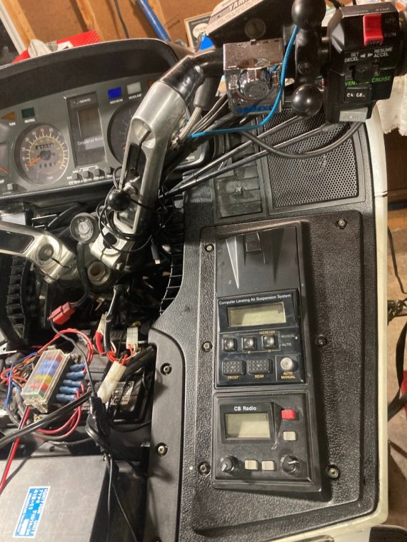

I had to repair many of the holes in the dash panel on the right side since the crashes over the years have opened all of them up.  I did the same thing with the epoxy backed up by a small section of fiberglass.  I tried to level off the glue in the holes with super glue but it did not work as good as I would have liked.  Looking at it now I think it could have just leveled the holes off with epoxy and drilled them down a ways and then put the mounting hole right down the center.  I don't ever expect to find the caps that went in the holes but I am not that concerned.
Hopefully today I get time to put the left side dash back together and mount up some running lights.  I would love to get it all back together today but I suspect that is just wishful thinking.  Especially on Valentines day.

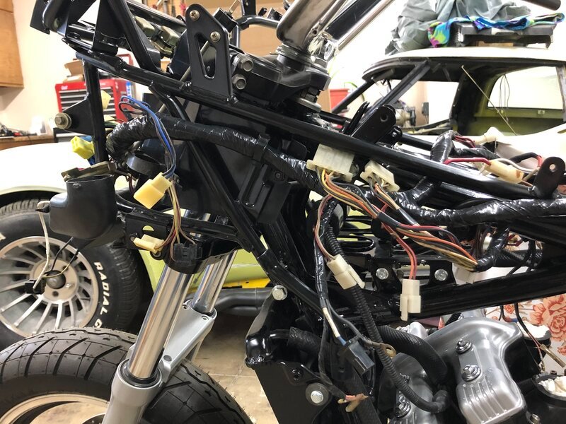

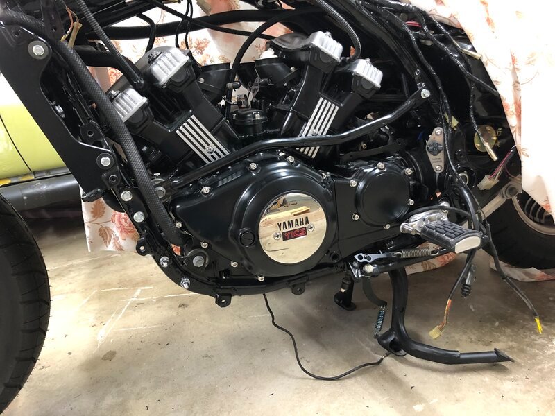

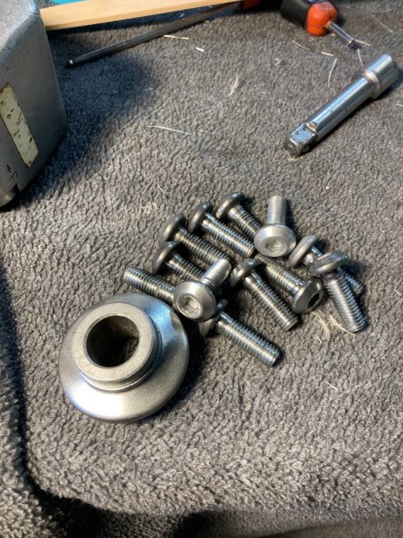

No earth shattering progress this week, but I have a couple of pics to share. I did work on the new wiring harness I purchased.  I spent an evening re-wrapping it only to find out it's for an 84-85 model year. So I decided to stick with the one I have. I worked on fixing the issues with it this afternoon and started to re-wrap it. I am also working on putting the generator coil back in the engine cover. The should be back together this weekend. Here are the two pics for tonight. I'm told it's in the details so even though these are small they needed to be freshened up a little. Not perfect when up close, but much better than before. This is the before and after pic. More to come this weekend.

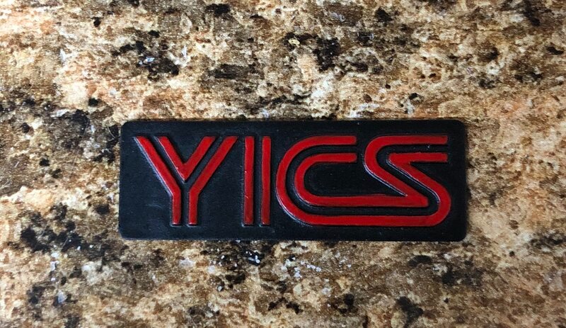

You are definetly getting down to the details.  I did see one that had all the lettering on the dash redone.  It looked good and really made them look brand new.  I made some progress over the last few weeks but also slow.  I have had a nagging air leak on the front tire probably ever since the local shop put the tire on.  I have always changed my own tires but thought I would give the shop some work.  It ended up costing $200 by the time I was done and it was apparent that they did not clean up the rim before putting the tire on.  I have always done that and never had a tire leak around the rim.  This one was and the rim was a mess.  It was probably a little more of a mess because I tired so fix a flat out of desperation last summer.  I spent a little time and cleaned it up to a really nice shinny finish and so far no leaks.  I also bead blasted the rotor bolts and took them to the wire wheel before putting them back on.  I am finally getting close.  Put a new head light plug after buying a new pair of lights from Supperbright.  Turns out I did not need a new light let alone a pair.  I just needed a new plug.  I also wired up a pair of 2 inch led running lights.  I will have to send some photos of that.  They fit under the highway pegs/boards nicely.

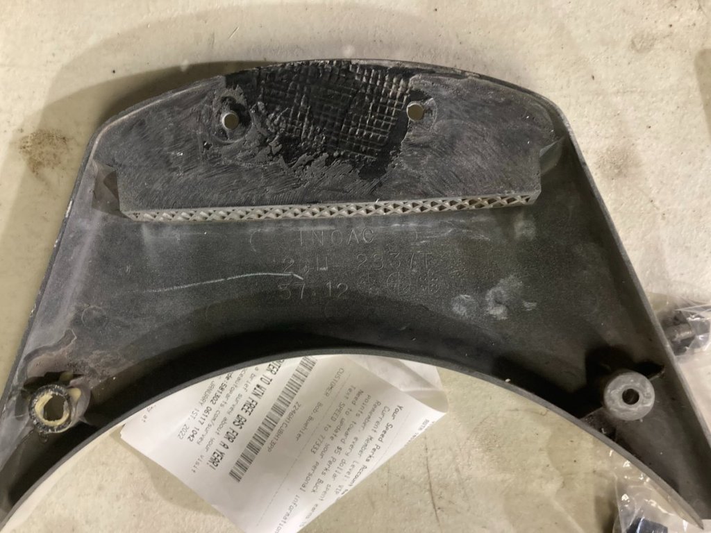

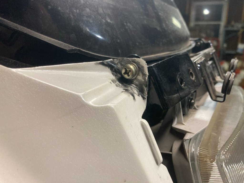

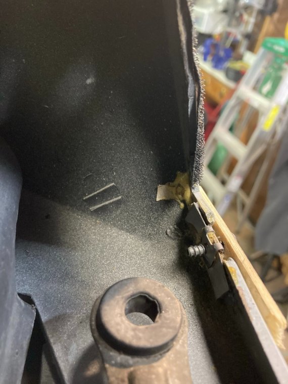

Got close to putting the last parts on and found an old repair had failed.  My headlight cover had one of the fastening locations repaired with a small section of sheet metal glued to the back of the plastic with the clip on it.  Decided to go with epoxy this time instead of the Gorilla glue.  Sanded the plastic back side and bead blasted the metal.  We will have to see if it holds.  I thought the clamping of the glued part in place was rather cleaver.  There are a lot of plastic repairs on this bike.  Maybe a backing of more epoxy and fiberglass would help this one stay in place

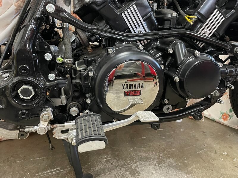

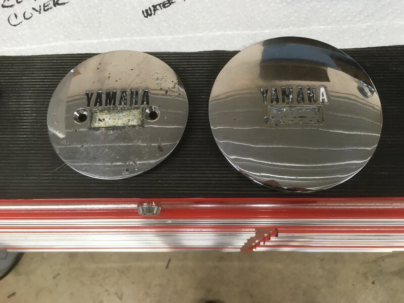

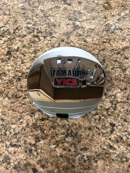

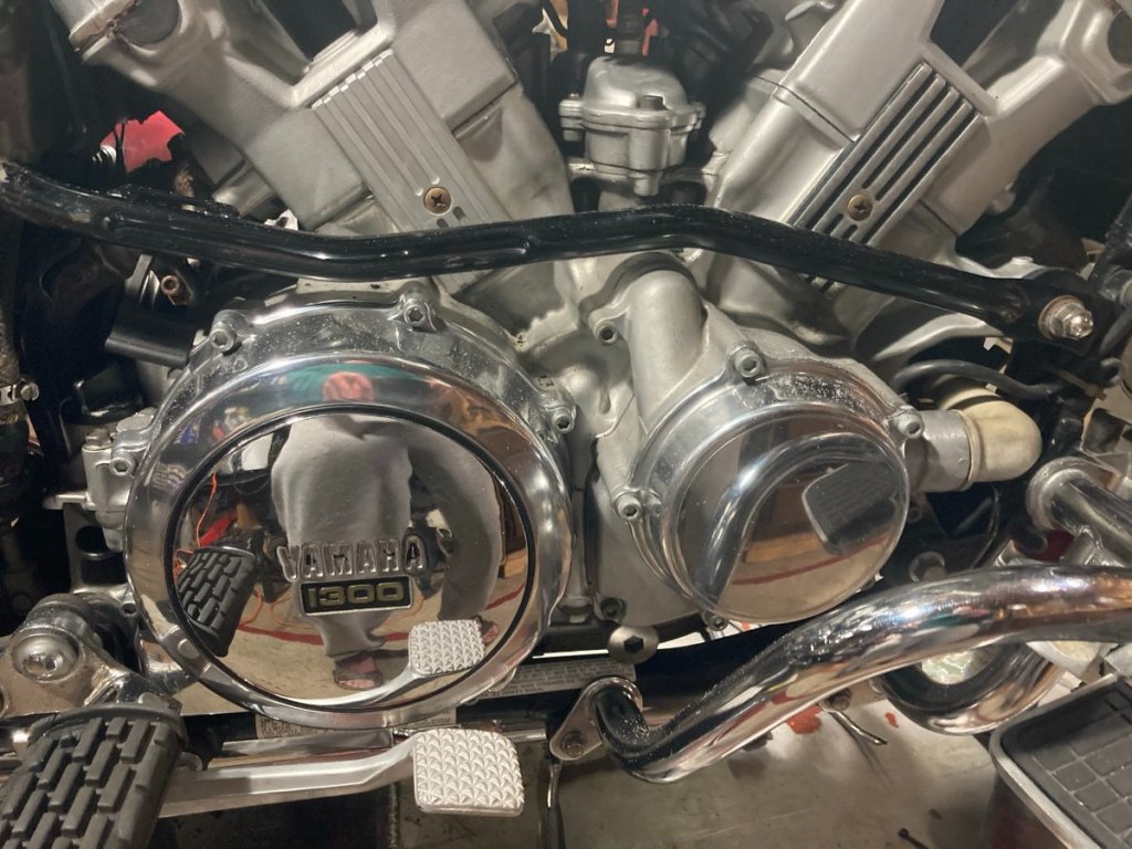

Here is a before picture of the clutch cover plate and the generator cover plate. I sent them out to be stripped and chromed. They turned out really nice, and look great on the black engine.
