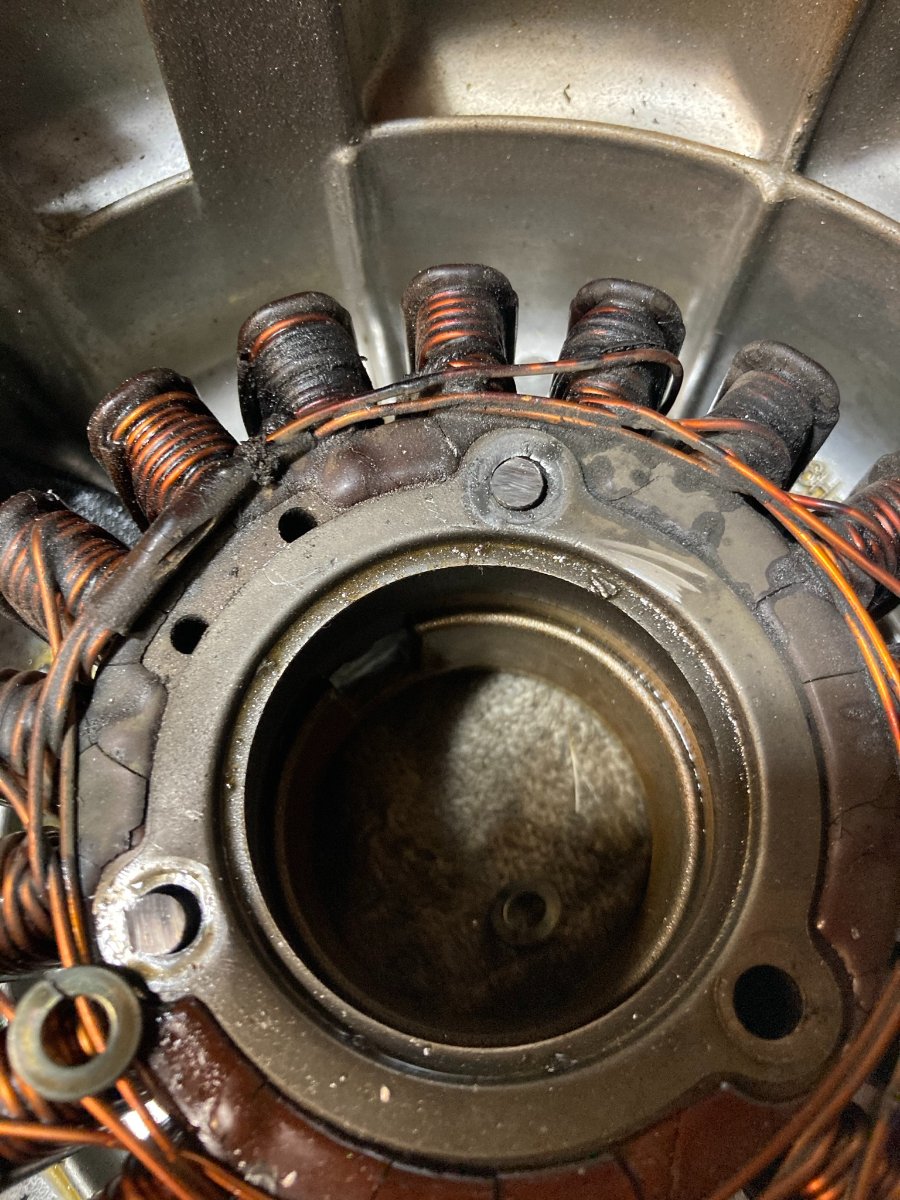

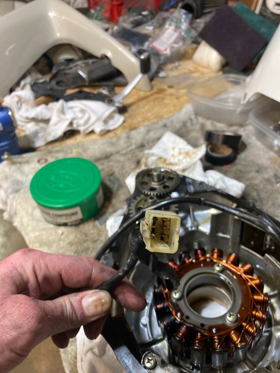

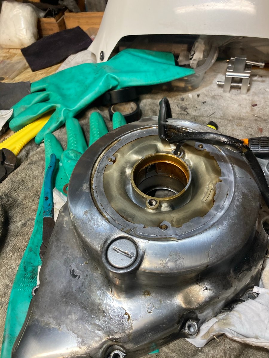

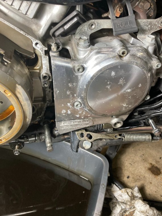

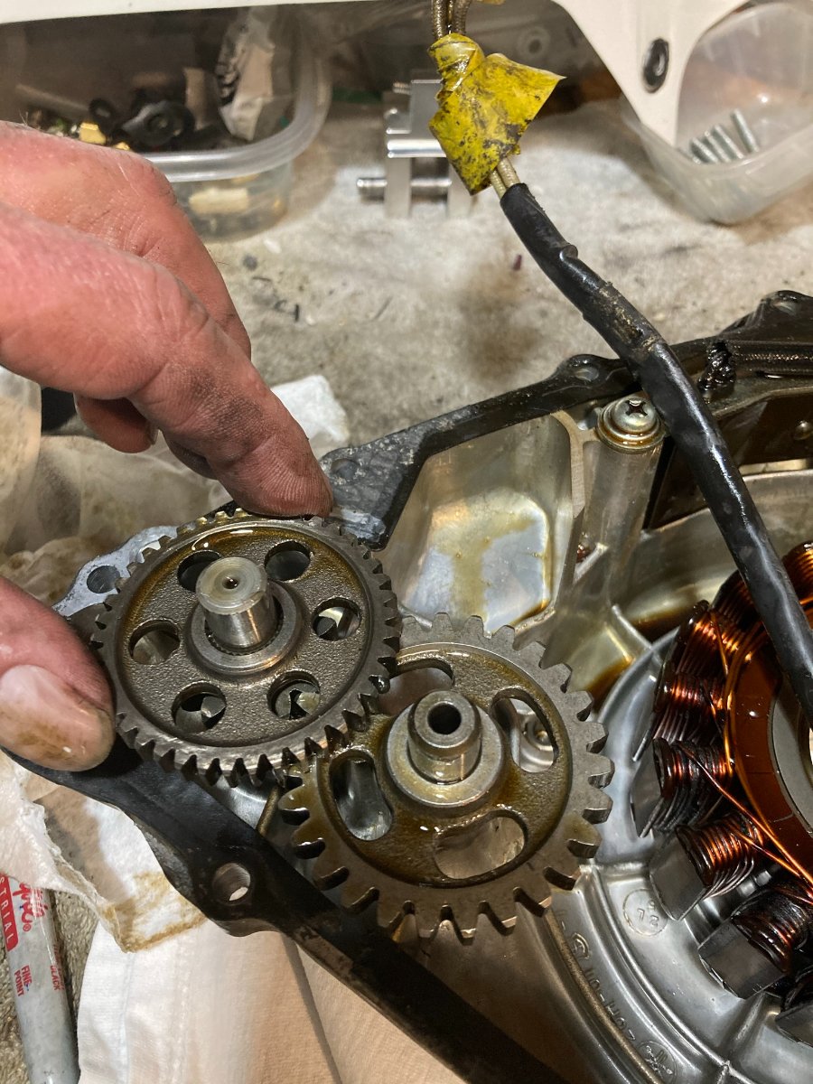

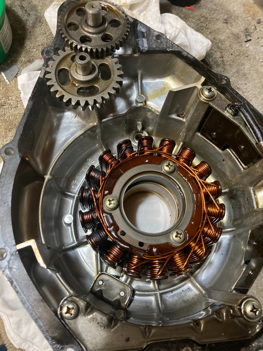

I dug into my stater replacement tonight and learned a few things.  The link to the old tech post http://www.venturers.org/Tech_Library/index.php?action=article&cat_id=001007&id=415 was helpful but need a few notes attached.  First off the wires are now so hard that casing just cracked and were really difficult to get out from behind the middle gear cover.  It is also a mess back there so I am now waiting for a gasket since I think the cover needs to come off just to get the two lead routed properly and the area cleaned and inspected.  My oil leak could be coming from someplace back there or one of the rubber grommets that the wires leave the stater cover through.
Getting the stater cover off after all the bolts are removed was no simple task.  I ended up wedging a screw driver behind the engine stay that leads from the front to the back.  That put it right up against the block.  I then took a tire iron and pried out on the upper rear both housing that has a small tab on it.  It is the only place you can do this.  I took a hair drier to it because my heat gun probably burned out years ago and the torch seemed like a bad idea.
With the middle gear cover off the wires will be free and the stater cover should come off easier.  I had all the gears fall out into the oil pan along with one of the pins.  I also found the gear shift lever just floating around so putting it back in place should be easier with the middle gear cover removed

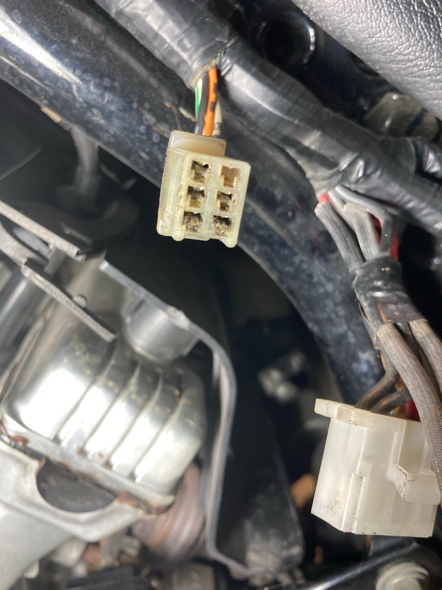

So what ever the other wires are coming out of the cover they are pretty stiff.  I think the six pin plug goes to the Pickup Unit.  The plug looked like it should be replaced (any suggestions where to buy good gang plugs.  There seem to be a bunch out there.
So any suggestions on where to order a gasket.  I think I have used "Cheap Cycle Parts"  Any better ideas.
Last thing is that if you free up the wires by taking the middle gear cover off first it will make pulling the stater cover off easier and maybe some of the gears will stay in place.  I am pretty sure I got them back where they belong.
Forgot the most important point was the stater looked burnt if you ask me.

Yes that stator looks pretty well toasted.
It is a very common oil leak point where the 3 stator wires go thru the rubber grommet. I did not even think it was possible to get the stator cover off without removing the middle gear cover first.
The stator cover is a bit hard to pull off, the magnets in the flywheel are working real hard to hold it on. Careful putting it back on, those same magnets will try to slam it home, even if your finger is still in the way.
Watch which way you put the shift linkage back together, Many do it wrong and then you have to take it all apart again to do it right.
Make sure to use the copper washer on the bottom bolt of the middle gear cover or it WILL leak oil from that bolt.

Well as far as putting the shift linkage back together I assume you are talking about the shift shaft down at the bottom left.  Once the case cover is off it is just flopping around and it is not really apparent how it is supposed to sit.  I am hoping with the middle gear cover off it will be more obvious how that part goes back together.   As far as the little gears go.  Again that is a guess since there is little in the shop manual that I can see.  I looked at the gears and the shafts and the shafts can only go in their respective holes as well as the gears.  The one looks like it can go one either way while the other two are machined and the small one has a lip on one side.  If you don't have it on right it will not line up with the gear next to it.  The larger one that shaft also looks the same on both sides.

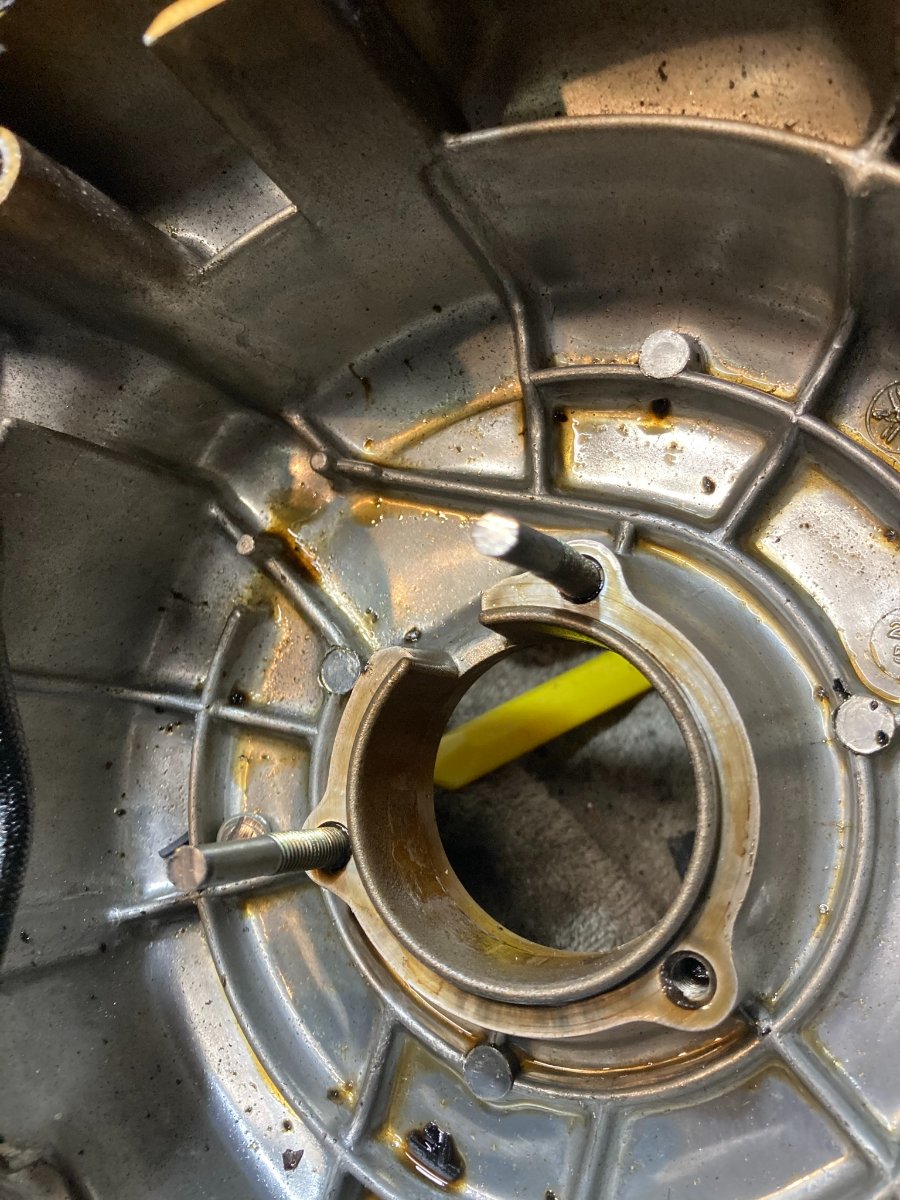

I watched a video on replacing the primary cover on a victory vision and the recommendation was to get some threaded stock, cut 3 inch lengths and thread them into the block.  Then slide the cover on to them and when the magnet sucks it down it will be centered on the threaded stock.  Take the threaded stock out and put the bolts in.  Worked great.  I know because I had to do it three times.  First time was when I put the new clutch in.  The clutch slipped and had to take the Barnett out and put the stock back in.  The third was because I did not have the rubber grommet from the stater wire seated properly.
So anyone have a recommended source for block connectors.  The connector for the pickup coils looks questionable.
Link to post
Share on other sites
I can not help with a a source for the connectors.

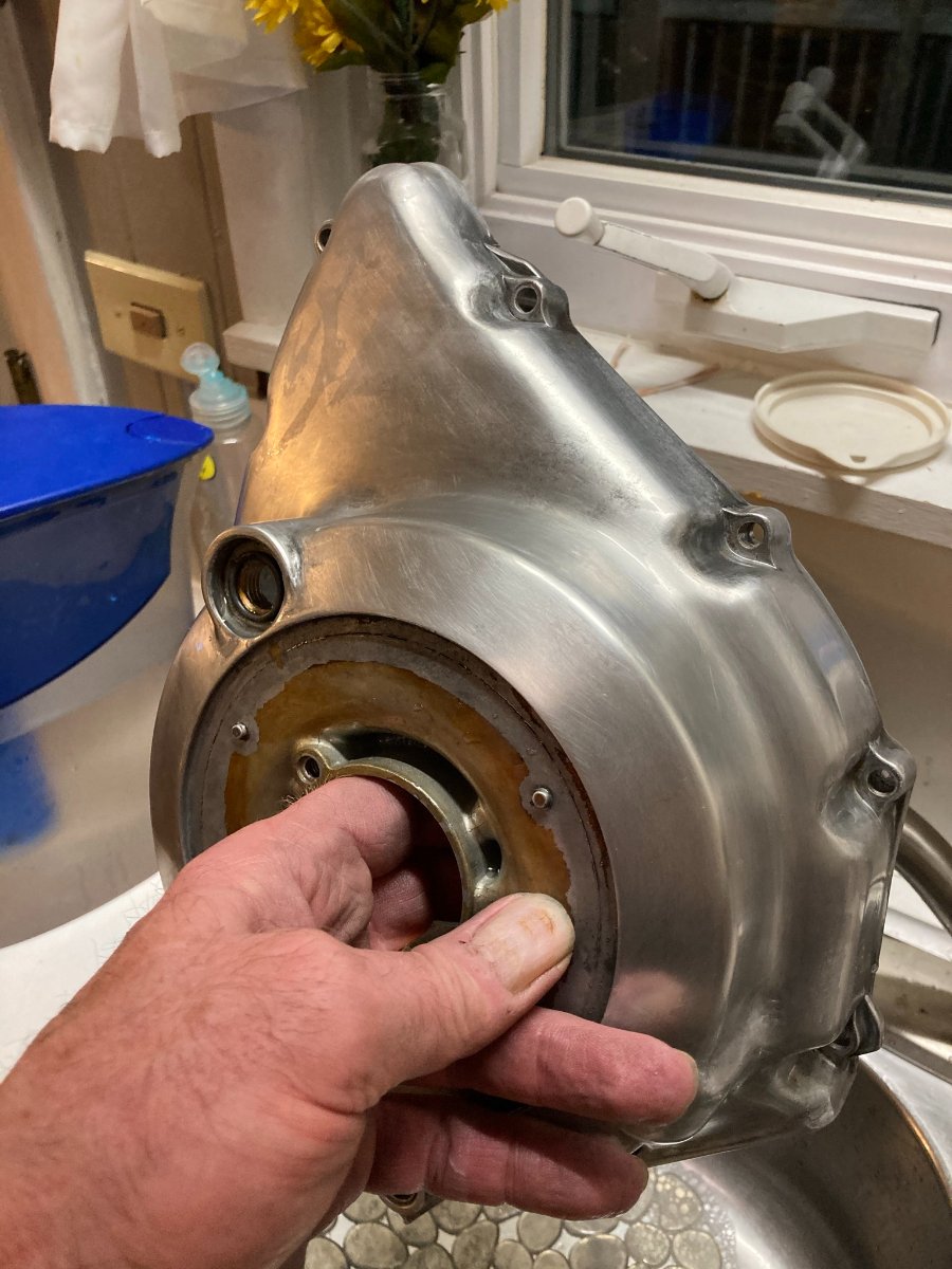

I also started polishing up the covers.  I assume there is a clear coat of paint on them that needs to be sanded off or chemically pealed.  Any experience with this other than 220 grit sand paper.

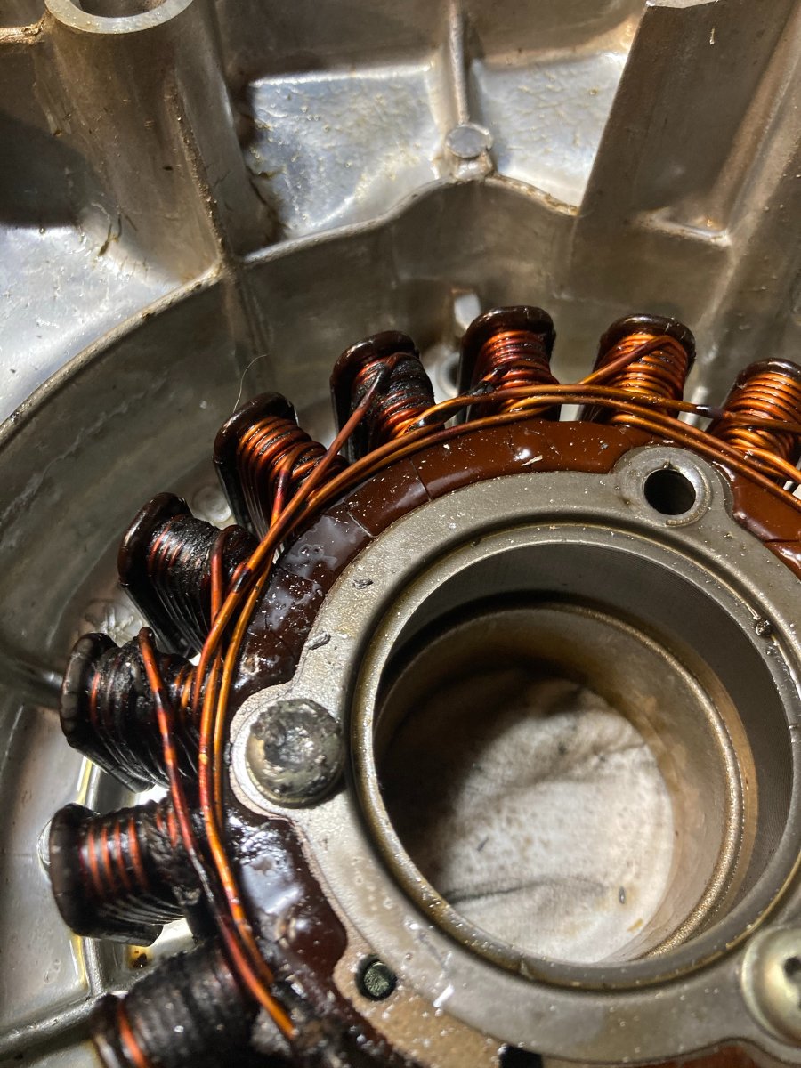

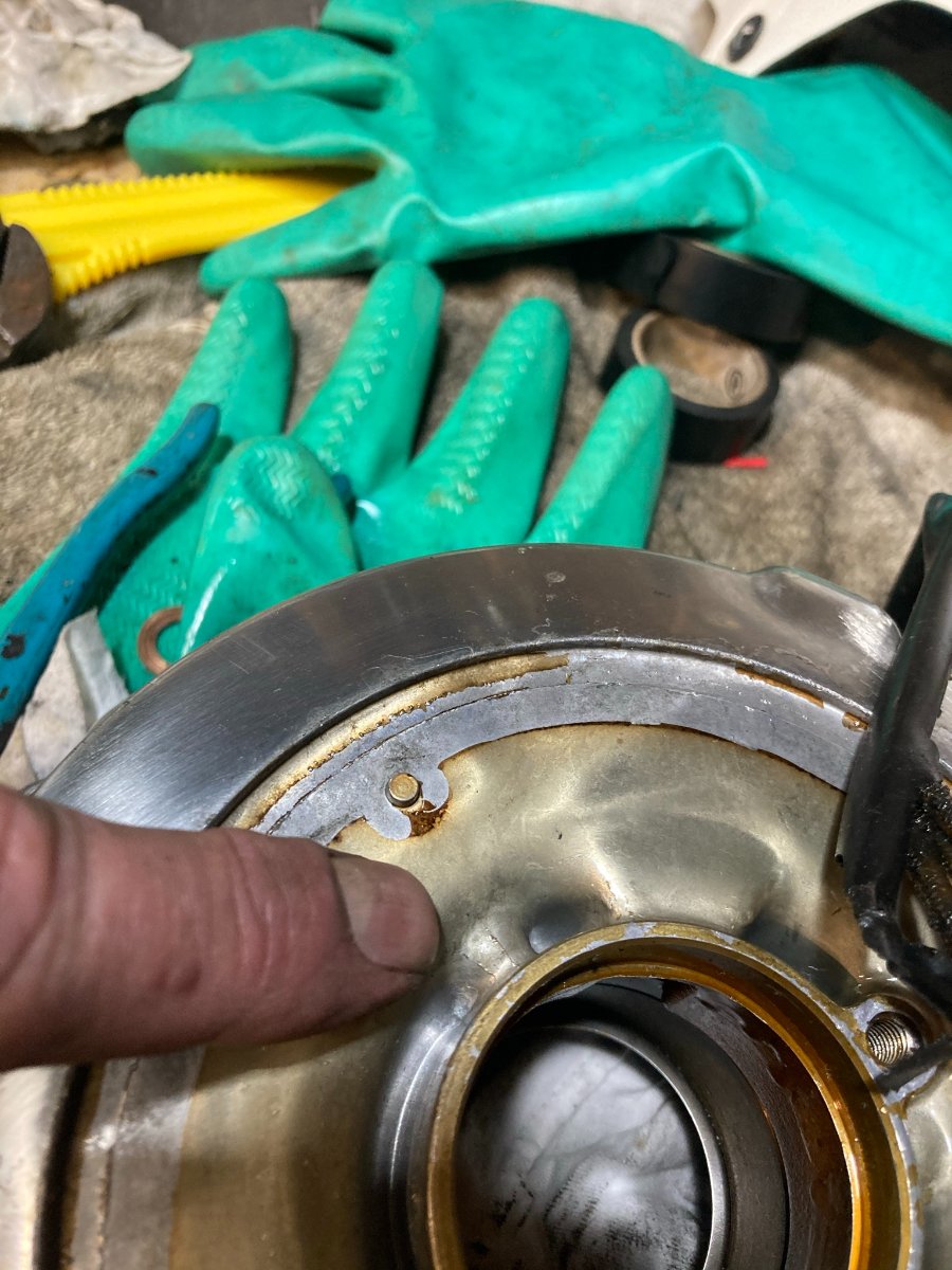

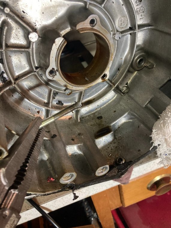

Latest issue:  All the dam screws came out with the impact driver and heat gun.  Not sure if the heat gun is helping.  I know there was discussion regarding how hot you need to get the parts to get locktight to melt.  Will a heat gun do it or do I need to break out the oxy acetylene torch.  I attached some photos.  The one shows the last screw all boogered up.  It is actually out about three turns.  I tried heating it on the back side (see second photo) but I am now worried about twisting it off.  Maybe that would not be so bad since then I could removed the old stater and get heat right on the bolt and hole it is stuck in.  Humm something to think about.  At this point I can try drilling but I don't think that will help much.  So how hot can I get the aluminum case with the torch.  I can get some long nose vice grips on the screw head but it still feels very very tight.  Any ideas.

Loctite lets go at around 400°F, A heat gun is more than hot enough A torch can easily destroy the cover if you are not super careful. Steel will start to glow long before it melts or even softens. Aluminum gives no such warning, it will go from fine to a liquid silvery puddle on the floor in a split second, no warning whatsoever. Unless you really know what you are doing and have a way to monitor the aluminum temperature keep all torches away from it. Even a good head gun CAN melt aluminum it you get real aggressive with it. But you almost have to try to melt AL with a heat gun.
As @cowpuc mentioned sometimes you have to go back in a bit before you can come out any further.
Soak it in penetrating oil for a while and then heat it up.
Worst case cut the head off the screw and that will let you remove the old stator, at this point it is easier to heat the screw boss to get the loctite to release and there will be a nice long screw to get a grip on with vice grips.

The more I think about it, cutting off the head and pulling the old stater off is the way to go.  I can see the problem is the threads are well below the screw head so heating from above is probably doing very little to heat the area of the case where the bolt is threaded into.  Probably a big air gap.  Those screws are like 2 inches.  Ever other one came out tight but they did get better as they came out.  Not this one.  I think getting a couple of nuts on the remaining threads will give me something to turn once I get it warmed up.  I will keep you all updated.
By the way I do think both covers will polish up nice once I get what ever clear coat is on there.  I worked on middle gear cover last night and it is ready for the buffing wheel.  I really wanted to get that stater off so I could get started on that cover.  Never expected to hit this road block.  I find myself telling the wife things like "so far so good, at least everything came apart"  Now I remember why I say that.  All it takes is one 30 year old fastener.  I am sure this part has never been apart since I bought the bike with only 1200 miles on in 1990.  It is an 88.
Link to post
Got to work tonight on those pesky bolts.  Cut the heads off and pulled the stater.  Took the heat gun to them for a good long time before they loosened up enough to turn out.  Simple job gone sideways.  Then spent an hour with the heat gun working the gasket off.  I have not had to do that in 30 years.  Nothing like a 30 year old gasket.
