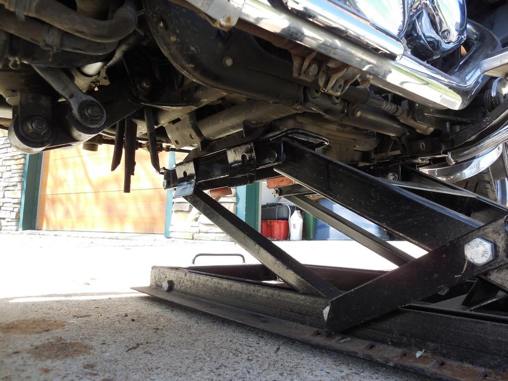

I bought a used rear link set for my 99, did some fix'n, then installed the now 6mm shorter links. To shorten the links I migged the existing holes shut, built up the sides of the bolt area, ground it back to the right shape and drilled new holes. Pulled the pins and greased while I had things apart This bike is low miles 16K on a 99, everything looked good, made my own lift adapter, it works good, a small jack at the back let me move the rear just enough to make link remove install easy peasy. Before and after measurements say the 6mm link shorten raised the rear of the mufflers by 20mm. or 3/4".
Got on and rode 110 miles, I like it! Turn in is effortless, holds a line through the corner, but is easy to pick a new line, tighten or straighten. Saw 90MPH, ride is stable, turning, changing the line is easier but not weird or darty. Will have to get in a day of strong cross winds see how it is in nasty conditions.

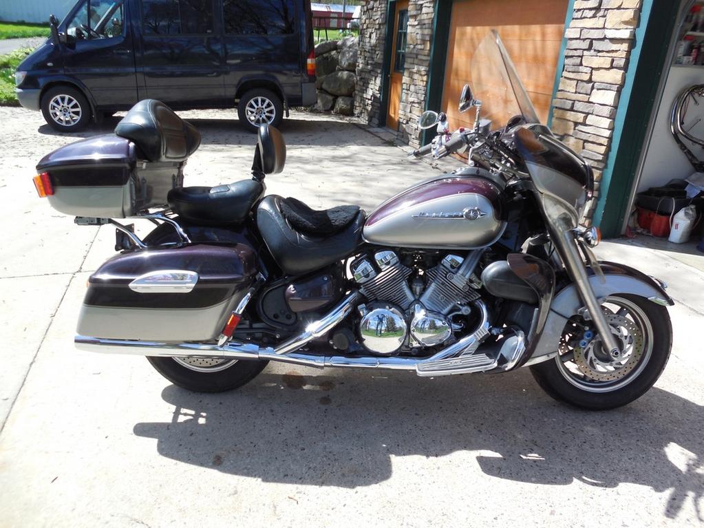

I got in a 14mm front MC today, so the last piece of my front end work is up next. Already have FJR13 calipers, stainless steel lines new pads, fresh fork oil, new taper steering bearings, done. It's rolling on fresh 130/80 front, stock size rear Shinko HD tires.
My cruise is out of action, I'm getting two flashes of the green yellow lights, hope I just missed a connection when the fairing was off.
First long ride with the new Bakup backrest. The pad was as low as it would go but still too high up my back and I'm 6'3" with a pad on the stock seat. So the hack saw and drill press got it lowered a strong inch. We'll see if that's enough.
