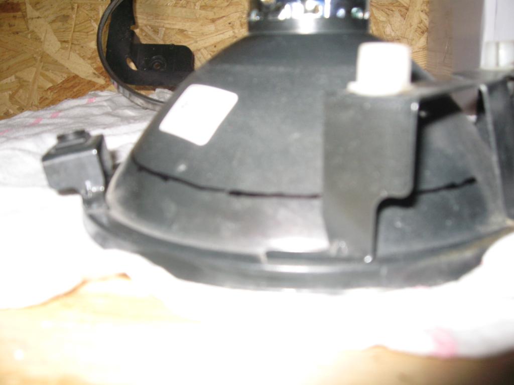

sfcrader Posted May 23, 2016 Share #1 Posted May 23, 2016 Changing the headlamp to a LED headlamp: Just waiting for my package to arrive. Was able to acquire a 2009 broken headlamp assembly for 25.00. Followed instruction found here http://www.venturerider.org/forum/showthread.php?498-Headlamp-Replacement and http://venture.eurekaboy.com/headlightmod.htm about removing the broken lens. I will post before, during, and after pic. Link to comment Share on other sites More sharing options...

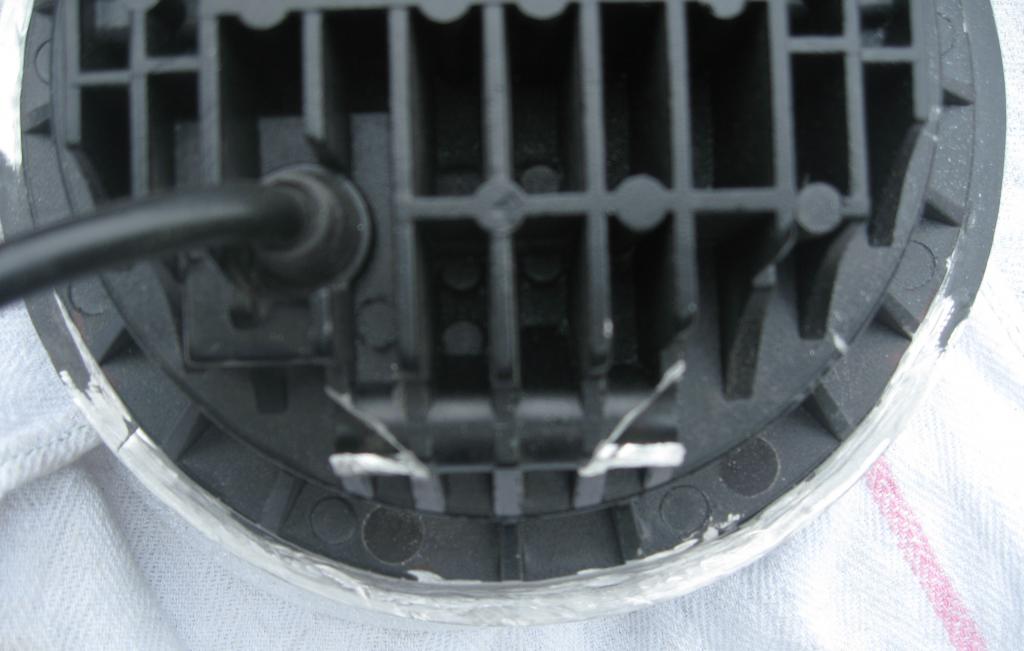

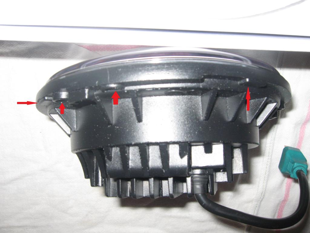

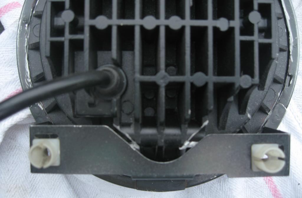

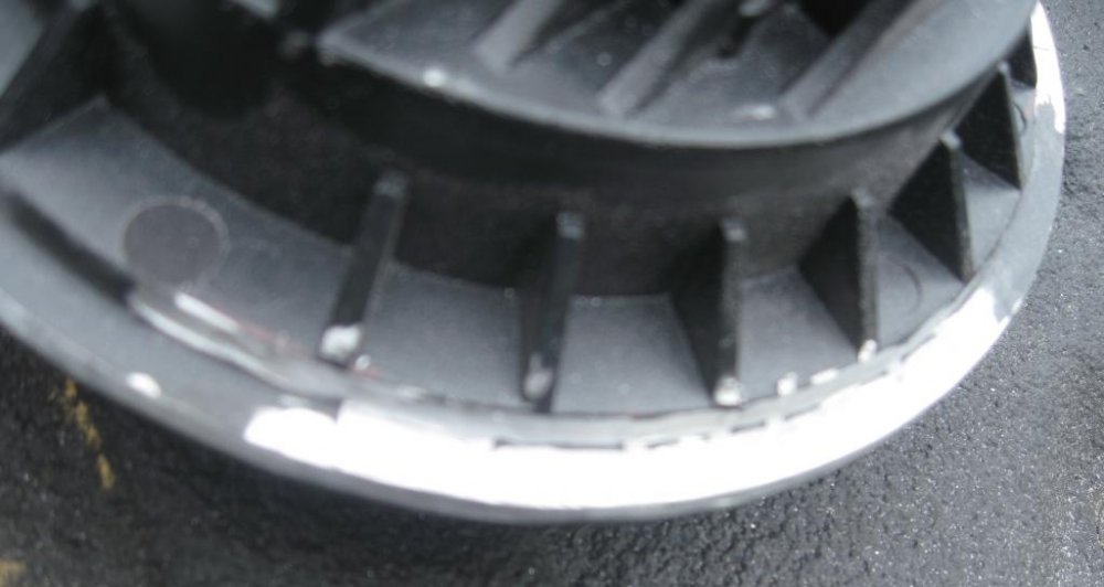

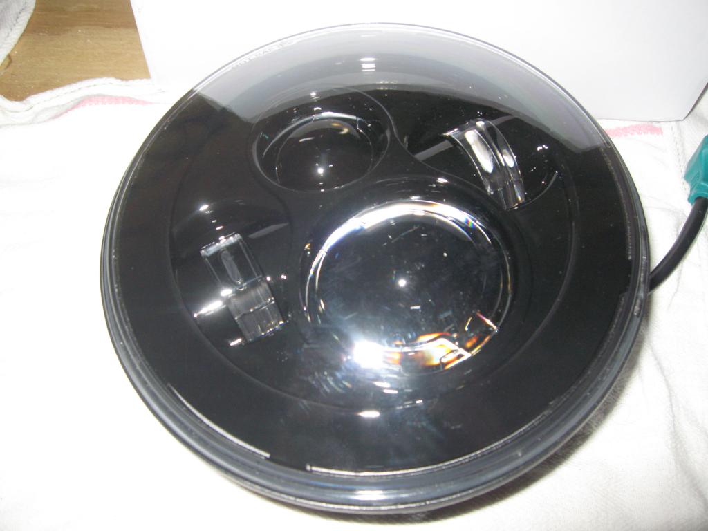

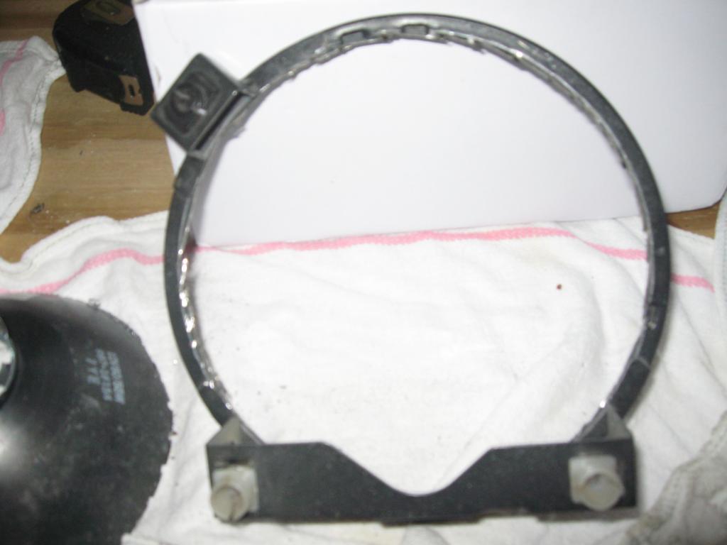

sfcrader Posted May 27, 2016 Author Share #5 Posted May 27, 2016 I received the lamp yesterday: Started the mod on the old headlamp frame: After the first cut I did a quick look and test fit, come to find out need to cut more. Was trying to keep as much of the old housing as possible: After some cleaning a round the the cut edges, I did another test fits and I will need to remove some tabs on the led lamp a total of 9 tabs: Need to go shopping for more grinding wheels for my Dremel: Link to comment Share on other sites More sharing options...

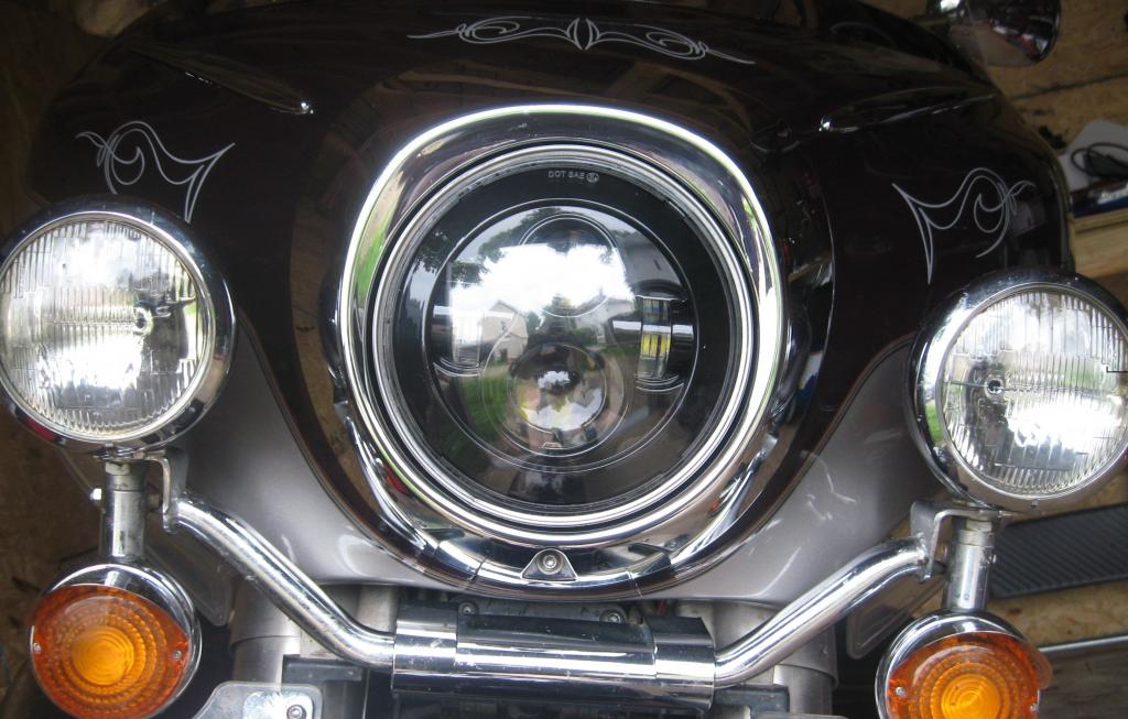

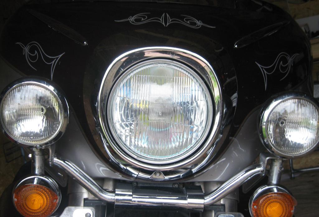

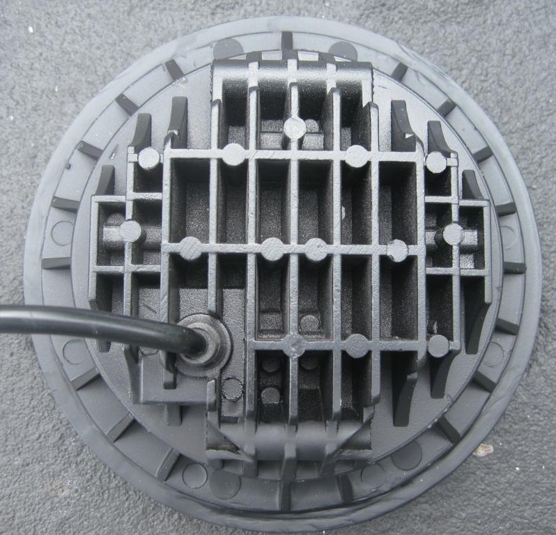

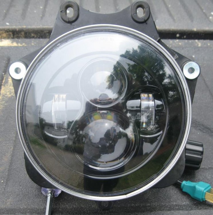

sfcrader Posted May 29, 2016 Author Share #6 Posted May 29, 2016 Everything finally got done today and installed on the girl again. Tabs grounded down smooth: Test fitting to make sure everything fits: Time to paint the back and the mounting hardware: Led light attached to the mounting bracket: The girls front before and after. I really look the the new look. Next will be LED passing lamps. Link to comment Share on other sites More sharing options...

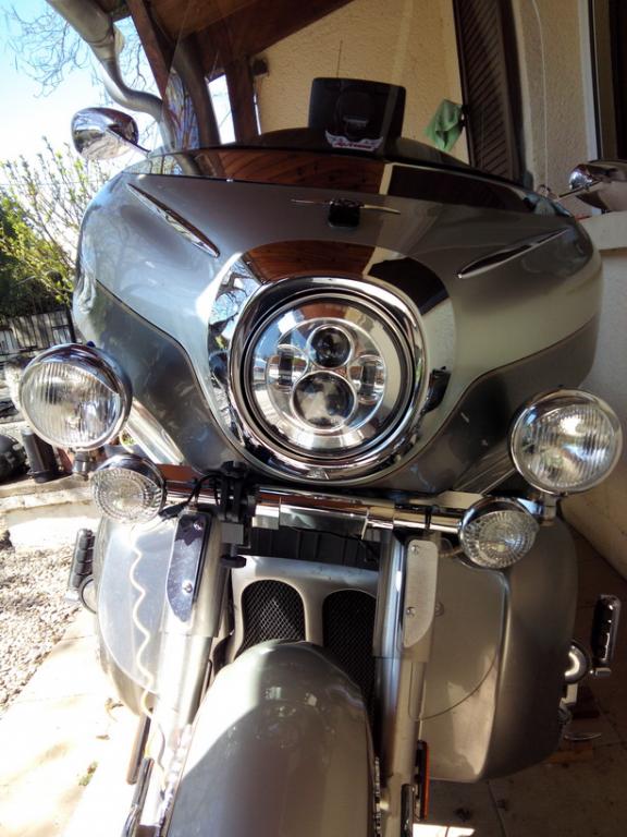

ChrisFrench Posted May 30, 2016 Share #10 Posted May 30, 2016 I also made the transformation Link to comment Share on other sites More sharing options...

sfcrader Posted May 31, 2016 Author Share #16 Posted May 31, 2016 Took a early morning ride today and love the output, every sigle car that passed flashed me. LOL Glad I did this change, now I am going to do the passing lamps. I got mine from ebay:http://www.ebay.com/itm/7-MOTORCYCLE-BLACK-PROJECTOR-DAYMAKER-HID-LED-LIGHT-BULB-HEADLIGHT-For-Harley-/161879974964?hash=item25b0cc6434:g:uiAAAOSwBahVSCEm&vxp=mtr How do you like the low/high beam output from it? Do you have a link on where you got it? Link to comment Share on other sites More sharing options...
sfcrader Posted May 31, 2016 Author Share #17 Posted May 31, 2016 Took a early morning ride to work and just love the output of the new light, every car flashed me. LOL I am glad I did this change, now I am going to replace my passing lamps. The light itself is much whiter and brighter than what I had before, it that illuminates the rode mush better and even along the sides of the rode. http://www.ebay.com/itm/7-MOTORCYCLE-BLACK-PROJECTOR-DAYMAKER-HID-LED-LIGHT-BULB-HEADLIGHT-For-Harley-/161879974964?hash=item25b0cc6434:g:uiAAAOSwBahVSCEm&vxp=mtr How do you like the low/high beam output from it? Do you have a link on where you got it? Link to comment Share on other sites More sharing options...

Flyinfool Posted May 31, 2016 Share #19 Posted May 31, 2016 If every single car flashed you, that is not a good thing. That is a very bad thing. First thing you must do is to aim that light correctly. If the beams cut off is so bad that it can not be aimed correctly, then it should not be used. Brightness does not blind oncoming drivers, poor aiming will. Do you really want to be blinding something that is coming at you with a closing speed of over 100MPH and is way heavier than you. Most people when being blinded by bright lights close their eyes and hope for the best, it is the natural reaction of the eyes to protect themselves, not to mention that you just wiped out their night vision so they will be blinded for a few minutes whiles their eyes readjust. I have never yet changed a headlight and not had to make some adjustment to the aiming. My truck has over 300 watts of HID lighting which is many times brighter than your LEDs and I have never been flashed, but I took the time to aim them all correctly. Sorry for the rant, improperly aimed lights are a pet peeve. Please, if you are going to do it, do it right. If you are going to at Dons MD I will be happy to help you get the aim correct. 1 Link to comment Share on other sites More sharing options...
sfcrader Posted June 1, 2016 Author Share #20 Posted June 1, 2016 Yes I truly agree with statement, and I was adjusting the headlamp last night and even this morning. When I put everything back together I attached the the brackets using the same numbers of turn as when I removed it. If every single car flashed you, that is not a good thing. That is a very bad thing. First thing you must do is to aim that light correctly. If the beams cut off is so bad that it can not be aimed correctly, then it should not be used. Brightness does not blind oncoming drivers, poor aiming will. Do you really want to be blinding something that is coming at you with a closing speed of over 100MPH and is way heavier than you. Most people when being blinded by bright lights close their eyes and hope for the best, it is the natural reaction of the eyes to protect themselves, not to mention that you just wiped out their night vision so they will be blinded for a few minutes whiles their eyes readjust. I have never yet changed a headlight and not had to make some adjustment to the aiming. My truck has over 300 watts of HID lighting which is many times brighter than your LEDs and I have never been flashed, but I took the time to aim them all correctly. Sorry for the rant, improperly aimed lights are a pet peeve. Please, if you are going to do it, do it right. If you are going to at Dons MD I will be happy to help you get the aim correct. Link to comment Share on other sites More sharing options...
