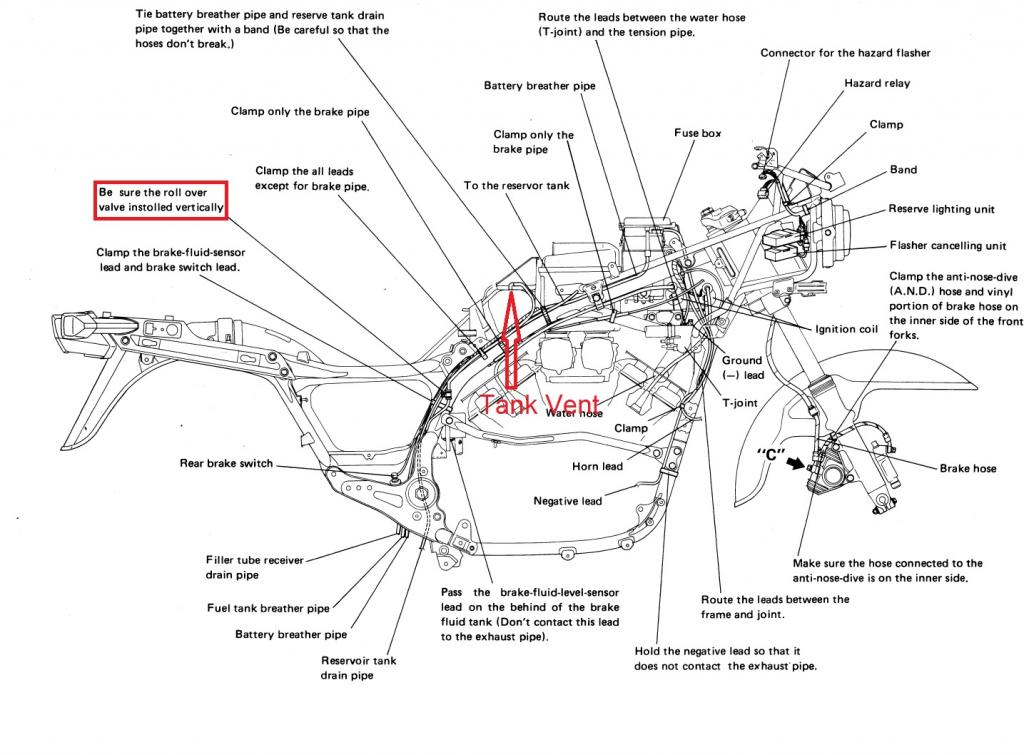

Does anyone know the location of the gas tank vent...where it is located and where the tube runs???....I filled the tank to the brim last night for a long ride...wondering if the tank is not venting, and i'm getting a type of vapor/ vaccum lock?
Link to comment
Share on other sites
The fuel tank vent on the 1984 is a hose connected to an elbow to the right of the fuel filler. In line with hose is a rollover valve. Remove the right sidecover to examine or orient the rollover valve. The rollover valve is a check valve, intended to prevent fuel from escaping in the event of a "rollover" or tip over. The check valve has been known to stick. At least one time, the operator reported that he overfilled the fuel tank. The check valve prevented the fuel from running onto the ground but it also allowed a sufficient "head" of fuel over the check valve that the tank could not vent properly. The hose exits in front of the rear tire (along with the carb vents/overflow).

Hey Chocking,, sure as beans sounds like the one way valve in the tank vent went on vacation.. Last time I had that happen it was while traveling cross country on a beat up old Venture I pulled the right side cover (opposite side of fuel pump location) removed the one way valve sitting right on the down spar of the frame, took the body of Bic Ink Pen (white plastic tubing) and spliced the hoses together - WORKED AWESOME and kept us from dieing in the desert :big-grin-emoticon:..
Could also be a plugged petcock...
Speaking of plugged petcocks,, you ever pull the cover that the sending unit that hangs down into the fuel tank is attached to and look into your tank? If its not the tank vent and ends up being a petcock problem - pull that cover (its under the seat) and take a peek - may have a bunch of stuff in your tank causing issues..
