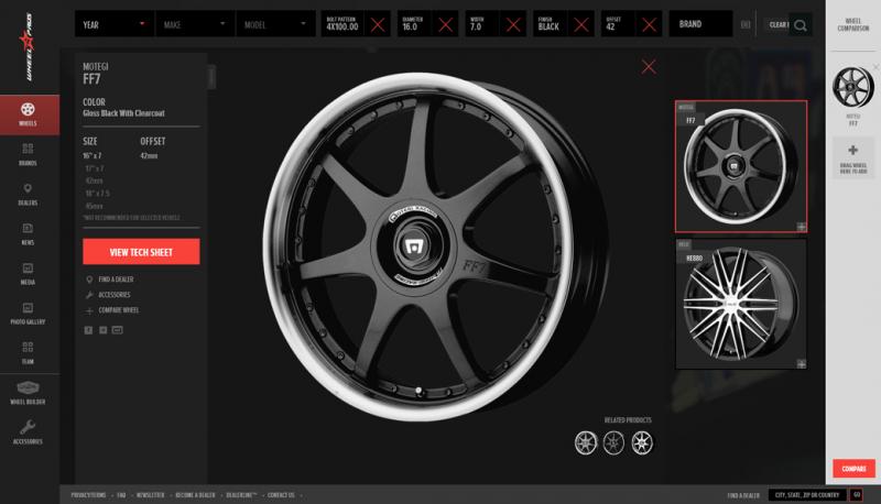

alwrmcusn Posted May 6, 2015 Author Share #10 Posted May 6, 2015 John at Hannigan gave me the specs I needed and a link to wheelpros.com. I filled in the info and came up with four choices (if I remember correctly it was four). The Metegi FF7 in black were the ones I thought would look best on my 2009 RSV. Link to comment Share on other sites More sharing options...

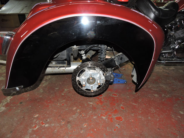

alwrmcusn Posted May 13, 2015 Author Share #13 Posted May 13, 2015 Re-bled the brakes again this afternoon while the original wheels were off to install the new wheels. DEFINITELY easier to get to the rear brake calipers with the wheels off. However, re-bleeding did NOT fix the problem. I still need to about 3 outta 4 times braking do a quick pump on the rear brakes. I'm hearing that a new master cylinder might be a fix. Here's the trike with the new Metegi FF7 wheels installed with new Nexen tires also. The old OEM wheels and tires that were part of the Hannigan installation are now for sale if anyone needs them. The tires are still in pretty fair shape and should get another years wear! Link to comment Share on other sites More sharing options...

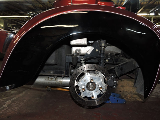

alwrmcusn Posted May 21, 2015 Author Share #22 Posted May 21, 2015 Wow! Major update to this thread. The dealer did the master cylinder kit install yesterday which of course required yet another brake bleed (full flush?). When he was putting the wheels back on, one of the techs asked the other if there was a flange nut on the axle on his side. There was not! I have no idea when or how long that axle flange nut has been missing. The trike has not exhibited any handling problems but the entire right rear wheel/brake/rotor was in danger of coming off. The tech contacted Jim Gooch at Hannigan, explained everything, and was told to inspect the wheel bearings that they would most likely need replaced. The tech did, they do, and so he has ordered all the parts. Hopefully it will be ready on Friday. I'm scheduled for a Memorial Day event at Dollywood on Monday. I keep having visions of doing about 75 down I-40 and having that assembly suddenly detach. Scrape me up and pour me in a bag! Link to comment Share on other sites More sharing options...
