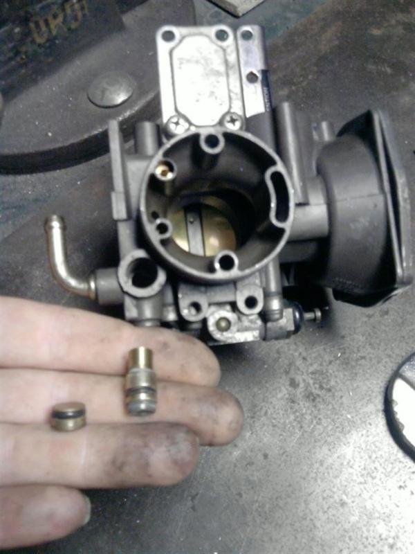

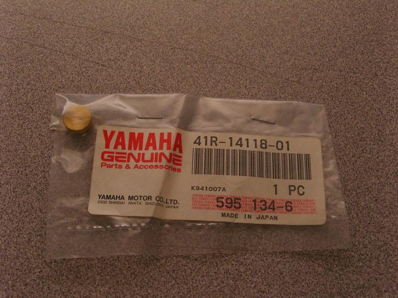

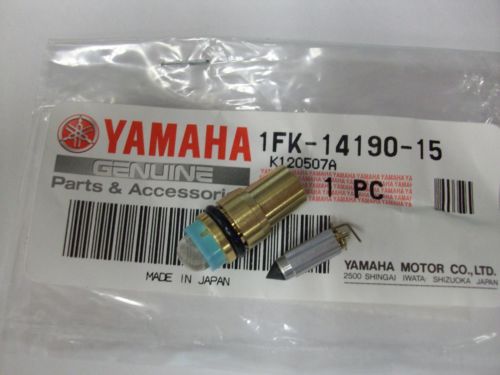

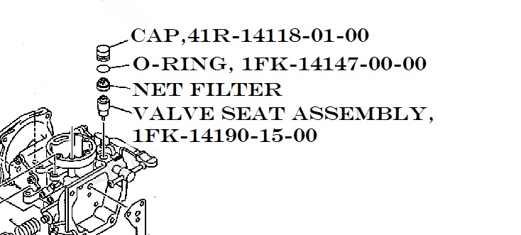

But, to remove the float valve seat, one must remove the aluminum plug (Yamaha calls it a "cap") that is staked to the carb body. This plug also has an O-ring, and depending on how you remove this plug, the plug and its O-ring may require replacement as well. The retaining plug part number is 41R-14118-01-00. The part number for retaining plug O-ring is 1FK-14147-00-00.
Float valve Retaining Cap, 41R-14118-​01-00.jpgFloat valve RetainingCap, 41R-14118-​01-00.jpgFloat valve assembly part numbers.jpg
Edited by Prairiehammer

Yes.

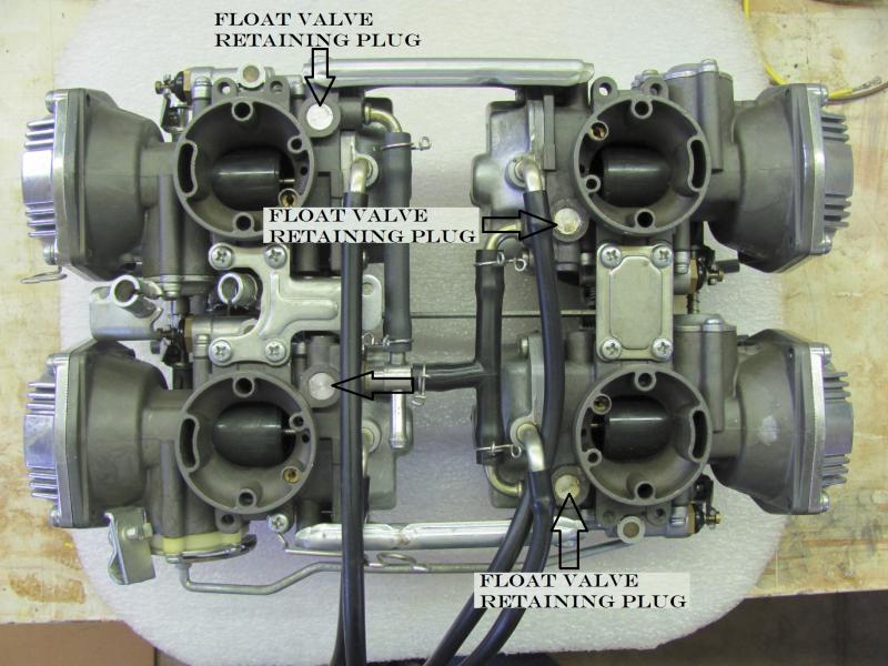

I have my carbs off now and was trying to figure out how to get these plug's out, it seems like the only way is to destroy them. Does anyone know how to remove these plugs, I'm sure my seats are toast, but I don't want to drill them out as it seems the only way to do it to me

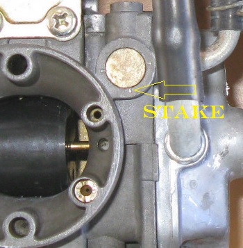

The caps may be 'staked' like this:
Float Valve Retaining Cap Stakes.jpg If so, try to remove or mitigate the protrusions that help to hold the cap in the carb body. Then using a punch, drive the float valve seat out. The valve seat should push the cap out as the seat is driven out. The net filter will be squashed, but the new float valve assembly should include a new one.

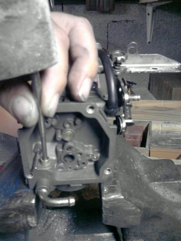

Here's how to drive the valve seat out:

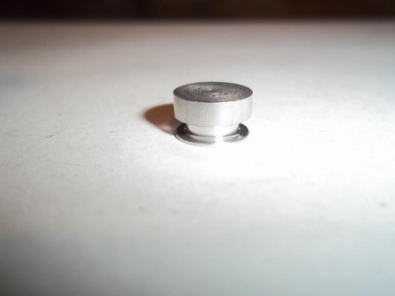

I have a non OEM kit and it doesn't have a screen. Similar to this one.
4X 86 07 VMAX Carb Kits VMX1200 V Max 83 93 XVZ13 Venture Venture Royale | eBay
This will fix the overflowing problem. What about the flooding and the fuel pooling on top of the butterfly valves?
Also I have fuel squirting out of the hole to the left or right of the caps when the bike stops running.
On eBay there are a few sellers offering the net filter (PN. 1J7-14994-00-00), albeit the filter is not cheap. I would think you could reshape the deformed screen and reuse it, provided the plastic collar is intact.
IF the flooding and pooling is the result of a too high fuel level in the float bowl and IF the too high fuel level is a result of fuel leaking past the float valve seat, then replacing the float valve seat, needle valve and O-ring should fix the flooding. If, however the fuel level is NOT out of spec, then you should investigate some of the other causes for the flooding, ie. jet block rubber plugs shrunken or improperly vented bowl or main nozzle worn into an oval shape. Have you checked the float bowl fuel level?
