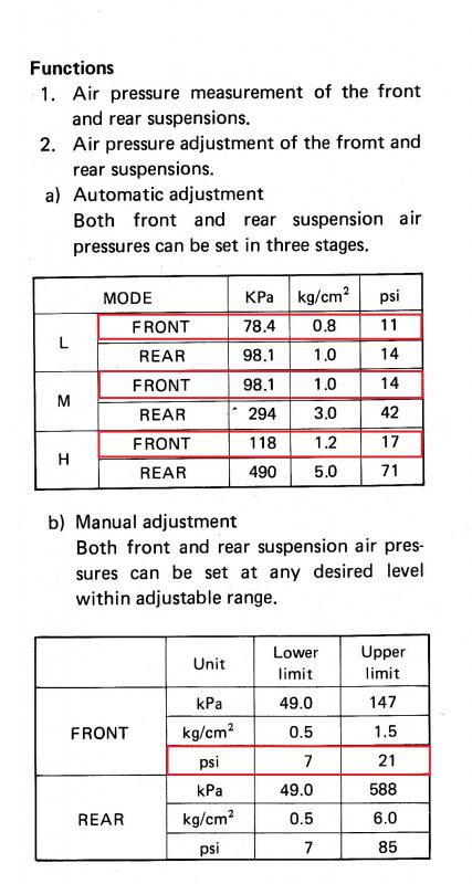

Glenn, the stock Venture Royale CLASS had manual settings and automatic settings for Low, Medium, High. Depressing the Auto Low button resulted in 11 psi for the front forks. Auto Medium equaled 14 psi and Auto High translated to 17 psi. Considering that the Venture trike weighs substantially more than the stock Venture, I would probably use 17 psi on your forks to prevent bottoming. Paul is incorrect when he says not to use more than 8 psi on the forks. Yamaha recommends a minimum of 11 psi and a maximum of 17 psi.

A snippet from the Yamaha Service Manual:
Note that the maximum (manually adjusted) is even more at 21 psi.
Unless you replace the front stock (undoubtedly fatigued) springs with Progressive®, I would experiment with the higher pressures. The OEM front forks are notorious for bottoming out when too little air is used. In your situation, I would consider using Progressive springs AND air.
[ATTACH=CONFIG]95682[/ATTACH]

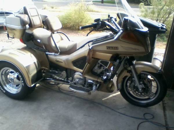

And some pictures, in case anyone is interested.
[ATTACH=CONFIG]95618[/ATTACH]
[ATTACH=CONFIG]95619[/ATTACH]
Nice bike! Finally!! A 1st Gen. I could ride! I'm too short for the 2 wheel stock version, darn it!
