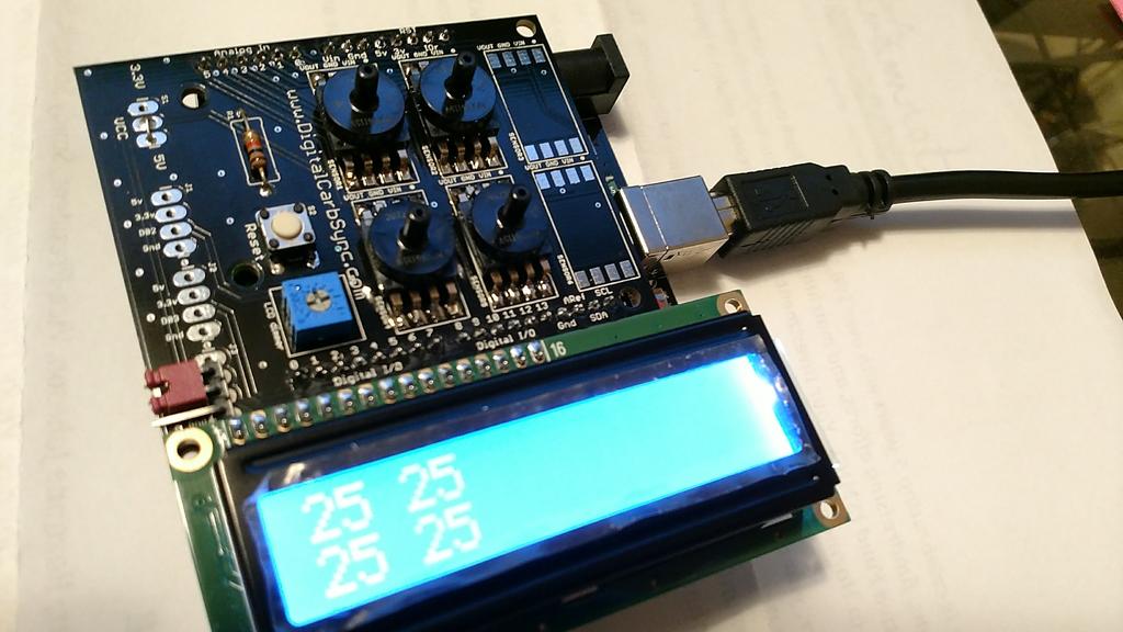

videoarizona Posted November 28, 2017 Share #78 Posted November 28, 2017 VideoArizona, Your processor arrived and is loaded. http://www.venturerider.org/forum/attachment.php?attachmentid=110961 Hi Tom, I re-directed the address of the sync board from Phx to my Green Valley home as I came down here unexpectedly. My sync board came in today. I want to thank you for the great job you did on making the sync board for me! Looks like a "PRO" did the work! I would say you are very good at building electronic stuff! Again, my thanks for your efforts! And if anyone wants an electronic digital sync board for their Ventures, I highly recommend Tom and his board! david Link to comment Share on other sites More sharing options...
tz89 Posted November 28, 2017 Author Share #79 Posted November 28, 2017 (edited) Thanks. Since I loaded the newest test version of the software, I added a jumper and header to act as a switch to turn on (default) or off the self-calibration step. You should leave it on, but some board builds display better with it off. Use whatever looks best to you. The simple math in the calibration can introduce rounding errors because the display has whole numbers only due to space restrictions. I turn it off on one of my six sensor boards that I use. Thanks again. Edited December 2, 2017 by tz89 Link to comment Share on other sites More sharing options...

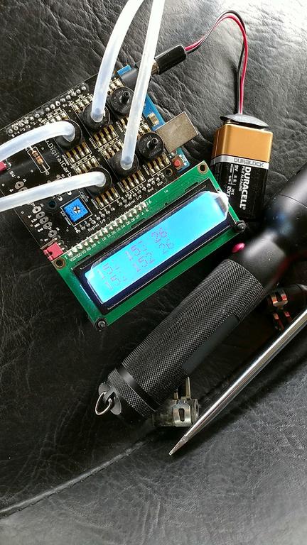

tz89 Posted April 29, 2018 Author Share #83 Posted April 29, 2018 (edited) My first sync on my 2009 RSTD using my DigitalCarbSync.com gadget. Photo a little jittery plus the protective layer is still on the lcd. I don't think it had ever been done before. Hoses were really stuck on and the sync was off by more than the equivalent of a half inch of mercury old school. Took it out for a ride and it is nice and tight - that little raggedy feeling is gone. Pulled this snippet from an old post by goose: Just for future reference, the shop manual specifies 280 mmHg at idle, and variation between carbs of no more than 10 mmHg or .4 inHg. Mine are now within 0.1 inHg of each other. In theory, the 152 reading implies 320 mmHg at idle but without a tach on to set the idle - and other minor variations due to test conditions (old 9v battery, temperature, altitude, atmospheric pressure, etc) - I would not bet on it. I would bet that the idle is higher than spec. That's something for my next version. I have the software built-in but it has never been adequately tested and developed. Edited May 1, 2018 by tz89 Link to comment Share on other sites More sharing options...

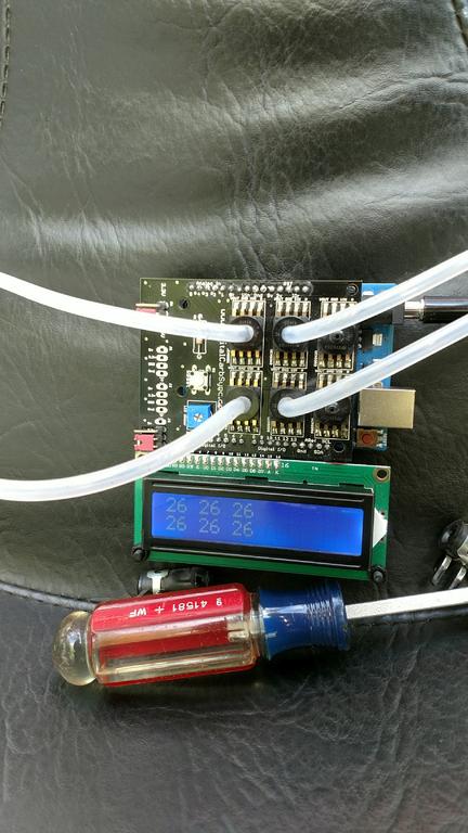

tz89 Posted May 6, 2018 Author Share #84 Posted May 6, 2018 Better pictures.... Link to comment Share on other sites More sharing options...

Patch Posted June 16, 2018 Share #94 Posted June 16, 2018 Of course you could use it on just about any vacuum sync. I guess I should have put the question this way: is the reading dampened or will (as the pic shows above) pulse say 25.3 .5...? Does it round up or down to the nearest full number? Link to comment Share on other sites More sharing options...
tz89 Posted June 16, 2018 Author Share #95 Posted June 16, 2018 (edited) is the reading dampened or will (as the pic shows above) pulse say 25.3 .5...? Does it round up or down to the nearest full number? Oh, gotcha. I'll give the long answer. The sensor reads vacuum from 0 to -115 kPa and returns a voltage of 0 to 5 volts (actually 5 to 0 volts). The board reads the voltage and converts that to an integer value of 0 to 1023. I keep an array of readings and extract the peak value. I display integer values to save display space, and because using something past the decimal point would suggest a false level of accuracy. I use a little math to change that range into something useful. By default, I use each point equals 1/10th-inch mercury. You can go into the software and change it to a different range. There are a few. One of my European customers asked for millibars for example. So - to answer your question - it is not rounded in the usual sense. It is smoothed by keeping an array of integers and extracting the peak. Hope that makes sense! Edited December 23, 2018 by tz89 Link to comment Share on other sites More sharing options...

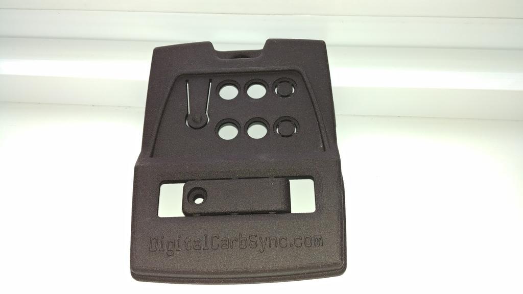

tz89 Posted December 23, 2018 Author Share #99 Posted December 23, 2018 (edited) The new 3-D printed case is coming along. Many thanks to Stephan in Quebec Province! Edited December 23, 2018 by tz89 Link to comment Share on other sites More sharing options...
