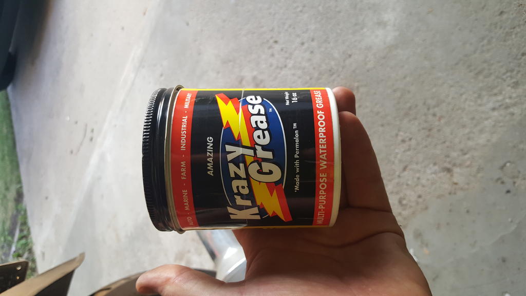

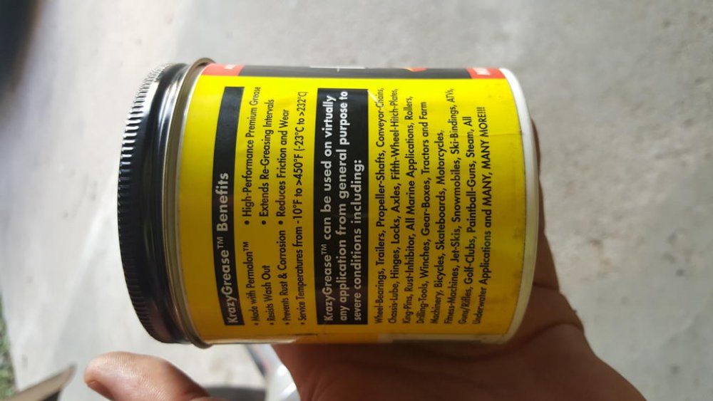

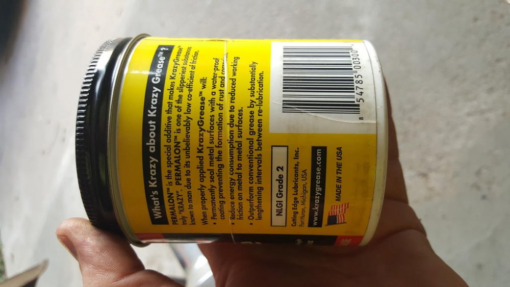

Had some salesman sell me this stuff. Said on the container that it's good to be used as fifth wheel grease and a whole bunch of other stuff. Was wondering if anybody has ever tried this on the rear splines or anywhere else? @cowpuc you mentioned in a previous thread that you've used just about everything on the market. Ever try this one? Got the stuff for cheap so I'm not too worried if it doesn't work. I got plenty of other stuff I can slather it on.
