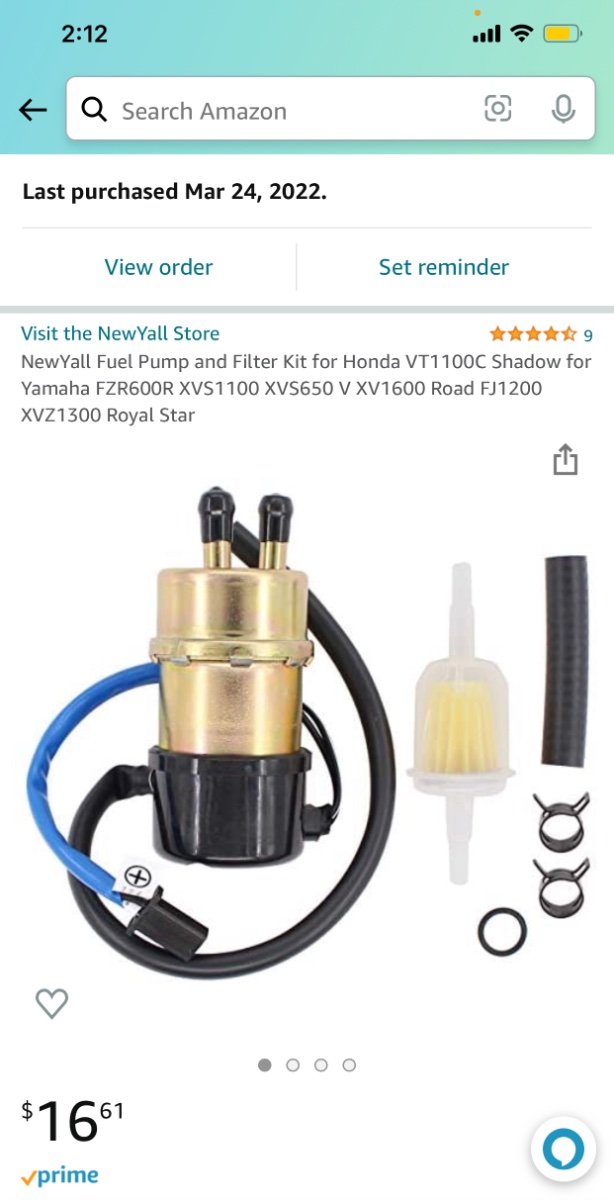

mike4dodge Posted March 29, 2022 Share #11 Posted March 29, 2022 On 11/29/2012 at 5:03 AM, GeorgiaYankee said: I'm having a hard time finding where I have some fuel seeping from after using the choke to start on cold mornings. I do have significant cracks in the rubber intake manifolds that I suspect my be letting the fuel weep through, and the leak is up high. Any thoughts? I thought I had fuel leaking because of sticky floats after doing all the seafoam treatment… Went to replace the fuel filter and found the fuel pump itself was leaking in the center and it was just running down the side of the hoses new fuel filter and fuel pump runs perfect no leaks Link to comment Share on other sites More sharing options...
