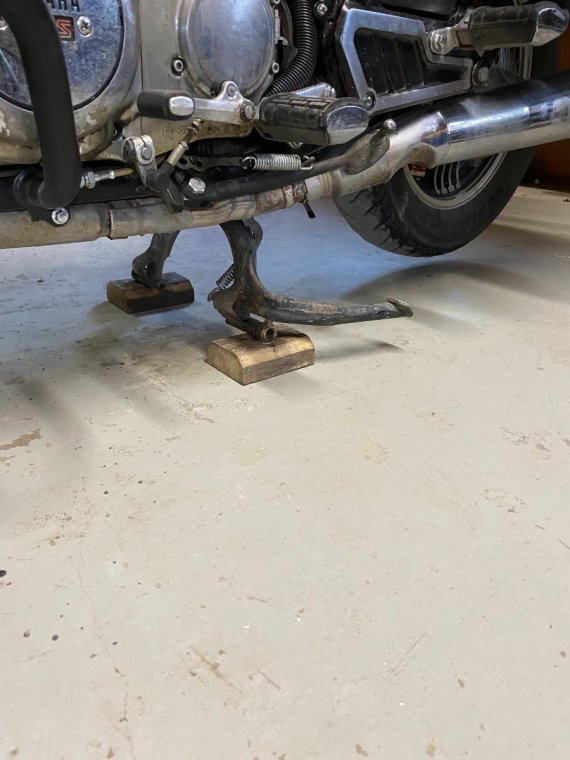

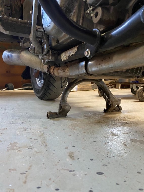

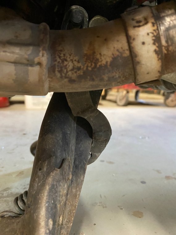

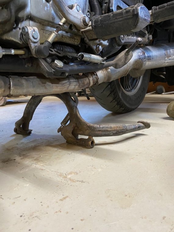

MoonShine Posted April 10, 2021 Share #28 Posted April 10, 2021 I cut around 2 inches off the bottom of the center stand and welded some cross tube on the feet to make a “ride off” stand. It is very easy to pop on the stand (even in flip- flops) and rear wheel is on the ground when on the stand. I carry 2 small chunks of 2x4 to tip the center stand on to lift the rear wheel off the ground or stabilize on soft ground. Link to comment Share on other sites More sharing options...
