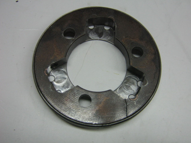

Snaggletooth Posted July 29, 2012 Share #68 Posted July 29, 2012 (edited) Not from another Yamaha for sure. Way beyond what they have offered. The first pic is the OEM enage clutch which has three, count them THREE roller type enage prangs that are held in place by three springs about the same size as those found in a clicky type ball point pen. Far from what you might call heavy duty. The body of it also comes with cracks when it fails creating that nasty chatter when it goes bad. The second pic is the old (left) and new (right) side by side. The third pic is the old style in the rotor. Note the THREE mounting bolts. The last pic is the new style mounted in the origianl OEM rotor. Note the rotor is machined by Dano to use the six bolt mounting. When Dano installs the new engage he aligns the clutch with the rotor dead center to make the fit spot on. The biggest improvement with the new systen is the 19 elipitical prangs with the SS spring behind them so they have a solid contact and slip free engagement every time. That's 16 more contact points than what you started with. The new system include the new 72 tooth ring gear that is different from the OEM gear also. I was the first one to have this done by Dano and have no regrets on the upgrade. Several years of flawless starting. But as I said, not your stock parts from Yammi. They wish! Mike Edited August 12, 2012 by Snaggletooth Link to comment Share on other sites More sharing options...
jasonm. Posted July 29, 2012 Share #69 Posted July 29, 2012 I am surprised it's not from another Yamaha. So it's a secret what engine this clutch comes from ... FYI, Before the first Venture was even made. The starter clutch was originally used on the '82 Vision and possibly a few other bikes. I have an '83 Vision. Yes, the starter clutches do fracture from loose bolts. Seems Yamaha forgot about Loctite back then. The starter clutches...I have 2 spares. That I origianlly got from spare Vision engines. One of which is new. The clutch, if not fractured or loose can bemade to work properly with just the 72 tooth gear, new rollers and springs.Which I did @60k and bolts not loose. That centering issue mentioned is not stated in the service manual. Something I will keep in mind. Link to comment Share on other sites More sharing options...
Jimmy-T Posted August 11, 2012 Share #70 Posted August 11, 2012 I attempted to fix the starter problem the "less expensive" (stock) way. So I ordered the parts from the list in the original post. I THEN tore the bike apart. I found the clutch was cracked. Now I need to order a clutch assembly which comes with the dowels, and springs, and caps already installed. The modified fix now seems to "less expensive". moral of the story? two fold: less expensive fix is not always immediately obvious, and tear it apart before you order parts/diagnose the problem. I am very appreciative of all the knowledge and advise offered up here and look forward to spending more time on this site now that I am a full fledged member Link to comment Share on other sites More sharing options...
