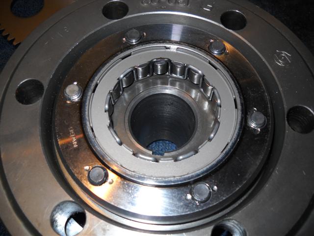

Dano Posted February 16, 2010 Author Share #30 Posted February 16, 2010 Snaggletooths rotor is done and on the way back to him, here are a few shots for those interested. You can see the plug used to center everything to the crankshaft in a couple of pics, this is one mod you'll never have to do again! Link to comment Share on other sites More sharing options...
Flyinfool Posted February 16, 2010 Share #31 Posted February 16, 2010 That sure looks stronger than the stock setup. Mine will be on the way shortly. Link to comment Share on other sites More sharing options...
Squidley Posted February 16, 2010 Share #32 Posted February 16, 2010 That looks real good Dano, nice work on making it happen Link to comment Share on other sites More sharing options...
Snaggletooth Posted February 16, 2010 Share #33 Posted February 16, 2010 Ohh yeeaaahhh.......Lookin' good! Come to Daddy! Squeeze........thanks for sharing this with us. And Dano.......what can I say? Nice job!!!! You guys better get awards for this one. Link to comment Share on other sites More sharing options...
Snaggletooth Posted February 18, 2010 Share #34 Posted February 18, 2010 Well Dano, it arrived today. Nice work my friend! Couldn't have hoped for an better job. You rock dude!!!!! Now to find time to install the thing. Later Mike Link to comment Share on other sites More sharing options...
