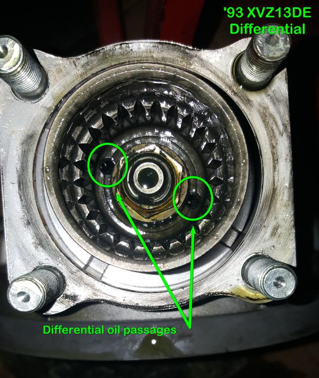

I'm trying to do my due diligence by reading through old threads in order to get the differential and driveshaft maintenance completed on my '93 Venture. Yet opinions across the years are all over the map on whether or not the differential end of the driveshaft is lubricated by the differential oil on '86 and newer bikes.
This thread seems to say "yes", and is backed up by Yamaha Bulletin M92-006 and Venture rear-end specialist John Furbur. Yet some '86 and newer bike owners say their splines on the differential end are as dry as can be: https://www.venturerider.org/forum/showthread.php?87852-Rear-tire-Final-Drive-and-Drive-Shaft
So which is it? Is the differential end of the driveshaft on '86 and newer bikes supposed to be lubricated by the differential oil? And if the splines are dry, does that mean something is malfunctioning, such as the oil lubrication passages being blocked inside the differential?

I removed the driveshaft from the differential on my '93 and was happy to see that it was nicely bathed in differential oil. When I tipped the differential upward, differential oil freely flowed through the two oil passages. I took it apart primarily to confirm it was A) getting oiled properly; and B) not gummed up with grease from PO maintenance. I had no grease gunking up the works, so I'll install a new oil seal, put it back together, and not worry about checking it in the future. Appreciate the help!
