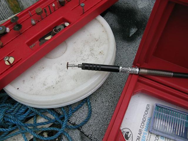

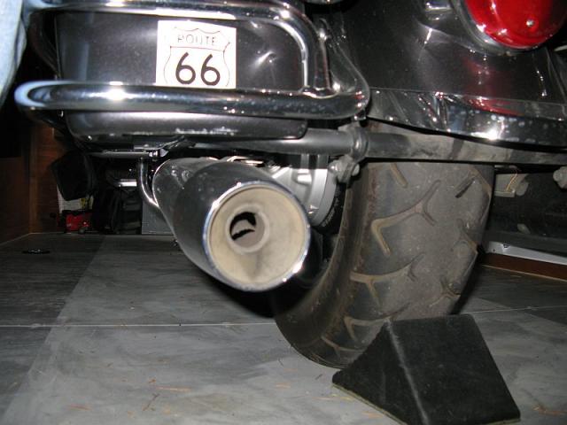

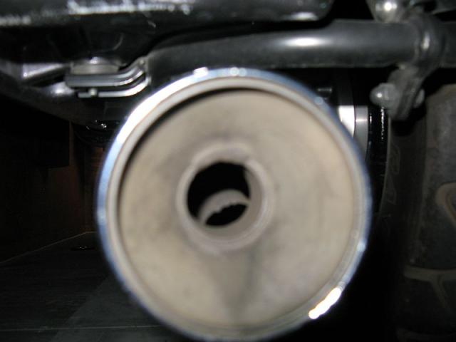

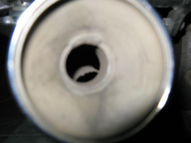

MikeWa Posted August 30, 2011 Share #67 Posted August 30, 2011 (edited) First I didn't invent this mod. but I sure do thank whoever did. I used my dremel tool adapter with a cutter bit. I ended up using about 20 of the cutter wheels. first pic. Reach into the pipe about 2 inches with the adapter and cut the double pipe. Then push the pipe down. See pics. That is all there is to it. A couple of notes. The pipe is double walled the first few inches. On my first muffler after cutting through the first wall of the pipe I took a chisel and pushed it back so cutting the second wall would be easier. While I was doing this the inner wall now a small sleeve suddenly released and slid all the way into the muffler. Not really a problem but It could rattle around later. On the second muffler I just cut through both walls and there was no issue. I am now using both mufflers and they sound great. If you decide to fore go this procedure and drill holes in the ends of the mufflers just remember there are two baffles you must drill through. If you only go through one you will get little to no improvement in sound. Mike Edited July 22, 2019 by Freebird Link to comment Share on other sites More sharing options...
elcorbs Posted September 1, 2011 Share #68 Posted September 1, 2011 Mike, thanks for the pictures and instructions. What you showed me and told me is not what I was about to do to my exhaust. Now if I decide to accomplish this it will be much easier with your instructions and pictures. I don't even own a dremel so would have to buy that first. I also see an extension which I would guess will allow me to get further into the exhaust to make the cut. Again, thank you. Elliott Link to comment Share on other sites More sharing options...
MikeWa Posted September 1, 2011 Share #69 Posted September 1, 2011 Elliott You are welcome. You only need to be about 1.5 inches into the exhaust. After that it is just preference. Mike Link to comment Share on other sites More sharing options...
