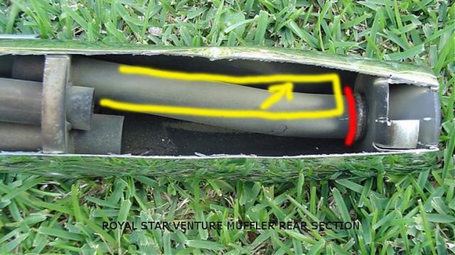

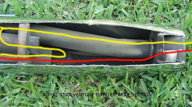

Seaking Posted May 10, 2010 Share #26 Posted May 10, 2010 (edited) A picture might be worth 1,000 words.. but is this correct on how you guys are modifying your pipes for a slightly louder 'throatier' sound? I'm not sure if this is the correct way but I included a photo that shows how I think this is supposed to be done? Is this correct? One photo shows in red where the pipe is cut from through the exhaust pipe to separate it from the rear cone, and the yellow basically shows how you move that cut pipe out of the way to 'open' it up? Is this how it's supposed to be done? Other photo shows the pre cut exhaust flow before the cut mod in yellow and the post cut mod in red, basically in a straight line.. Is this the correct way? (yeah I know, some of you guys shaking your head wondering why some aren't seeing it as clearly as you are but I received a few emails from others to shy to ask in public.. What do I have to lose asking for them as well lol.. nuttin.) Cheers Edited July 22, 2019 by Freebird Link to comment Share on other sites More sharing options...
gocubsgo2321 Posted May 10, 2010 Share #27 Posted May 10, 2010 Alright, maybe I'm stupid, but I can't figure out how to get to that pipe to cut it. I have the rear portion of the exhaust removed, but how do I get inside to cut that pipe? What am I missing, and what is going to be required to put the exhaust back together once I get that pipe removed? Link to comment Share on other sites More sharing options...
Seaking Posted May 10, 2010 Share #28 Posted May 10, 2010 Alright, maybe I'm stupid, but I can't figure out how to get to that pipe to cut it. I have the rear portion of the exhaust removed, but how do I get inside to cut that pipe? What am I missing, and what is going to be required to put the exhaust back together once I get that pipe removed? Ok so it wasn't JUST me then lol.. My take on the whole thing is that if you take a dremel or rotary tool and put a cutting disc on it, stick it in the exhaust pipe and start cutting the inside of the exhaust pipe proper, you can then force the inner part of the cut pipes aside so that now the exhaust flow will look more like the red line on the photo I previously provided.. (stick your finger inside the exhaust pipe as if to block the exhaust flow.. it's that pipe you have to cut and separate.) I haven't tried this one yet.. I'm waiting for another cheap / inexpensive set of RK pipes to become available before giving it a try.. Link to comment Share on other sites More sharing options...
ArticusMedicus Posted May 12, 2010 Share #29 Posted May 12, 2010 Bit the bullet today. I cut my stock RSV mufflers It took a whole two hours start to finish. It also took 20 little 1 inch Dremel cut off wheels. I was scared as hell! But I tell ya, it's day and night. I love the new sound. Link to comment Share on other sites More sharing options...
Seaking Posted May 12, 2010 Share #30 Posted May 12, 2010 Bit the bullet today. I cut my stock RSV mufflers It took a whole two hours start to finish. It also took 20 little 1 inch Dremel cut off wheels. I was scared as hell! But I tell ya, it's day and night. I love the new sound. So sweet.. so tell me, did the diagrams I did up sorta show the same way you did it then? Are the Road King pipes the same internals as the RSV? Link to comment Share on other sites More sharing options...

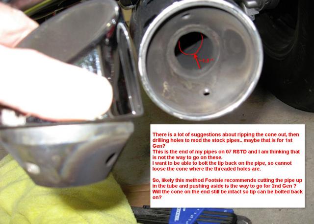

Globewalker Posted May 22, 2010 Share #39 Posted May 22, 2010 (edited) Hate to beat a dead horse .. no really... but just to clarify.. There is a lot of suggestions in several threads about ripping the cone out, then drilling holes to mod the stock pipes.. maybe that is for 1st Gen? This pic attached is the end of my pipes on 07 RSTD and I am thinking that is not the way to go on these. I want to be able to bolt the tip back on the pipe, so I cannot loose the cone where the threaded holes are. So, likely the method Footsie recommends cutting the pipe up in the tube and pushing aside is the way to go for 2nd Gen ? Will the cone on the end still be intact so tip can be bolted back on? Thanks! Edited July 22, 2019 by Freebird Link to comment Share on other sites More sharing options...
gibvel Posted May 22, 2010 Share #40 Posted May 22, 2010 I'm going to have to say yes. The cone is fixed to the end of the pipe. This is why the pipe will look normal even after you do the mod. Link to comment Share on other sites More sharing options...
